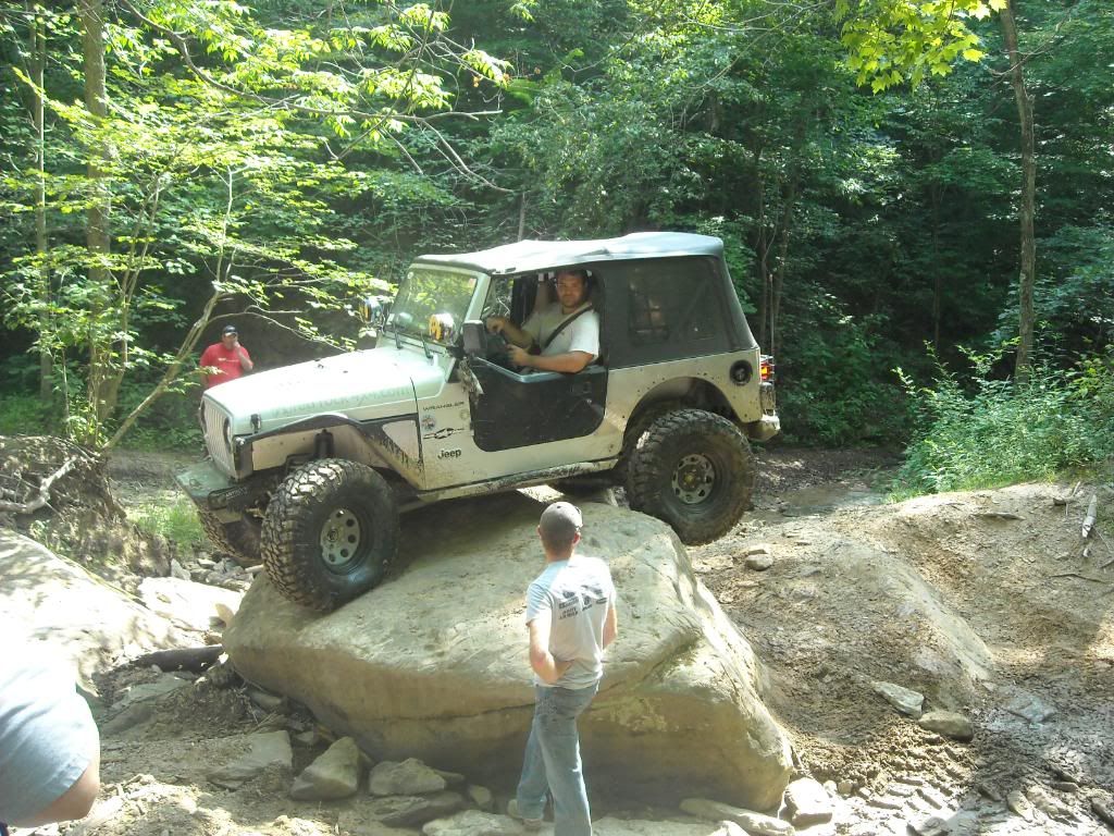

A few pictures that ALMOST do that rock justice...
Don't take this the wrong way bud....but
You make the TJ look small you big mofo! Seriously though, Jeep looks good and the wheeling pics were sweet.
