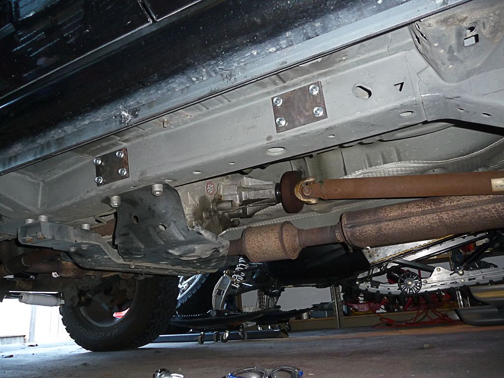

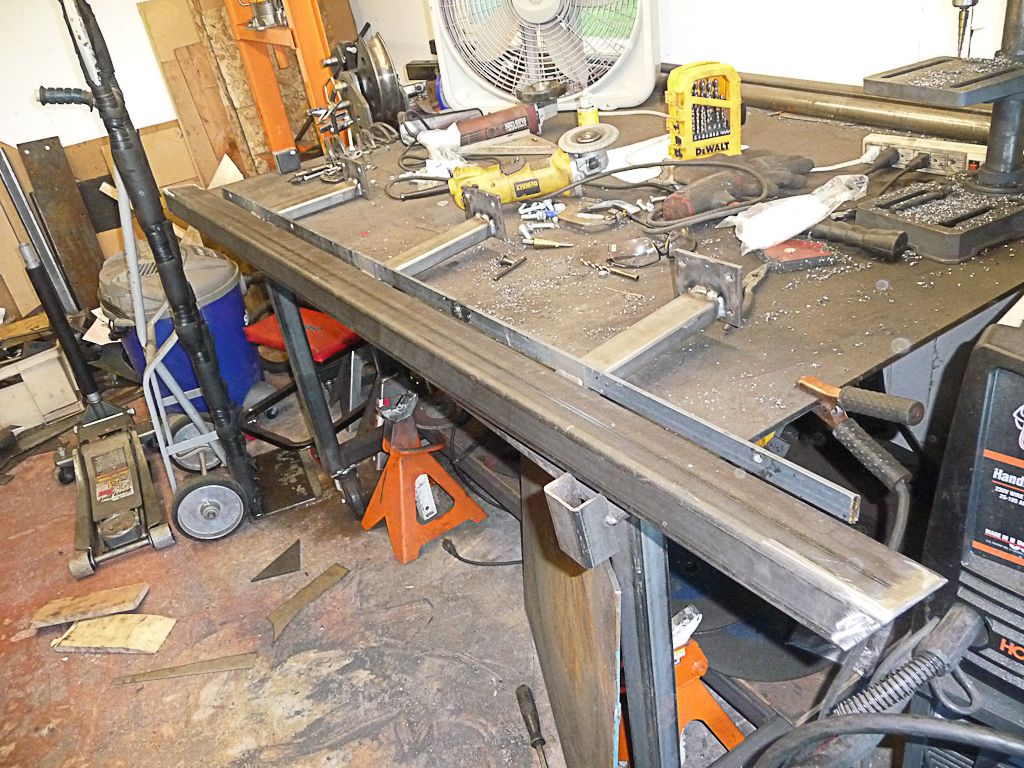

I finished fabbing up my sliders today. Here's what I came up with.
Took 3 pieces of 3X4" 1/4" flat bar and bolted it to the frame with thread forming bolts. Then I bolted some 1X 1/4" flat bar to the pinch weld.
Like so. (basically a rip off of the JCR sliders except I used 3 legs instead of 2)
I used 3X4" 3/16" wall rectangle tube for the sliders and 1X2" 1/8" rectangle tube for the legs.
Ended up like so
I'll paint them up tomorrow.
