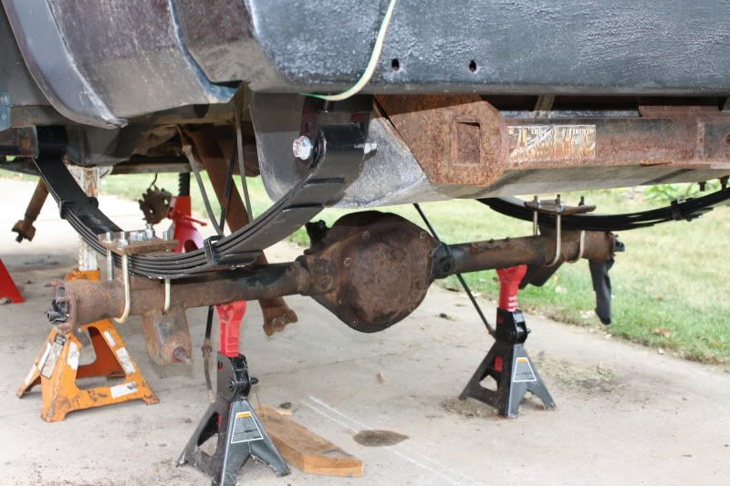

Well I got some stuff done on Friday thanks to Jeepcomj for helping.
Got the Durango Steering box in (bad pic, o well haha):
Got the JCR stage 4 front bumper in after messing with the mounting hole location:
Also got the 8.25 out and the D44 up. Still need to put the shafts back in, run brake lines and put on the Solid cover. Rough Country sent me bad U-Bolts. They said they had a bad batch come through. O well, they always take care of things so the new ones are already on their way. I was going to take a picture of why they were bad, but my camera didn't want to sooo:

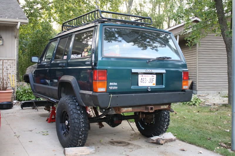

here are the pictures of the rear on wheels. Solid diff. cover is on. Rear disk brakes are on. A good set of U-Bolts finally and the rear is good to go. just need to install shocks and run the rear brake lines.

post #95 of 275 Old 09-10-2010, 07:39 AM
T4STE
Join Date: Oct 2005
Location: West Paterson
Posts: 1,055
looks awesome. i mightve missed it but what rear disc set up are you running on that 44?
16 WK2 75th Anniversary-Lucille the Albino Rhino
96 XJ Sport-Rosemary the Perrywinkle People Eater
T4STE is offline
post #96 of 275 Old 09-10-2010, 07:43 AM Thread Starter
jakeWI
Location: Wisconsin
Posts: 654
thanks. its a mix of ZJ d35 parts and TJ Rubicon D44 parts.
wi4x4.com
naxja.org
Jeep Build
jakeWI is offline
post #97 of 275 Old 09-10-2010, 11:56 AM
T4STE
Join Date: Oct 2005
Posts: 1,055
cool thanks. was it a tough install? you didnt have to replace the prop valve or the master cylinders did you?
T4STE is offline
post #98 of 275 Old 09-13-2010, 06:08 PM
jakeleverett
Location: san diego
Posts: 110
Hey I noticed a "sound bar" in the rear of your xj, is that something you made or is there someplace I could get one?
jakeleverett is offline
post #99 of 275 Old 09-13-2010, 07:51 PM
Geister
Location: Illinois
Posts: 212
Man your xj looks great. where did you find the fabric for your headliner?
"If you don't fear death, then death will fear you"--Whitt
Geister is offline
post #100 of 275 Old 09-13-2010, 11:06 PM Thread Starter
jakeWI
Location: Wisconsin
Posts: 654
Sorry guys, I was away for the weekend camping. Ill answer in order haha.
(1) wasn't to tough to install, did have help from someone knowing what they were doing though. didn't have to replace anything on mine other then the prop valve (went with one from a zj) otherwise everything else on mine was good. I am NOT installing the parking brake though. I have all the cables/lines ran for it still, its just not happening for at least a while.
(2) the sound bar is one that came in some models or various years of XJ's. My 1993 didn't come with one, my 1996 sport (this one) came with one from factory. So best bet is a junk yard.
(3) Thanks! I just used fabric from JoAnn fabrics. You basically can use anything you want. Walmart, army surplus, JoAnn anywhere that sells fabric. It took (without an overhead consule) roughly 3 to 3 1/2 yards of fabric. If you decide to do it, just buy 3M Headliner Glue! 3M is the company that makes it. Its expensive but it works! Be generous with it as well. I let mine dry overnight off the jeep just because. my brothers has been in for 3-4 years and mine has been in for 1-2 years and neither of ours is sagging so 3M works if you do it right. If you decide to do it and need pointers, just shoot me a PM, I would be more then happy to give any help I can.
