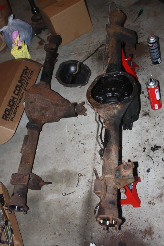

We got the brakes off both of my XJ D44's. Looked over the 4.88 axle a little bit. Its actually not as rusty inside as I thought it might be, just on the top side that was exposed. We got the axle shafts out in preparing it for the new 4.56 gears and Aussie locker going in starting this monday night!!!!!
Also started tearing into the jeep some more. Everything is almost off. Just need to get the front control arms off. Pat had to go to work which was a good ending point because I didn't have a big enough socket for the Rough Country control arms.

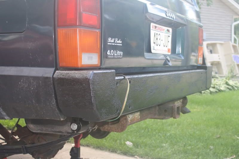

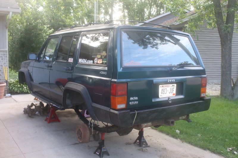

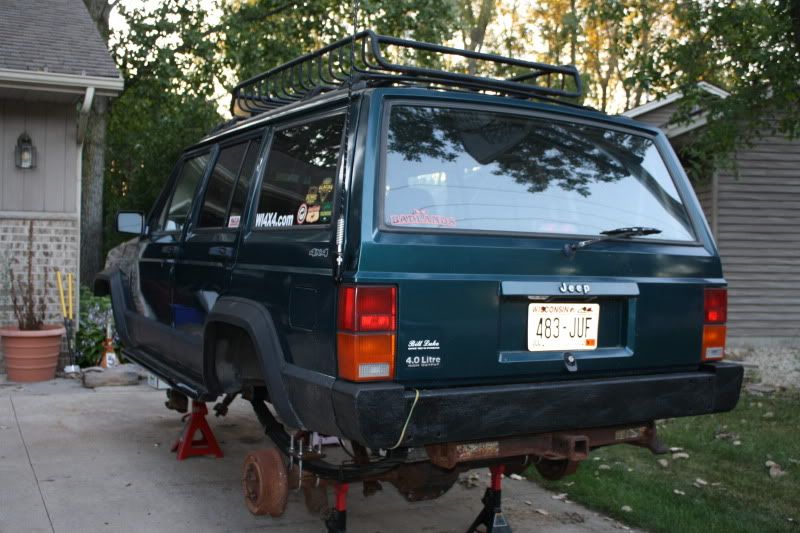

well finally fought the humidity and the mosquitos and got my new rear bumper installed. It is a C4x4 rear bumper and it looks great. Getting the old bumper off was kind of a pain with the hitch in the way. Then installing the new one, I had to employ two garbage cans as saw horses because I couldn't hold the bumper in place while bolting it down haha. It there!
Picture for stock look:
New C4x4 bumper (thanks OverlandXJ!):
Sorry for the blurry pics. The humidity fogged the camera up when I brought it outside

Finally, third time is a charm!
Finally got the D44 4.56 gears installed and the Aussie Locker. Thanks to Wade and his dad for being patient and helping out.
Still need to paint axle, re-install the axle shafts and disc brakes. Run some brake lines. Then put on the Solid Cover I have for it and bolt it into the jeep.

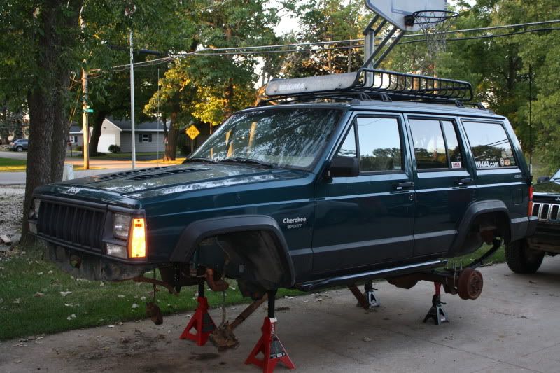

well got some stuff done tonight. didnt go as good as I wanted. Jeepcomj came over to help out.
we started to get the front bumper on as well as the Durango steering box all in one go. well got everything all good to go to find out the Unibody Tie In Brackets are junk. only three of the 6 holes would line up on either of the two. I dont know what happened with that batch. I am going to give them a call tomorrow and hopefully they take care of me or im going to be a little pissed off. so we put that on the back burner which sucks cuz I wanted to wrap that up.
We did get a surprise put onto my roof rails though
We also ran my cb cable all the way up so now i just have to plug it all in. Nice and hidden.
Then just to complete more, we got the new trac bar bracket on to make progress.
Ill post pics tomorrow and hopefully have more to show and tell.
