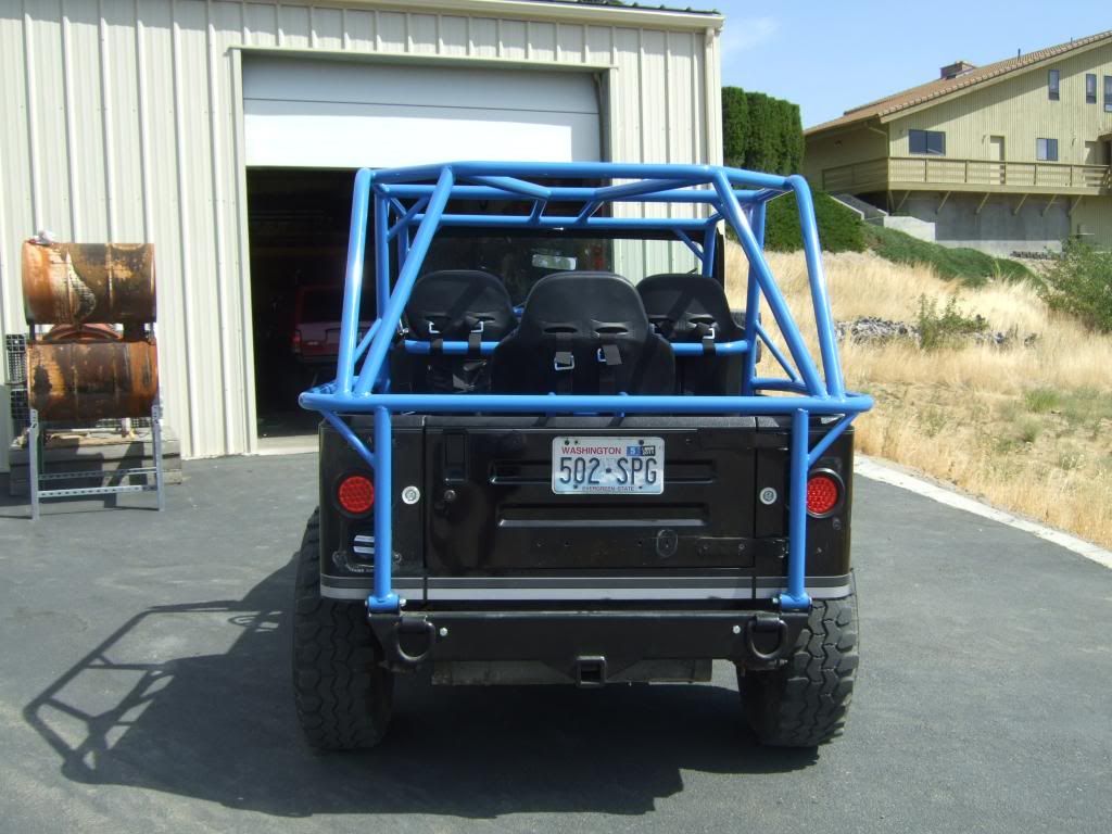

Phase 1 complete
Custom cage, genright LED's

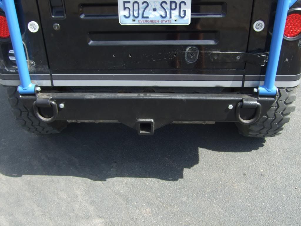

Finished the rear bumper

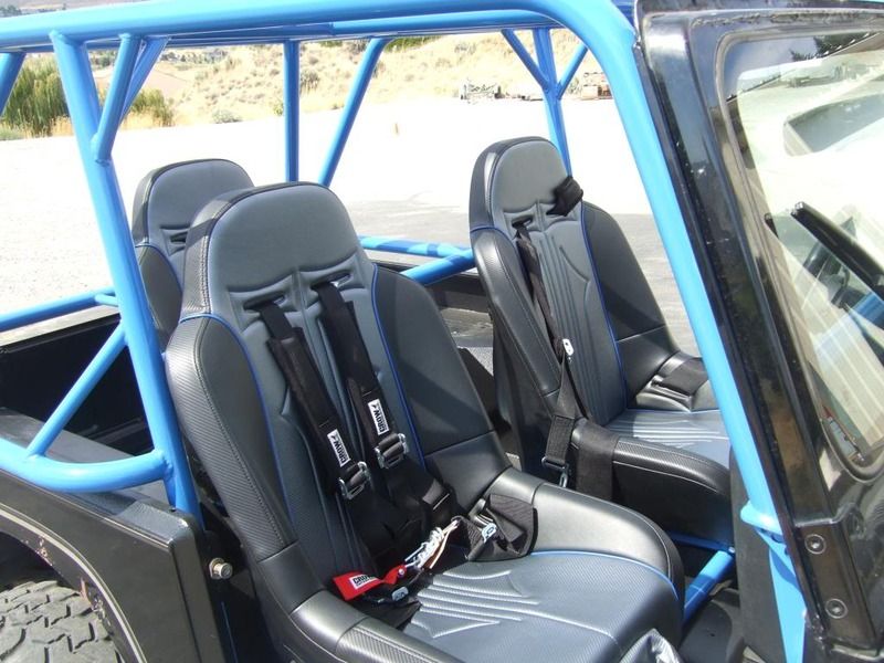

Heated Twisted Stitch seats with crow 4 points

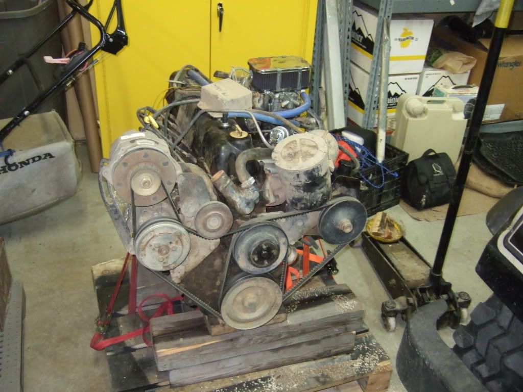

Crate 350 going in

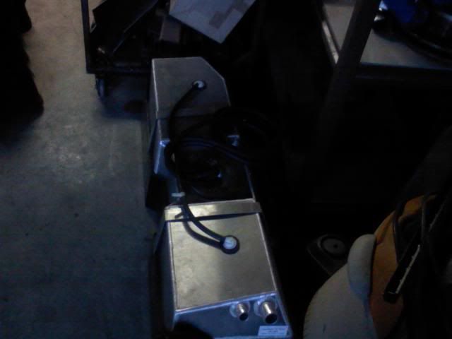

Genright 15 gallon fuel cell yet to go in
