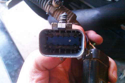

Here are the connectors in question...
They are at the end of the wiring harness opposite the computer connector, and each has 10 pins. On the Ram truck I pulled the harness from they were plugged in right before the bulk head. I found them in the FSM, but it doesn't list the functions for the pins, just the circuit number. I have all the wires on the original YJ harness labeled, now I just have to figure out what the functions of the wires in these connectors are.

Spent the day tagging all the wires in those connectors. Used a combination of the FSM and physically tracing the wires back to their origin. I think that part is finally done!
Also started trying to sort out the wires in the jeep, what a mess! My 92 FSM doesn't have the nice connector pin out section like the 95 one does. I'm literally clueless as to what to do next... it's getting really frustrating! I'm not sure what to do at this point. :
