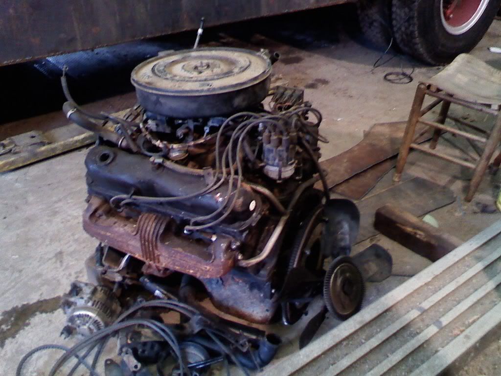

How does the computer know that the EGR is working. Is it based on a coil or is there a air flow switch measuring the gass flow. If it is just looking for a coil then you should be able to add one in but not hook it up. On mine the I have 3 coils mounted on the back of the motor that when energized supply vaccume to the actual valves that open and close. I left the coils hooked up to the computer, but removed the vaccume lines that run the egr and hooked all the coil outputs together. That way they energize when the computer tells them to, but they effectively don't do anything. The computer is non the wiser, and it keeps the check engine lite off. This not a very good pic, but it is the only one I have that shows the valves. If you look behind the distributor you can see the top of the valves that control all of the emisions equipment.

There is an egr switch that has a harness connector plugged into it. I'm thinking about leaving the switch mounted and plugged in just to see if the ecm will think everything is cool.

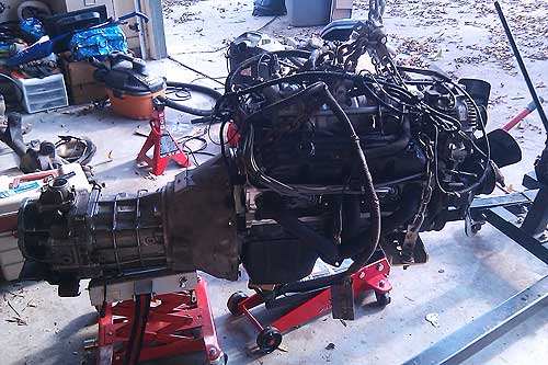

Ok a little update... Finally got moved into my new place and settled in. This weekend I joined the motor to the AX-15 and it all bolted up like it was made to be together. Took a little maneuvering to get the input shaft in the pilot bearing, but overall it went really well.
Next step is wiring, OMG this is a daunting task! I started going through the YJ harness trying to pare out the unneeded wires. I have a FSM for it, so it's going ok so far. I also have a FSM for a 95 Ram 5.9, but it doesn't show the pin outs for the three connectors that are at the end of the computer harness. I mean it shows them, but just shows a circuit number for pin 1, etc. So what do I do now? Anyone know the actual pin outs for those three connectors? One is black, one is gray, and one is light gray.
