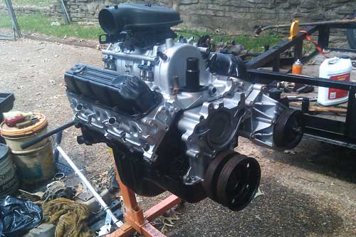

Here's a picture of the motor I took when I was putting it together. It's much more complete now with all the plug wires, accessories, and wiring harness on it.

Posts: 2,724
Hey man it's looking awesome! Cant want to see it all done and on the road! That fuel rail looks familiar
