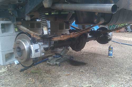

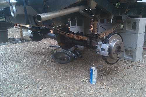

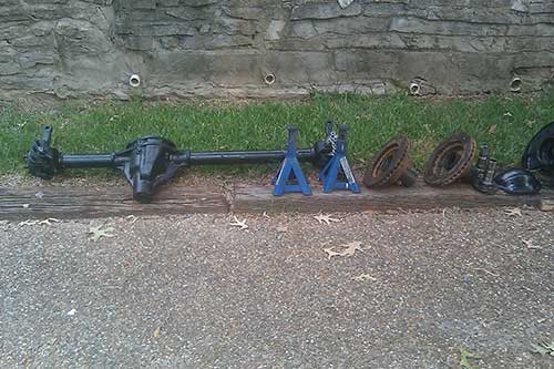

Labor day weekend gave me a little more time to get back to work on the jeep...
8.8 is geared and underneath, not welded in yet.
D44 waiting patiently for gears...

I cringe when I see cinder blocks laid onto their sides. They're strongest when the blocks are set upright. I do see a 2X4 set atop of them, but I wouldn't use less than a 2X8 to better distribute the load. Call me . Sorry, just my .
Great job on the Jeep though! Kudos to your build.
I wasn't real sure how to set them up. I tried them upright, but it seemed to be a little tipsy. I felt more comfortable with them on their side, plus there's not much weight there since I have no drivetrain in it. Once I get the axles underneath I'm going to ditch the blocks.

Update... no new pics, but got the D44 geared and aussie locker installed this weekend. Got a really nice pattern on the gears and perfect backlash! Just need to get the hubs ready now and get it under the jeep.

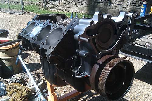

Got the short block built...
Gonna try to finish the top end by the end of this weekend.

You didnt paint the gasket surface where the head sits did you!?!?!?!?!?

post #55 of 441 Old 09-16-2010, 02:10 PM Thread Starter
bmgadg
Location: Mississippi
Posts: 468
Lol no it's probly just shadows in the picture. No way I'd paint a machined surface!

post #56 of 441 Old 09-16-2010, 02:26 PM
PlatinumNiner
Location: Long Island NY
Posts: 2,724
LOL ok just making sure. phew lol in the picture it looks like you did.

post #57 of 441 Old 09-17-2010, 01:41 AM
MoparFreak69
Location: Boise
Posts: 1,279
Even if he did paint it, a little scotch brite will take it right off and no harm will have been done. If I paint an unassembled engine I dont care about overspray, it will come off easy enough and its easier than prep work in my opinion. I usually try to paint an engine assembled though, makes it much easier.
