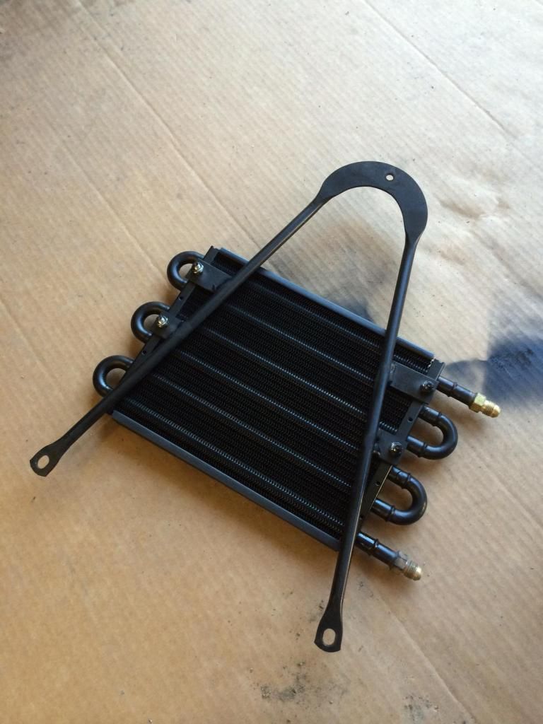

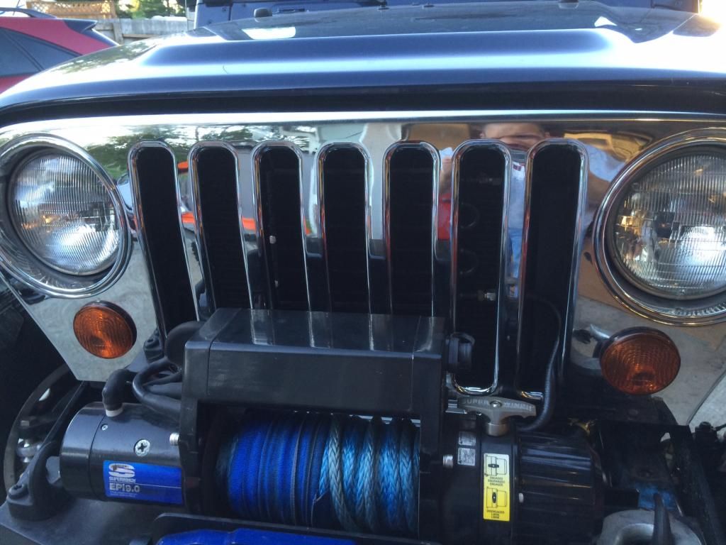

My P/S cooler came yesterday so I decided to tackle that job. I'm not sure who designed the rubber "nuts" that hold the condenser to the grill, but I have some words for him. What a Mickey Mouse setup that is.
Welded up some tabs to the brace and bolted it down.
It's hard to see, but it is hiding behind all that chrome.
I also changed the O-ring to a Viton one I found at O'rileys. It was a Doorman part for fuel line. Viton is good for higher heat, and it's a stiffer seal so I think it will be better. The O ring that keeps blowing does see 4.5 GPM at 1600 PSI so it does need to handle some stress.
Got to work and the cooler was barely warm. Going on a poker run this Saturday, so I'll see how it does.

Viton is a good material choice for that oring. I'm interested to see if the durability changes. I'm assuming you were running Buna before?
I'm not sure what the one that came with the box is made out of. From what I read, the Viton is rated to 100 degrees more than the Buna O ring. I hope it will hold up, but it's not very scientific since I added much more cooling to the system.

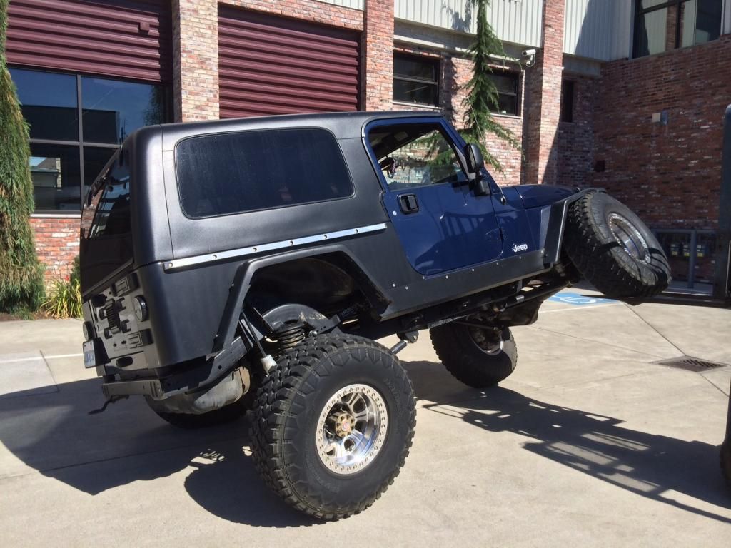

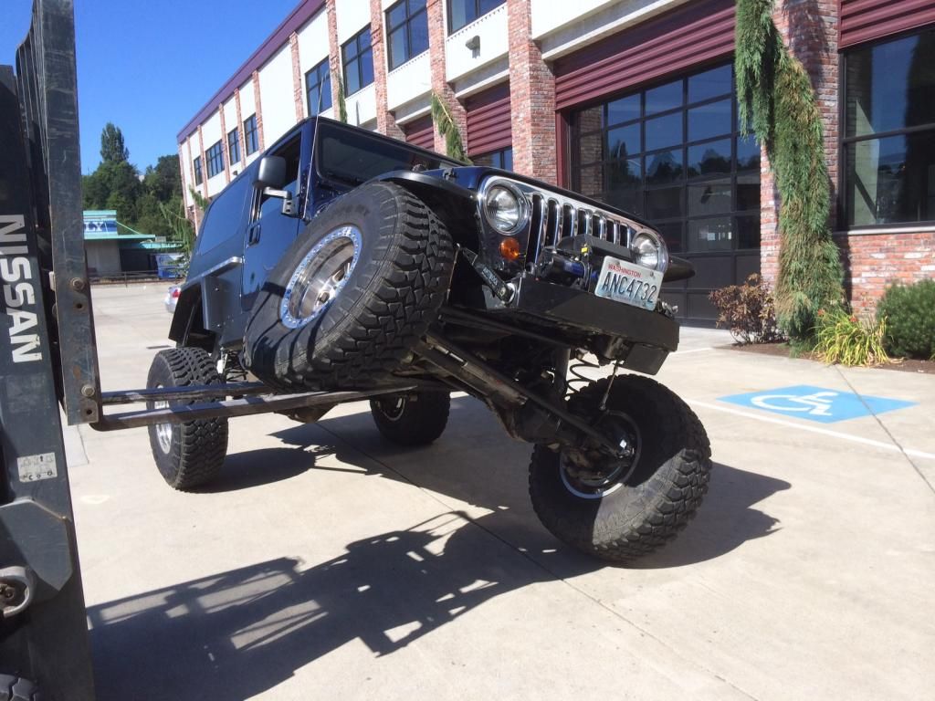

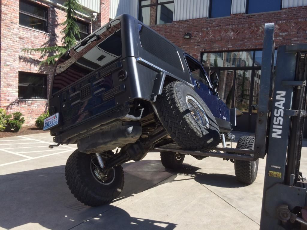

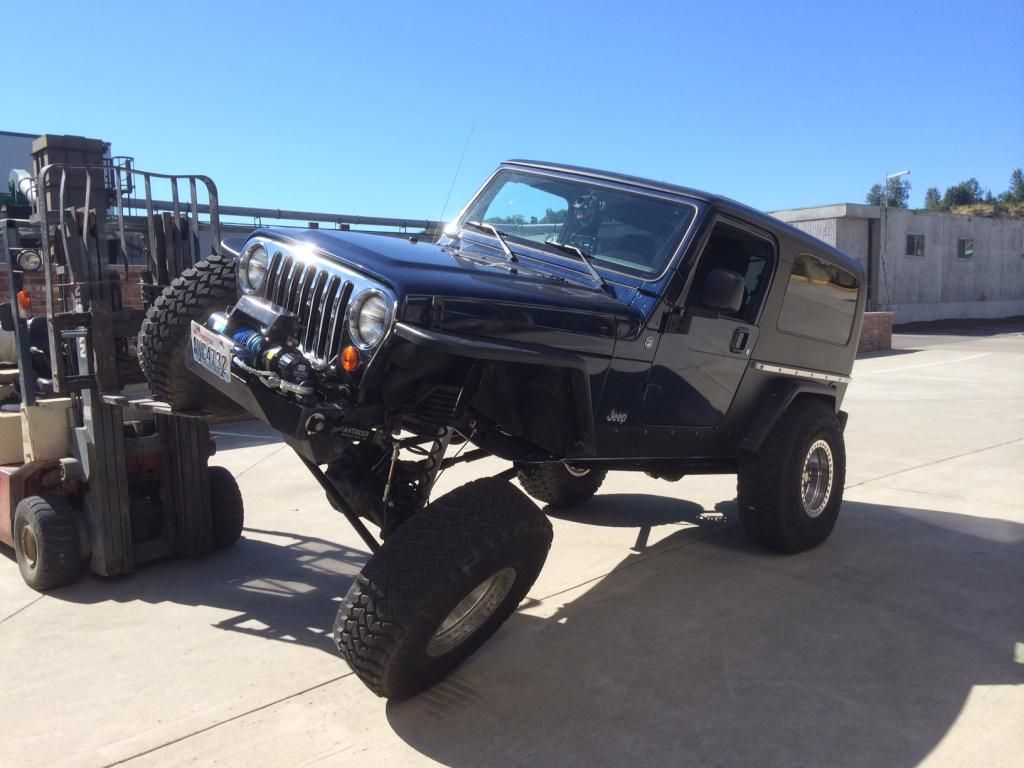

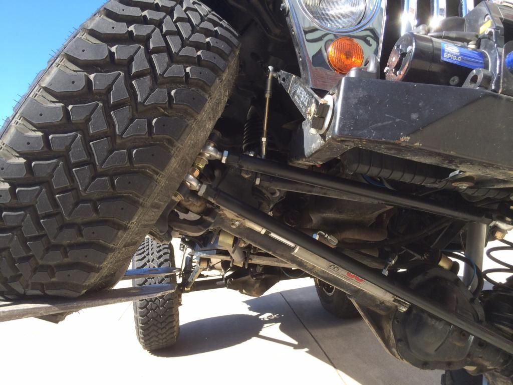

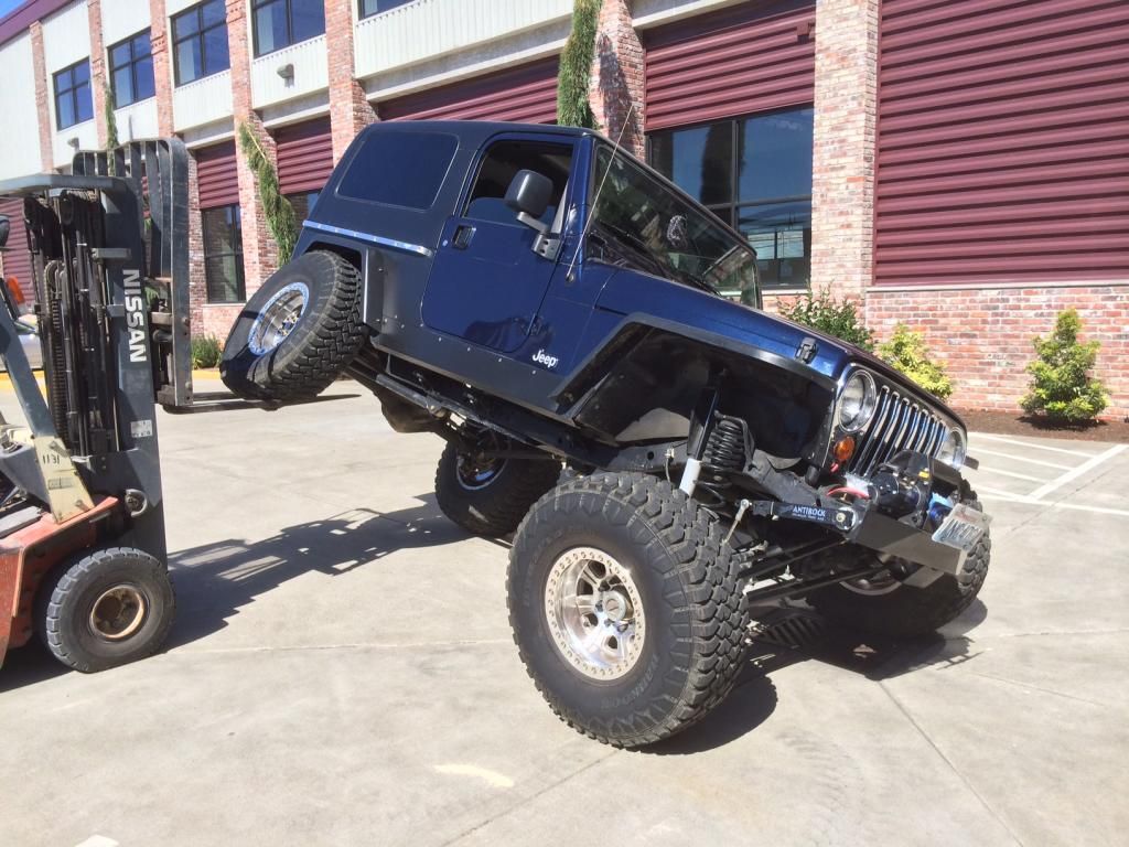

Put the forklift at work to work. It's hard to fully articulate an axle in a small garage with the tires on, plus when the weight of the vehicle is deflecting the joints, funny things can happen. It appears as though I either need more bump stop in the front, or rethink my fenders (high line).

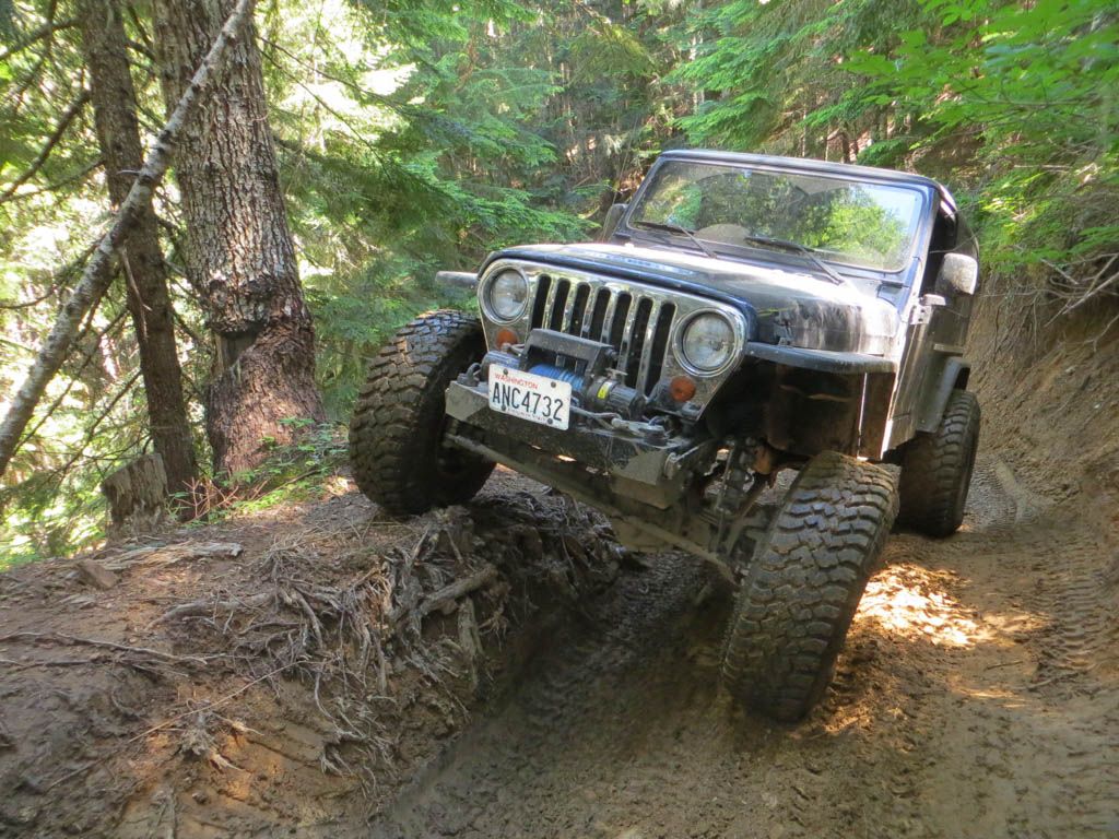

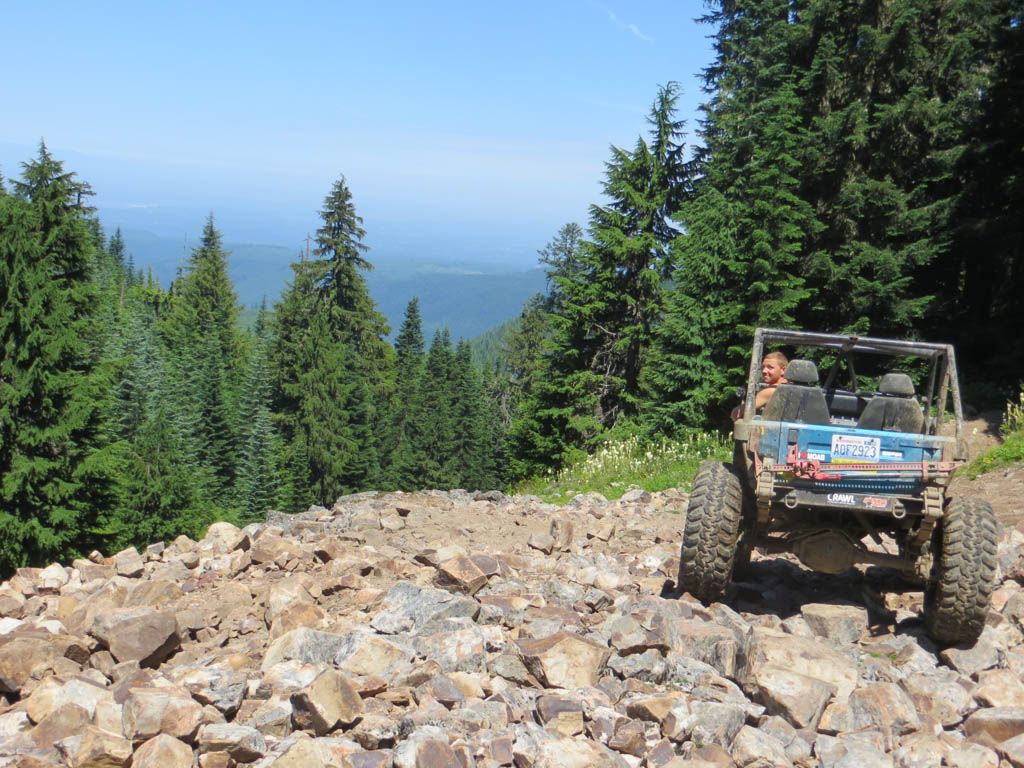

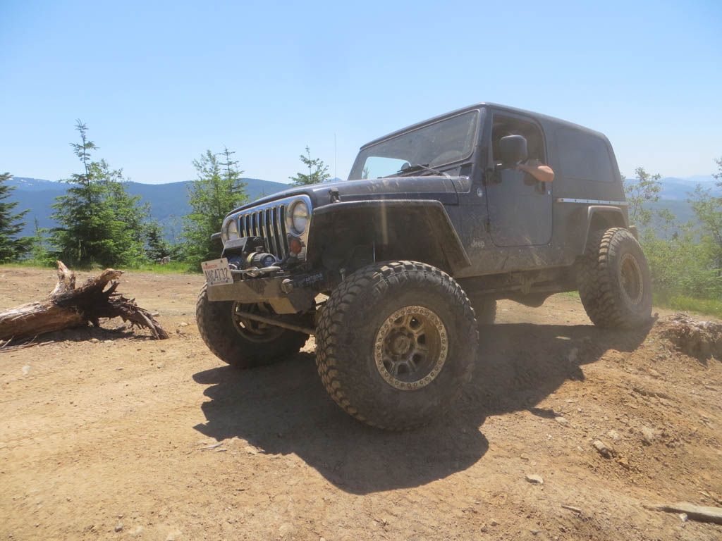

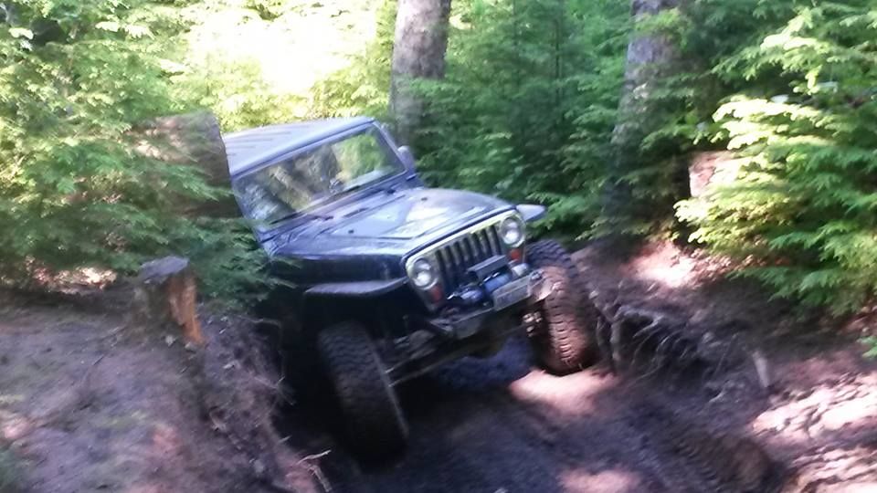

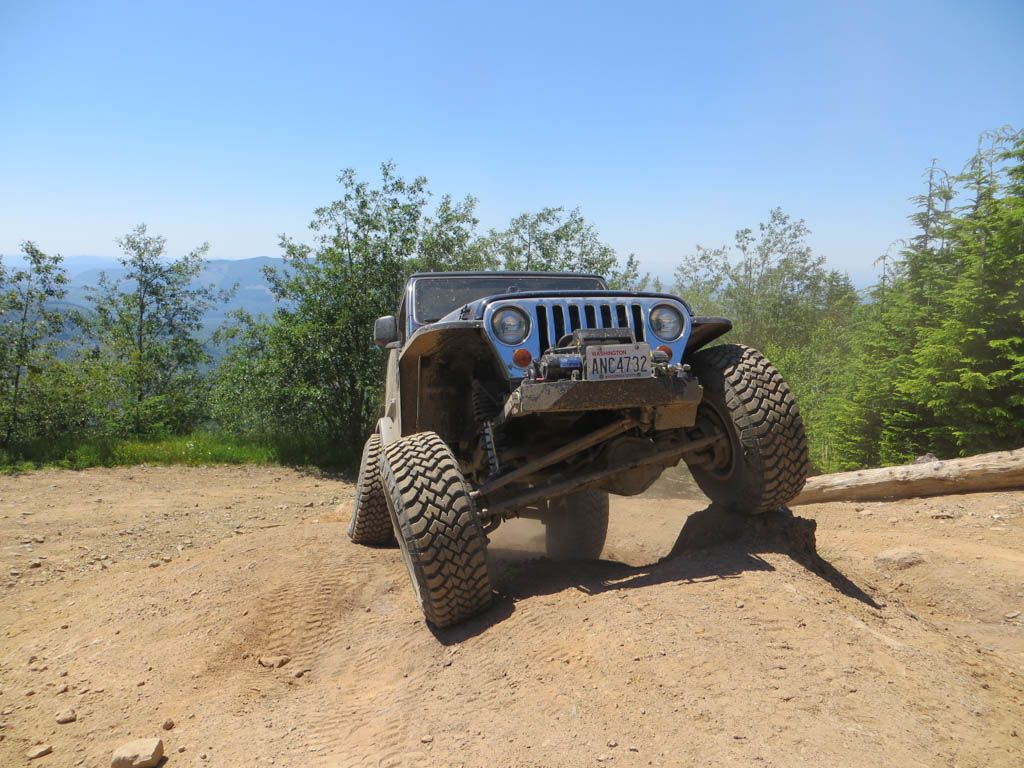

Took the Jeep out on a poker run this weekend. 0 problems this time and the O ring seemed to hold together. Even after lots of steering work in the tight trails the coolers weren't too hot to touch so the increased capacity must be doing some good.
Here's some pictures.
