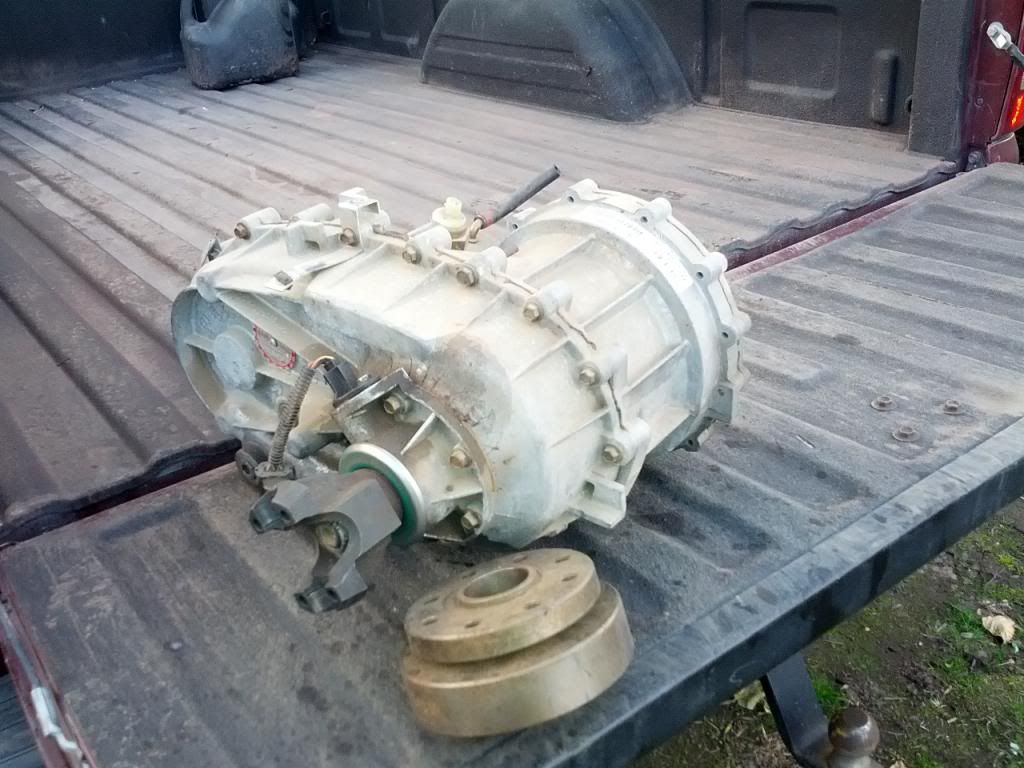

I did make my first purchase for the project though, and as everyone knows, one part can dictate the direction of a lot of other parts.
Picked it up for $500. Only 42K on it and comes with both a 1330 yoke and the standard rubicon yoke. This is the cheapest I've ever seen one so I had to grab it. With that said, the 5.3 swap is going on the back burner and most likely part of a 2.0 build unless I start hating the 6 speed.
