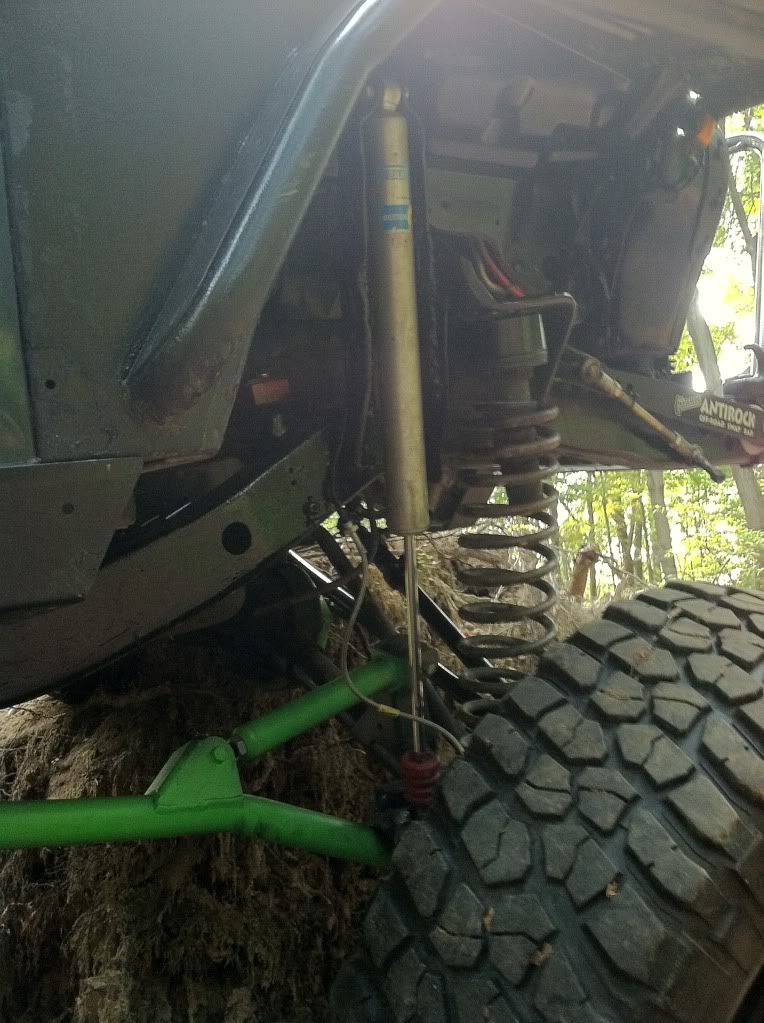

I'd like to see more of this front shock setup. Shouldn't the 2.5" RC's unseat with a 12" shock?

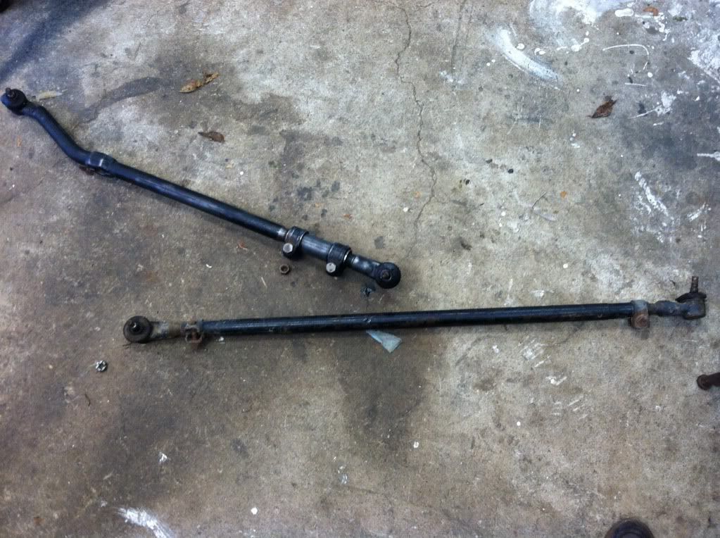

Thanks man. theyre not 12" shocks theyre 14" hahah.

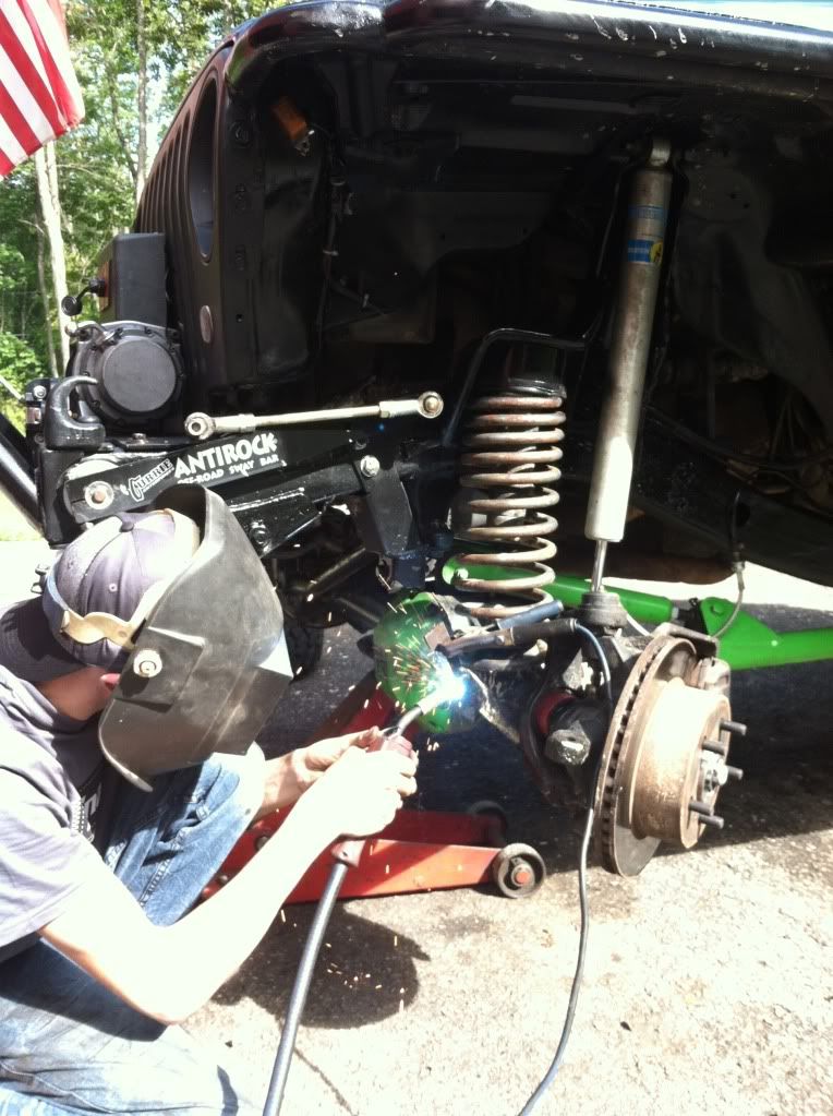

Took the steering apart and cleaned up everything.
Welded in new tabs for my sway bars, tie rod flip would have hit.
Bad pic but here is it all done and together

Yea I know. That's why I said I thought the 2.5 would unseat with a 12 and definitely a 14. Did you just move your mounts and bump for the shock and spring to cooperate?

Im not sure, im guessing theyll unseat. I know theyre longer then a 4" coil though

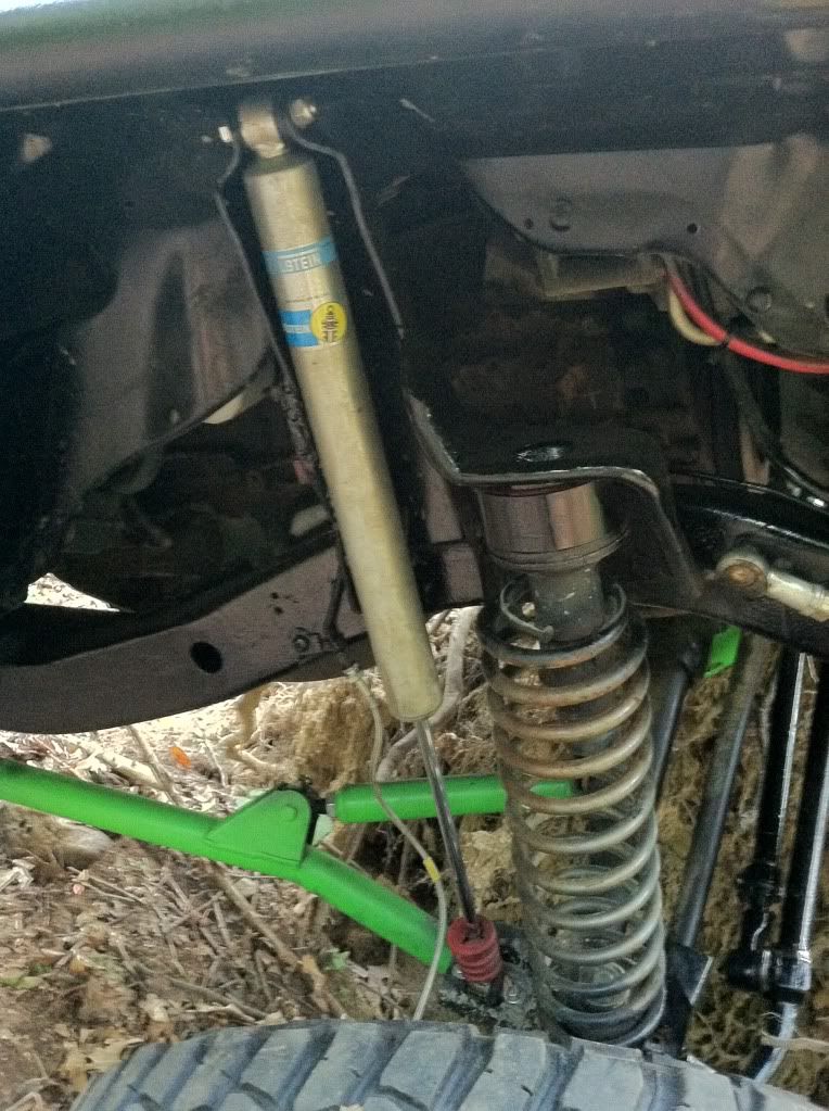

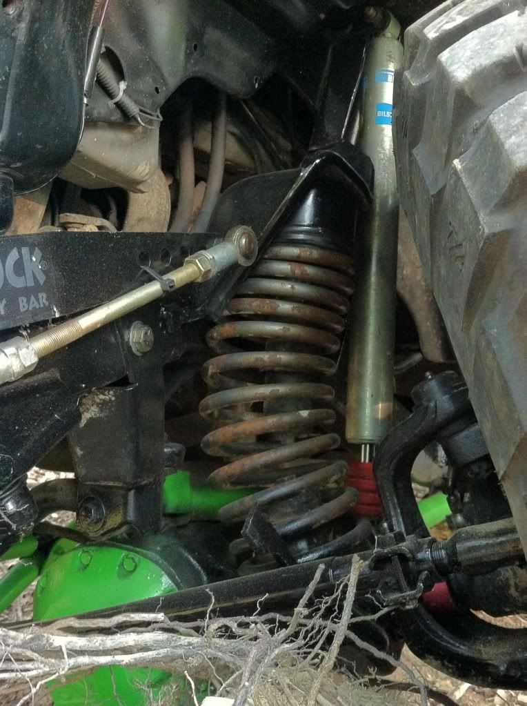

Love the currie steering..no steering stabilizer either.
Flexing(still not full flex)
Flexing.
*yes my coil is unseating, yes I understand thats very bad, yes im going to fix it, yes I did measurements and will be making limiting straps.

Not bad. Are your front shock mounts just F250 towers cut and welded on the stock mount?
-Jack
BamaJeepman21 is offline
post #732 of 739 Old 09-12-2013, 09:27 PM Thread Starter
Drastiq
Location: Stillwater
Posts: 1,381
yup haha, it took less than an hour to cut the brackets and weld in the new ones.
