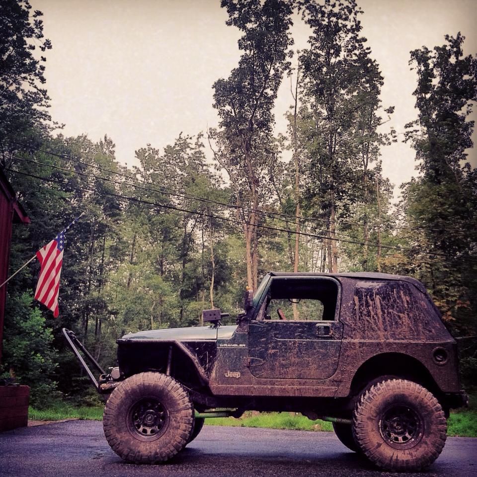

Poison spyder tramp stamp, new GTS.

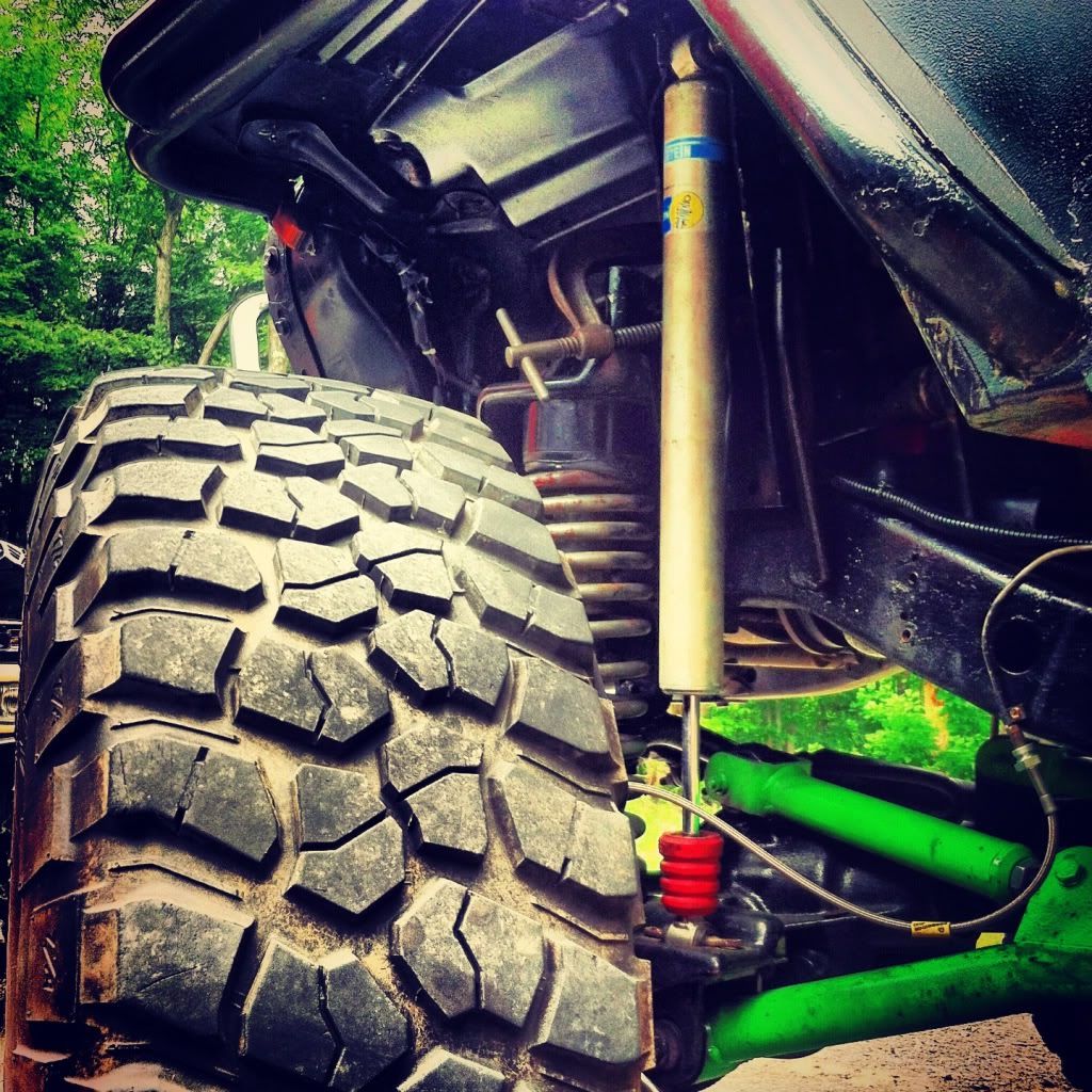

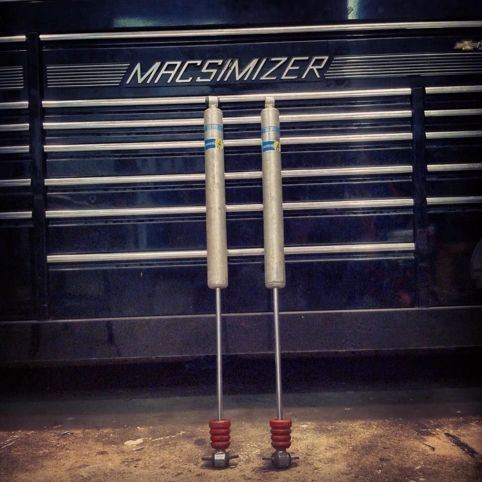

I have been working so much I havent had much time lately to get on here. I bought a set of 5125 bilsteins off a friend. They are 14" travel front and 12" travel rear. They came with daystar EVS bumpstops(no longer available), ill be outboarding my shocks next week(ish) depending on when my ford shock towers come. I also cut off my exhaust(behind the cat) because it was hitting my flat belly skid as well as my long arms..so ill be buying a high flow cat(maybe) and a flowmaster super10 single chamber muffler. I cant stand the loud obnoxious sound currently, I know the super10 will be almost as loud but hopefully alot better than this haha.

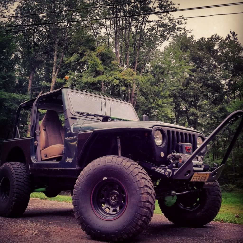

Looks good without fenders

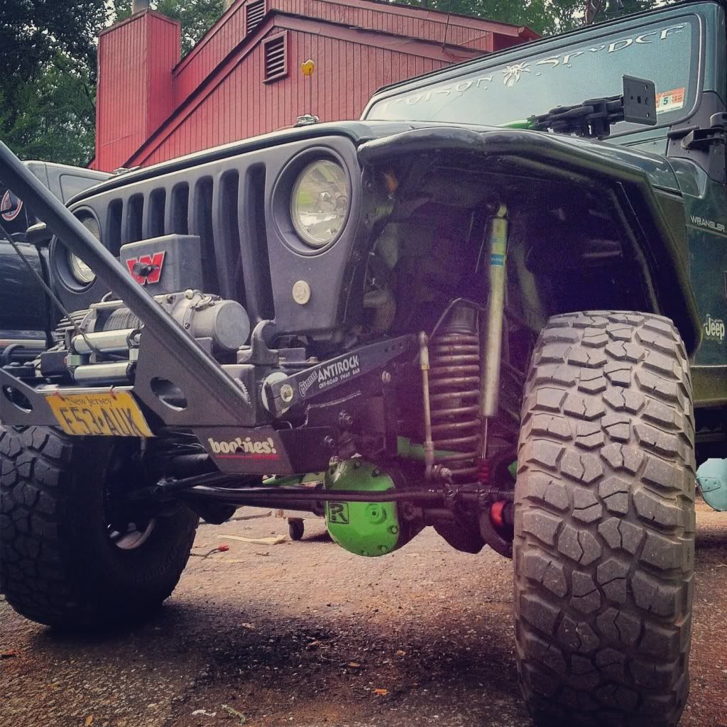

Finished the front outboarding today, wasnt very hard.
I ended up getting almost 7" up and about 7" down travel. 14"travel shocks

Have you flexed it out to see if the coil unseats badly?? Honestly that shock has to be a little long man.... I was interested to see how you handled the transmission mount to the Barnes skid plate also.
I havent fully flexed it out yet, but I got them for 100$ so I cant complain haha. The trans mount sits perfect, I have about 2" til my tcase hits my tub(thats with the dumb 3/4" rough country long arm bracket)

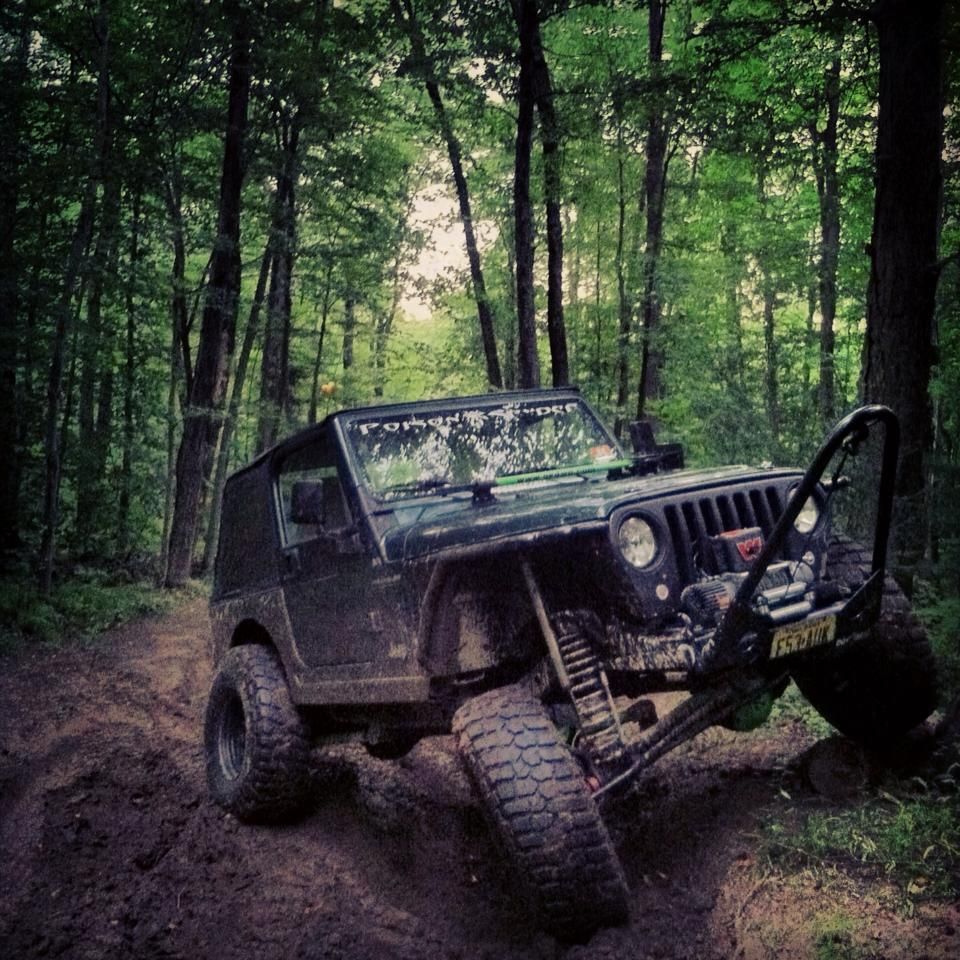

Kinda flexin, not really tho...
