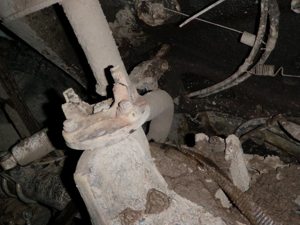

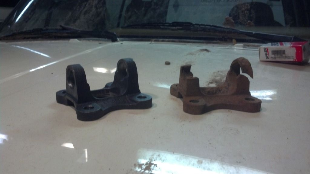

I didn't fix the wipers but still wheeled and ofcourse it rained all weekend so I bought a squeege. It was probably one of the worst wheeling trips I've ever been on but still beat working. Only got about an hour of wheeling in before I broke the flange adapter on my 8.8. I was on a rock pile and I slid off and landed on it and I heard a weird sound and then slowly tried to pull forward and heard a bang. I got a spare at home but I have had issues losing snap rings a couple times on those things. Anyone got a better way like a ubolt style flange adapter?

snapped one side and the other side is cracked

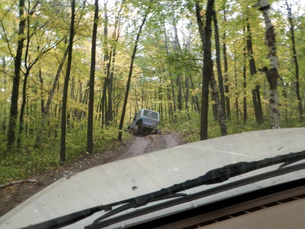

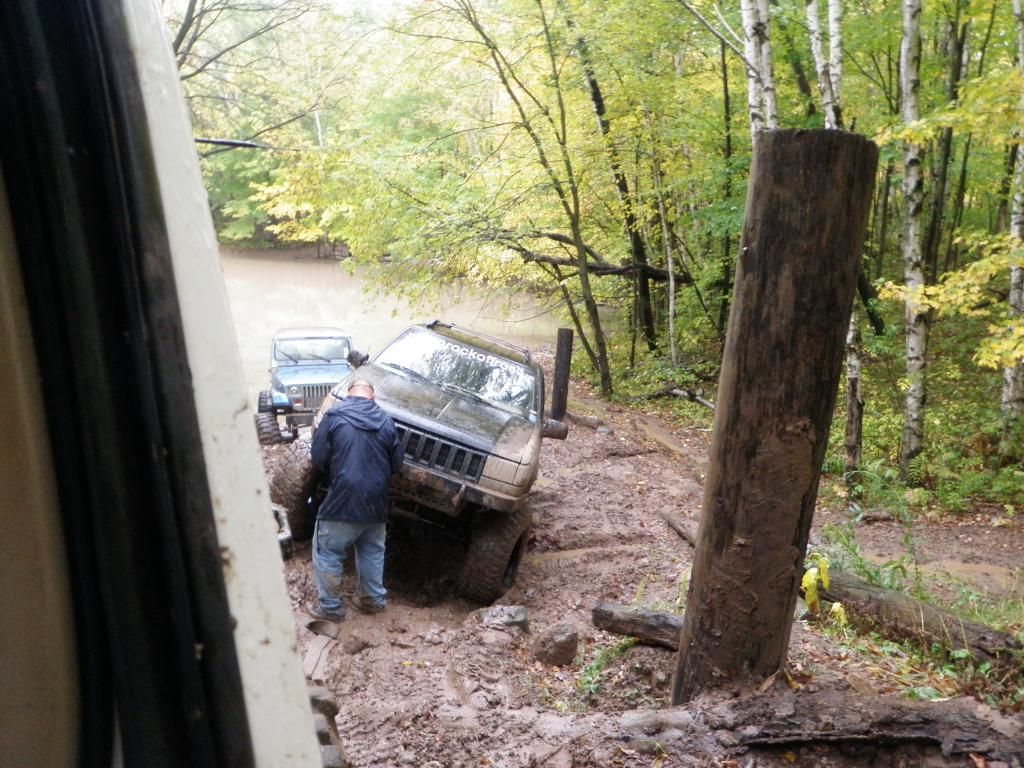

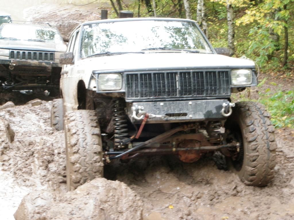

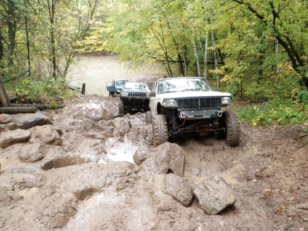

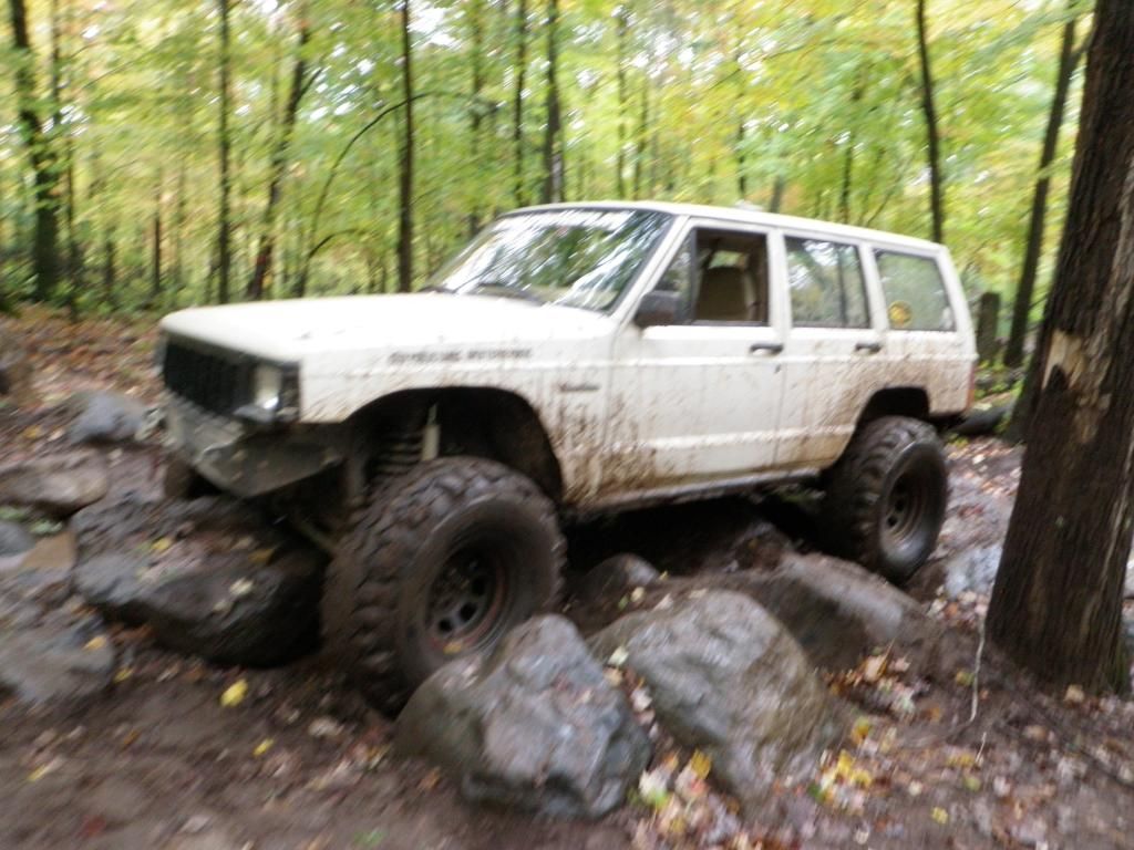

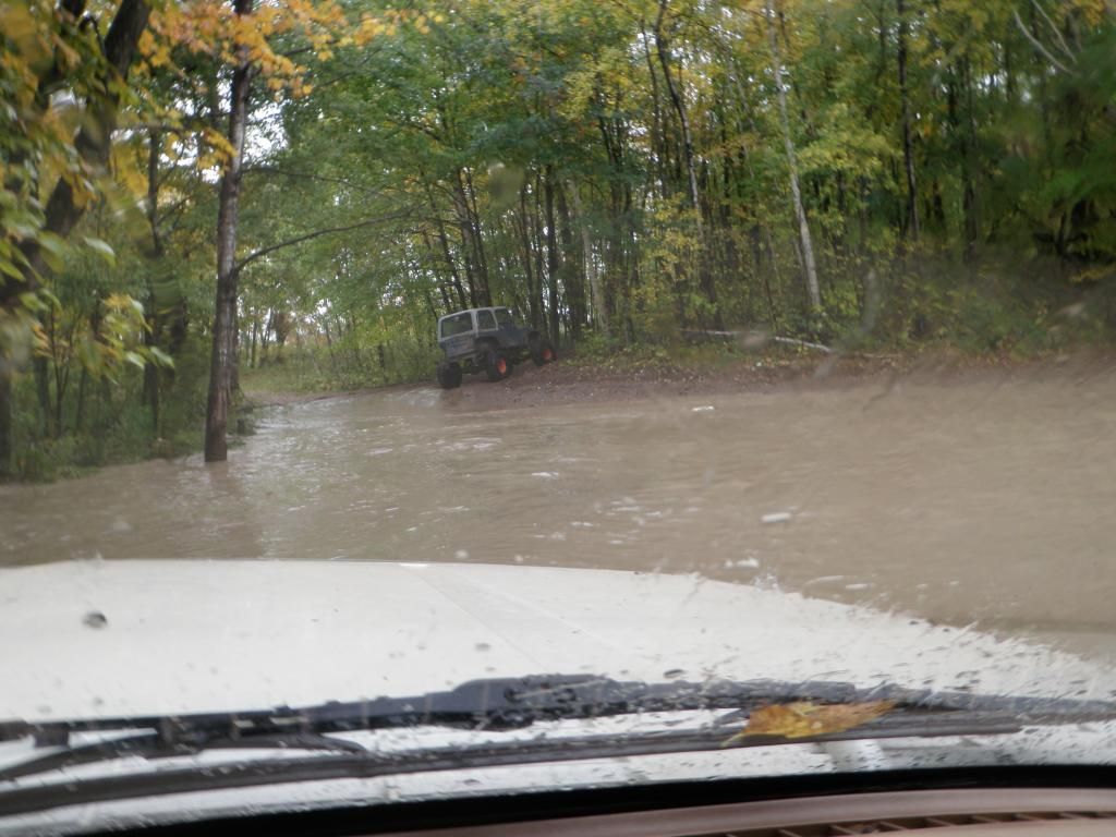

first stuck, got half way up and it was so wet and sloppy the tires would just slide off the rocks then I slid onto a boulder and my tcase was sitting on a rock and the rear end on a log, had to get pulled backwards and back down. this trail is hard even dry so im not sure what i was thinking

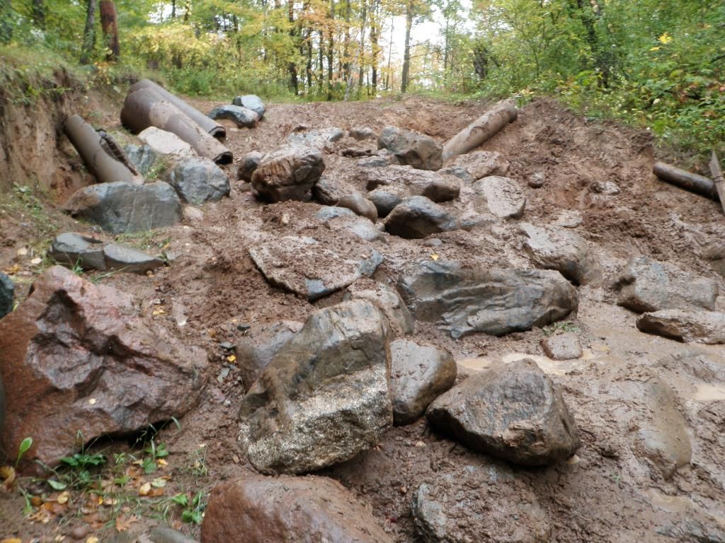

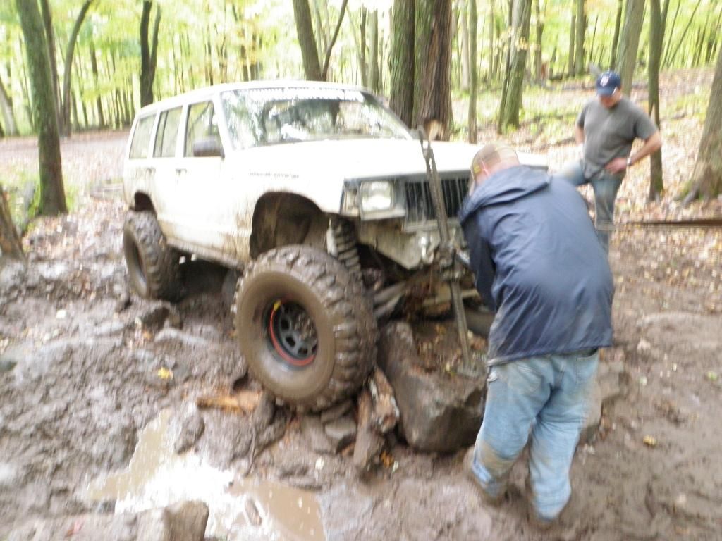

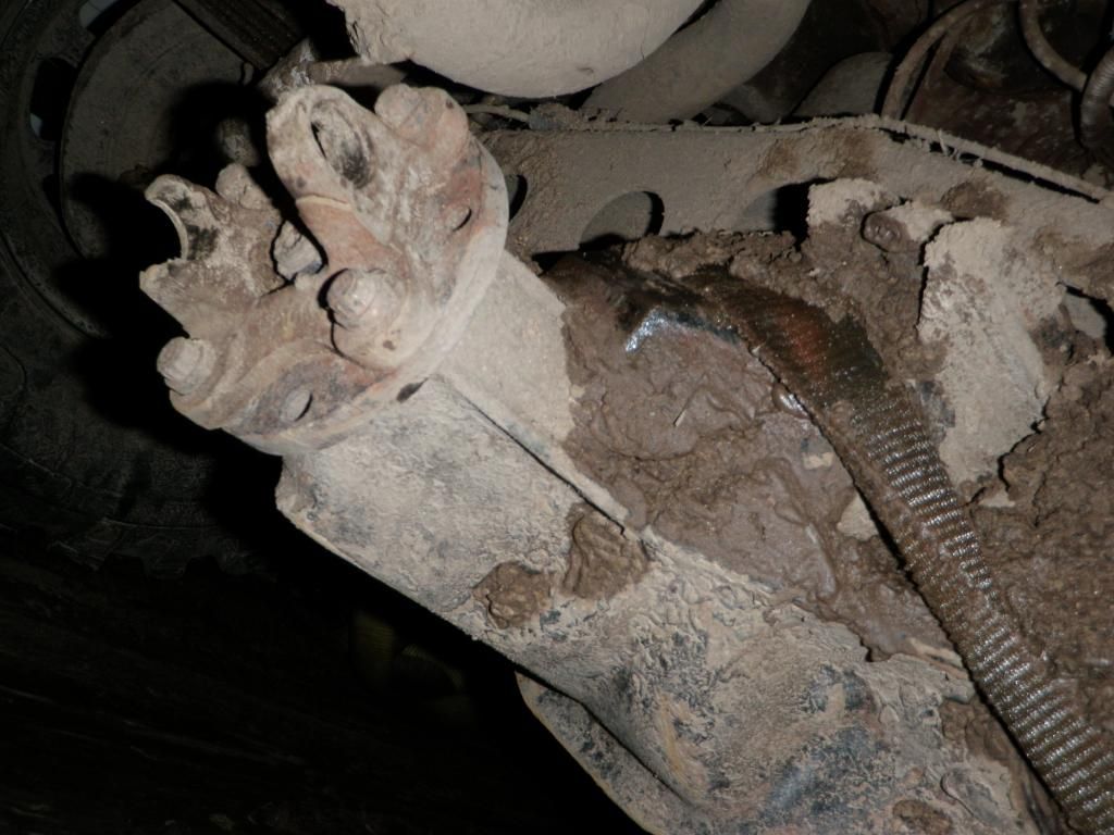

Where I broke..had to hi-lift a couple times, stack rocks and then hi-lift the rear end. I had a good line then I slid into where I broke.
Then cruising along in front wheel drive, I looked in my rear view and saw this

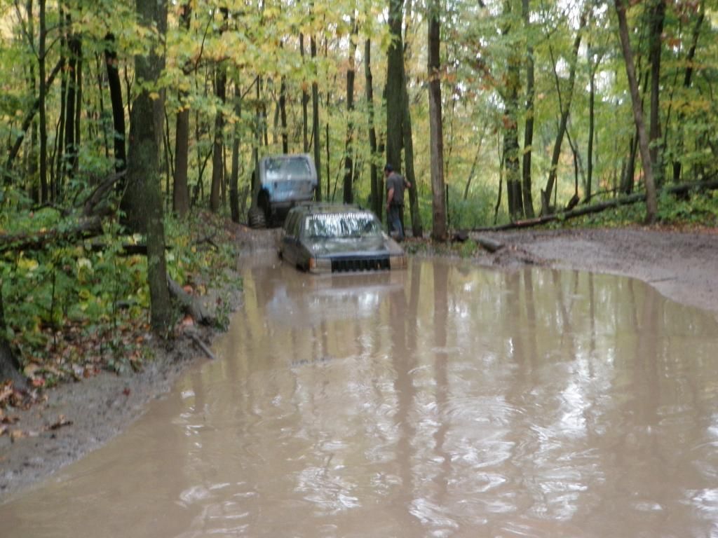

Posts: 9,774

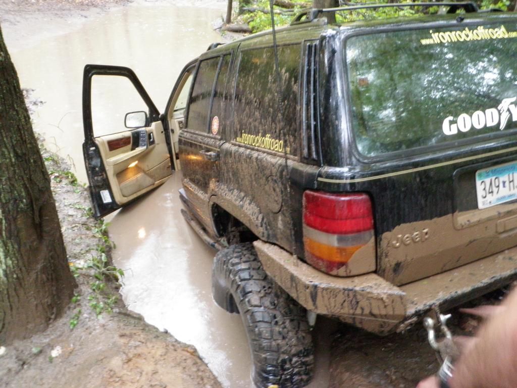

That's actually iron rocks old zj its a guy who bought it from them and wheeling it now. Interior was soaked and motor was hydro locked. Pulled the plugs and emptied the cylinders and good to go. Tranny was full tho

Finally fixed the jeep, new flange adapter and she's good as new. I did notice my grease zerk for the slip yoke is ripped off and dented in where it should be. Not sure when that happened but I can't get the broke zerk out the hole is an oval now anyways.
