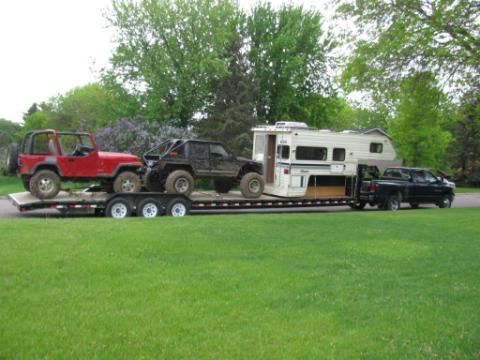

Man your jeep looks awesome and it has definitely come a long way. I do however find myself interested in your Tow rig. is that truck rocking the 3.9 liter and if so how does it do with Fuel mileage and performance when you are towing the trailer and jeep. Also when towing what speed are you cruising at?
Thanks man, truck has a 4.7 HO V8 in it with some mods. It gets around 18mpg daily (freeway to work and back) and towing gets 11mpg which is ok since I was expecting 6mpg with it lol. I keep it out of over drive and cruise around 65-70mph, at about 2500rpm. Its about 2200rpm at 65, 2500 at 70. I bought it just to haul stuff in the bed and eventually sell it and get a 3/4 ton diesel but its hauling well enough I think I might keep it and pay it off (end of this year) and then look at a diesel.
Performance wise it likes the higher revs, low end torque is ok, it takes awhile to get up to speed hauling but for a basically half ton truck it does alright. On the freeway it will only downshift going up a constant steepish grade other than that small hills it does just fine and stays in the same gear. My trailer is about 800-1klbs and with the jeep on it I am guessing somewhere around 5klbs(?) and I think max tow rating for the truck is 6500lbs.
I kind of Figured it had to have a V8. I borrowed a buddy's 4x2 single Cab Ram with a 3.9 liter in it and ran it from Florida to Tennessee empty so I was running 80 mph where ever I could. It got horrible gas mileage I don't remember the #'s but I was not impressed at all. on they way back a had Honda VTX stuffed into the bed of the truck and on the way home I drove much more sensible cause my new Baby was back up in there. I actually got better gas mileage on the way home. While I was grateful to have been able to use it I was not impressed with the 3.9 in that full sized truck.
I now have a Toyota Tacoma with the 4.0 liter V6 that I use to tow my same VTX around in a 6x12 enclosed trailer. It gets pretty crappy gas mileage pulling that trailer even when its empty because that Flat nosed trailer is like pulling a brick wall around. I haven't found the right jeep for me yet but I have been wanting one for a long time now. My plan also was to not keep it street legal and tow it around everywhere with the Tacoma. My Taco has the Same Tow rating as your truck but I bet having that V8 makes towing a much more enjoyable experience. I did pull a friends YJ around town with a Car dolly a few months back but it was missing the Motor and Trans.

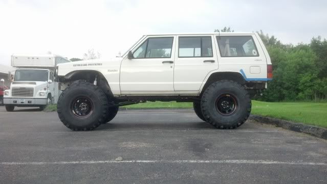

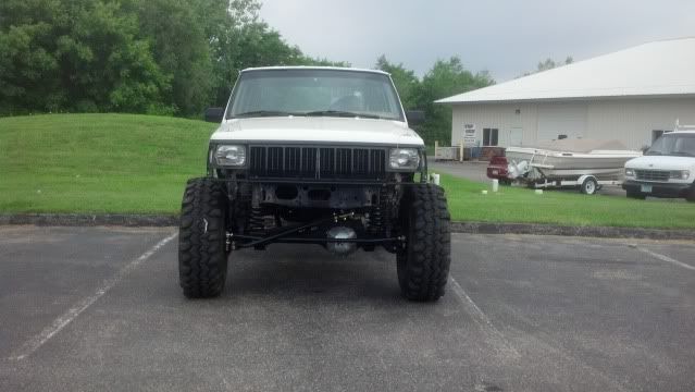

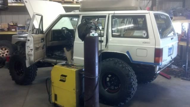

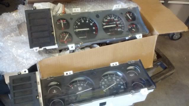

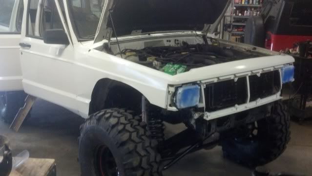

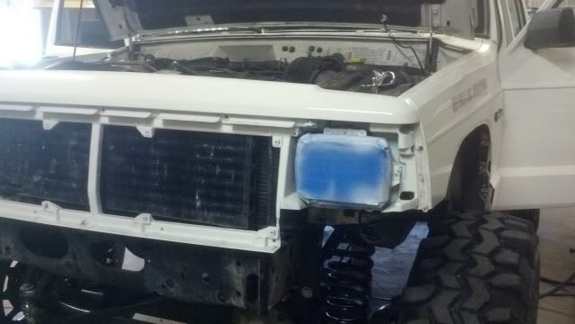

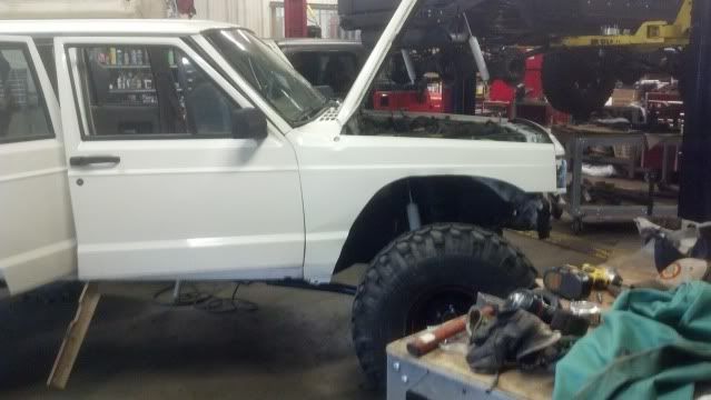

Almost ready for bedliner, I will be throwing a coat on tonight and then another in the morning
Put in my sport gauge cluster I got from koolaid5, now I feel better being able to read the gauges. Not sure why the idiot light didnt go off before but its saying im at over 80psi so I guess sending unit is next on the maintenance list
Jeep is finally all one color too, the color matched pretty good. You can still tell but not to bad
And tacked my rear fender together, gonna have my welding buddy actually weld it since I am to chicken to weld where people see it lol
Looks good man. I especially dig the 36's. Those may be my next tires, though I'm scared that once I go 4.88's the 30 won't last long lol.

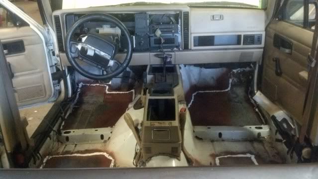

All in a days work, bedliner is in, cant really see the patches with the liner on, we will see how it looks tomorrow when its dry. I did seam sealer on all the panels and underneath
