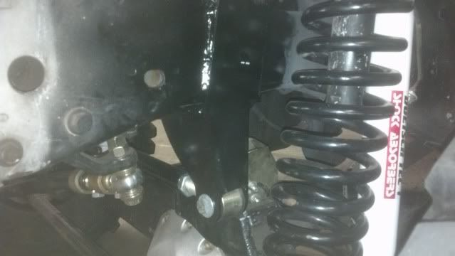

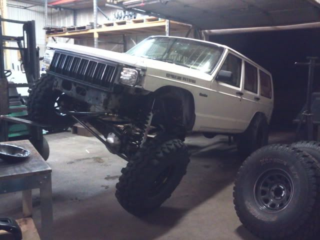

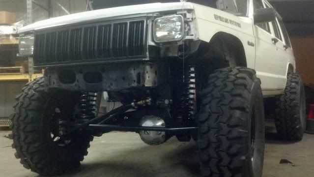

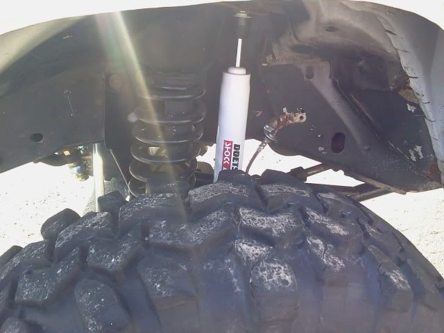

Got a little more done to the white one tonight as well. Got the passengers side front almost welded up for floors, Drivers front almost done too, then its on to attacking the back floors. I also put in doetsch tech shocks for the front the other night too. Did the shocks for an 8" lift, they bumpstop perfect and more than enough down travel. They would let the coil fall out for sure but I am ordering some trail gear limiting straps. I measured tonight for the straps:

If you weren't so far I'd totally consider it. Damn that thing flexes nice now. Definitely need straps though just in case.

Aint to far! Haha and yeah people said 4" and 36s dont flex well, thats how she will be! Little less in the back since I havent bumpstopped yet but thats how the front will do!

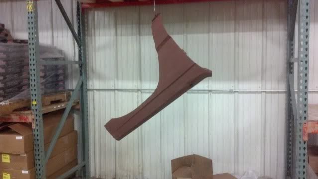

Painting passenger fender and repainting header panel to match, got some color match paint hopefully it turns out nice. I didn't know it but its the same paint as my ZJ the stone white so I got a bunch of extra paint. That was a nice surprise.

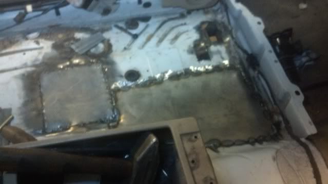

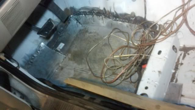

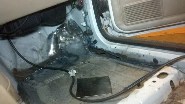

Floors are getting there. Gotta run a couple stitches on the front pans where I had to extend the patches. Its ugly but does the trick. Found more rust in the back floor boards ugh.
Drivers front pan
Passenger front pan

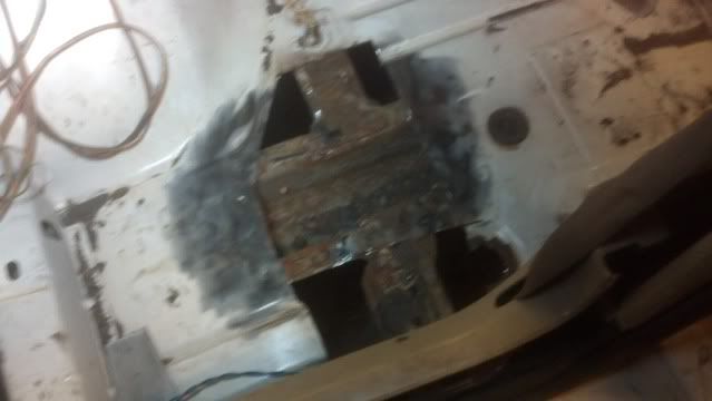

What was a small hole turned into this under drivers seat
Passengers rear just gotta make one more patch here

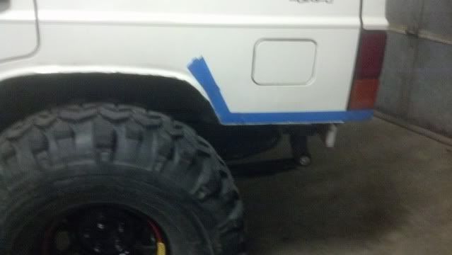

Also did this while my buddy sam was burning in the track bar mount. I am going to make a piece to fit up under and then just do some stitch welds up the the fender and leave the top and front of the fender cut and folded. I will be extending the rear end back an inch so no worries hitting up front its just clearancing the back
