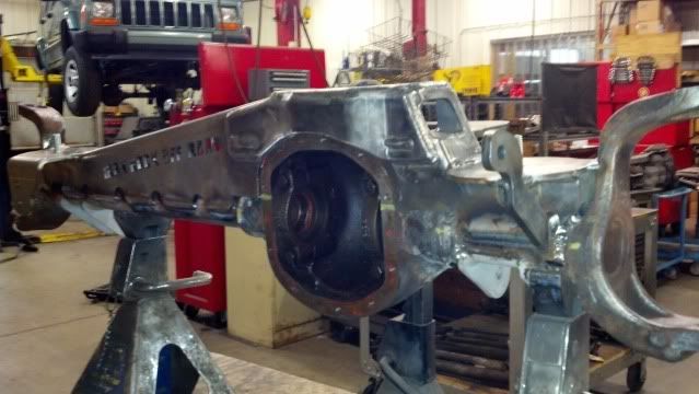

Alright slow going here, me and the girl got a cruise coming up in january so my mind is more focused on that then anything else and were in the middle of remodeling my parents bathroom as a Christmas present from us but I found time tonight to stay late with my friend at work and he welded up my tubes on the D30 which is a long process of heating up and welding the cast housing to the tubes. But now that thats done, tomorrow the truss can go on and I am doing the inner axle sleeve kit too. I am also going to put a loop or something on the truss for my suck down winch. My biggest problem with my old jeep was the suspension unloading on really off camber stuff. So on this one I am going to make a mount on the passengers frame rail and run an atv winch to pull down the front end.
Tubes welded

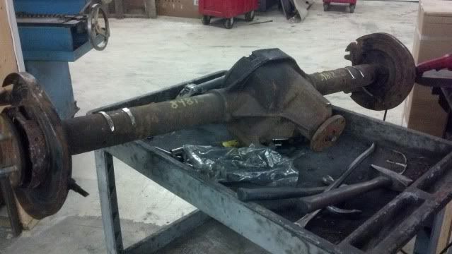

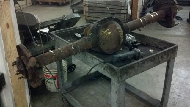

While my buddy was welding, I cut off the sway bar mounts and leaf perches off my 8.8, set a bunch of paper towels covered in diff oil on fire..that was fun
Ordering a spool for the 8.8 soon and 4.88 gears for the 8.8 and D30 too

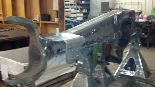

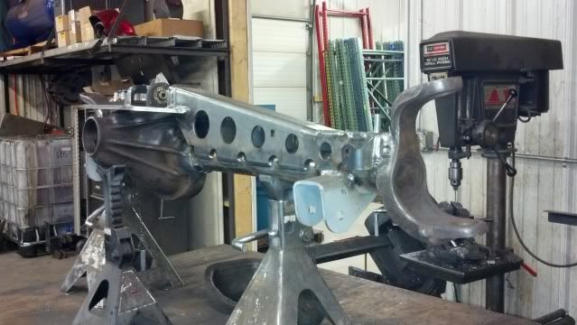

I know youd rather see pics of the jeep but the axles are slowly coming along. Money is tight for Christmas and the cruise coming up but after that, should be in the clear. Heres the truss my buddy welded on tonight, gonna design a suck down winch mount I gotta check oil pan clearances first but after that, sway bar mount and rest of track bar mount go on then gotta order up the 4.88s and clean up the 8.8.. slowly but surely.

Its iron rocks new box truss its pretty sweet! It replaces the sway bar mounts, coil buckets and shock mounts. Only downside is it adds lift which since I am going with an LCOG rig, kind of sucks but I will make due, especially with the suck down winch. But the truss moves the coil buckets back and raises the shock mounts for clearance so it will help with the coils bowing when I stretch the front end. The rear is also getting stretched with a spring flip so I have been designing my cut and the inner fenders for when I do that since I will have to make my own wheel wells basically. It will get interesting! Next up are the c-gussets, inner axle sleeves and welding the truss on the 8.8 and spring perches and then I get to start on the actual jeep!
