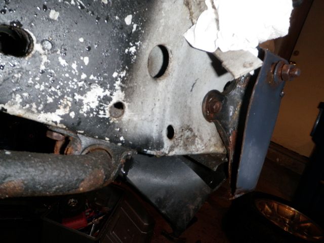

This is where the tire hit the floor, gonna bend it back but the tubing for the cage will be running through there anyways so who knows

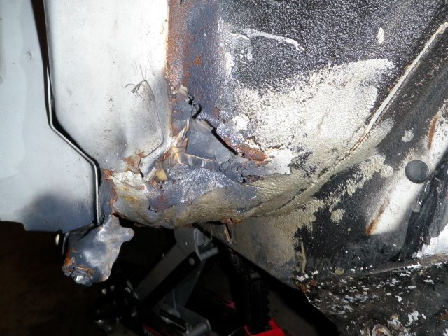

Floors look like this on both sides

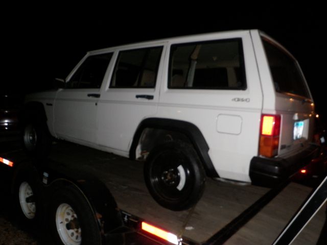

Body straight as an arrow

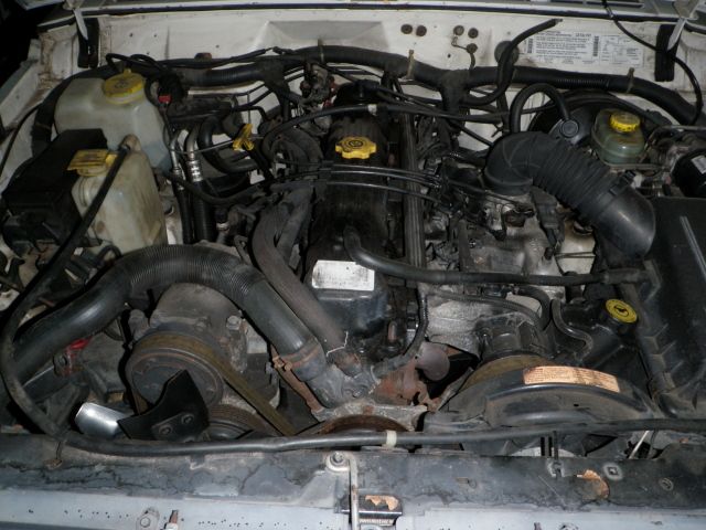

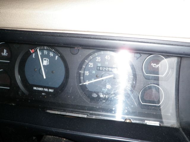

It must be an SE, has the lame instrument cluster, I will either swap over a full one or just hook up mechanical gauges, idk yet kind of leaning towards running auto meteres for accuracy
Need to find an e-fan but more than likely I will just run taraus fans

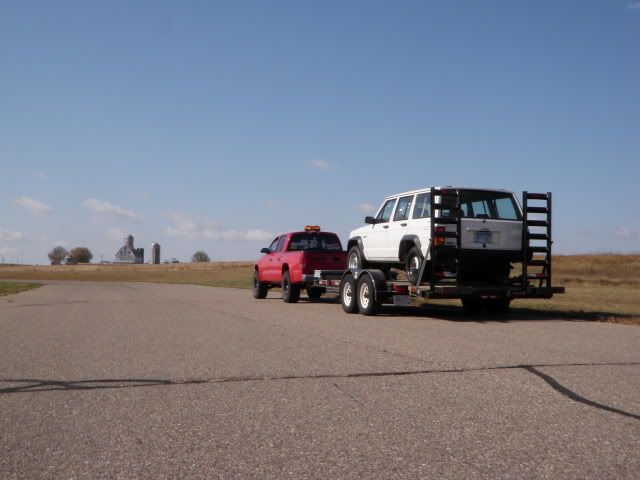

And heres her resting place for now at work

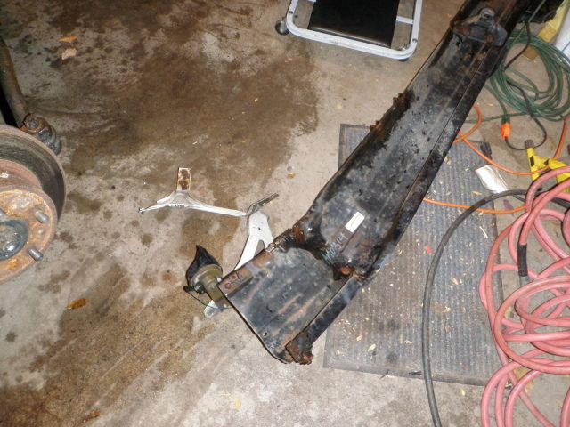

I pulled off the bumper which was a feature in itself since the mounts were bent and folded over. Then took off the mangled side support. The unibody rail on the pass side is bent at the bumper mounts on the front but not bad.
Went to take the LCA off but half the bolt sheered in the wreck and now the bushing is just spinning in the tube so I will have to cut it out. Might just wait until I got the money for the lift and cut the LCA brackets off at the same time.

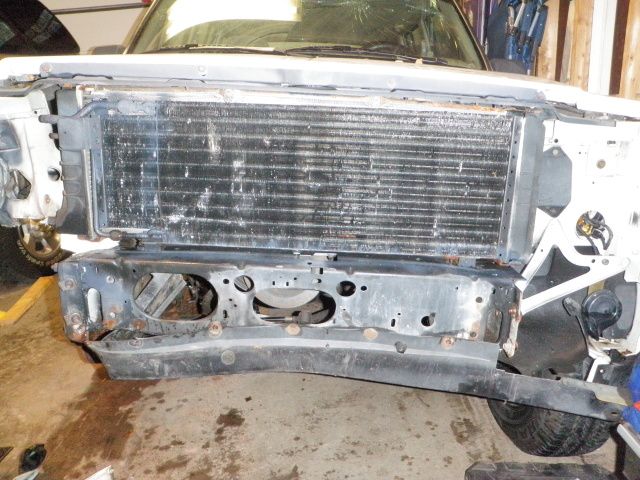

And an overall front shot. Gonna have to put in the new radiator soon and remount the condensor then since its half falling off.

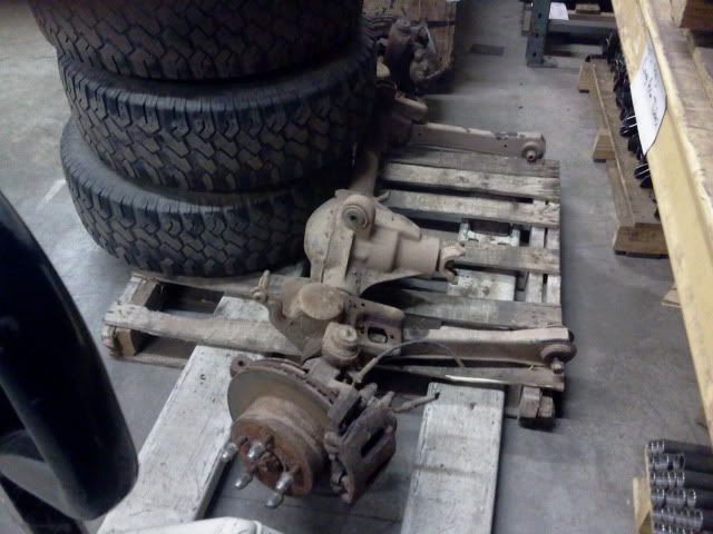

Got lucky, guy scrapping an xj, got the HP30, passengers fender, header panel, lights, and a radiator all for $50!It has abs but thats whatever, gonna start tear down and clean up on the axle soon, probably will do the c-gussets, HD LCAs, and inner sleeve plus maybe the truss now, throw it in the XJ and do gears down the road.
