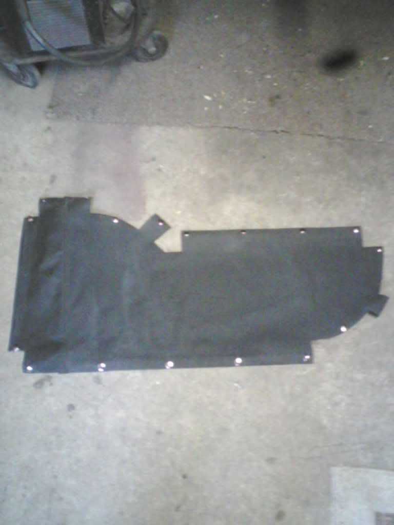

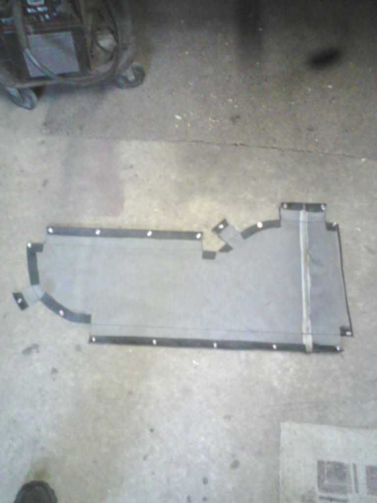

I got the tube door skins done. I started with tag board (as most of my projects do). Made a pattern, then transfered it to the old soft top. Then added extra to hem the edges, and make some snap tabs. I ended up with 17 snaps per door. But they are easy on easy off, and can roll up and put about anywhere.
Cell pics but you get the idea. I have a grand total of $20 in the doors. (I needed to buy some snaps, and one latch)

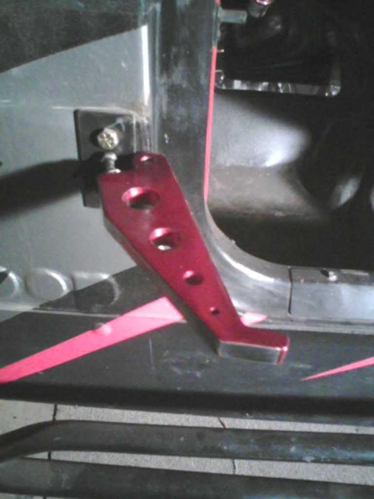

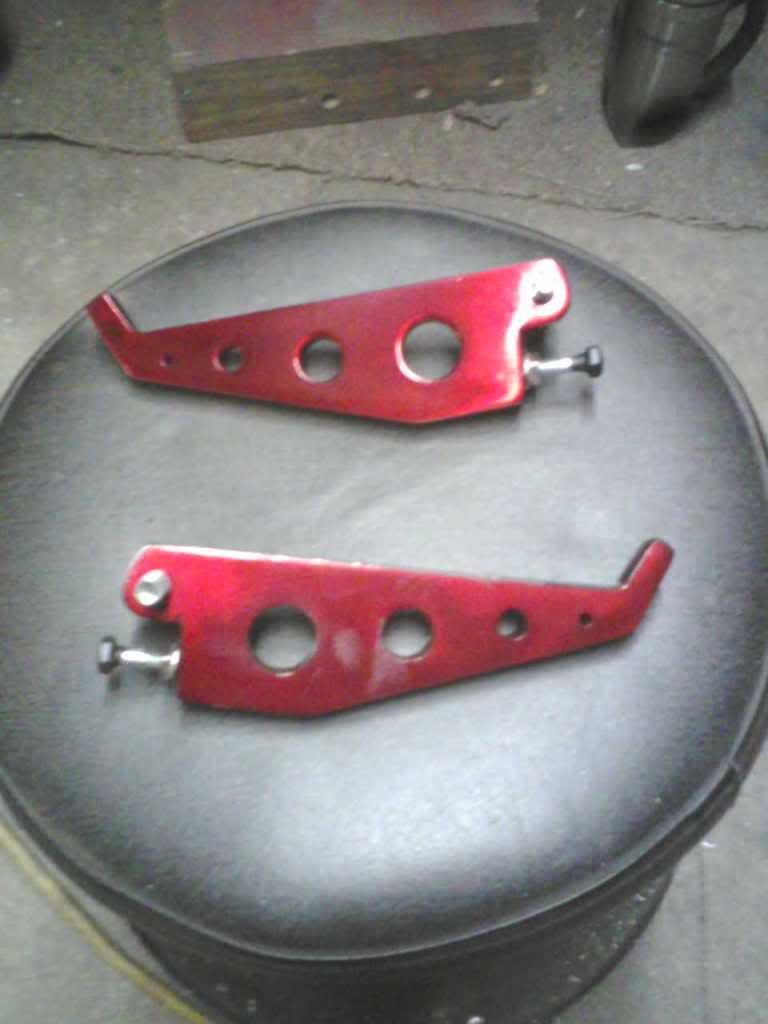

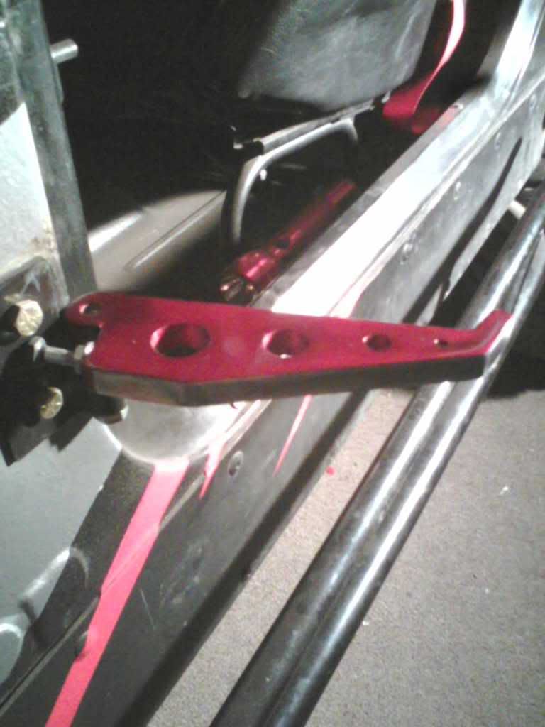

I got my cross member/ skid done and installed yesterday. No pics yet, I'm sick of crawling under the jeep. I will get them in the next few days. Today I was a little bored, and was looking at jeep foot pegs. I always have my foot resting somewhere other than where it should be. There are some nice ones out there, but for around $75 they can keep them. Once again I started looking around to see what I had. I have quite a bit of 1/2" thick sheet aluminum. I have been wanting to use it for something, and this was perfect. I made a template out of tag board, and went to work. Cut it out with a cut off wheel, ground with flap disc, a little sanding, and came up with this.
I put them on the jeep to check for fit, and they are really comfortable. I made them adjustable for different angles. The mount is drilled and tapped, and the adjuster/ stop is also drilled and tapped, but the end of it I dipped in some tool dip. The rubber tool dip won't scratch the paint.
