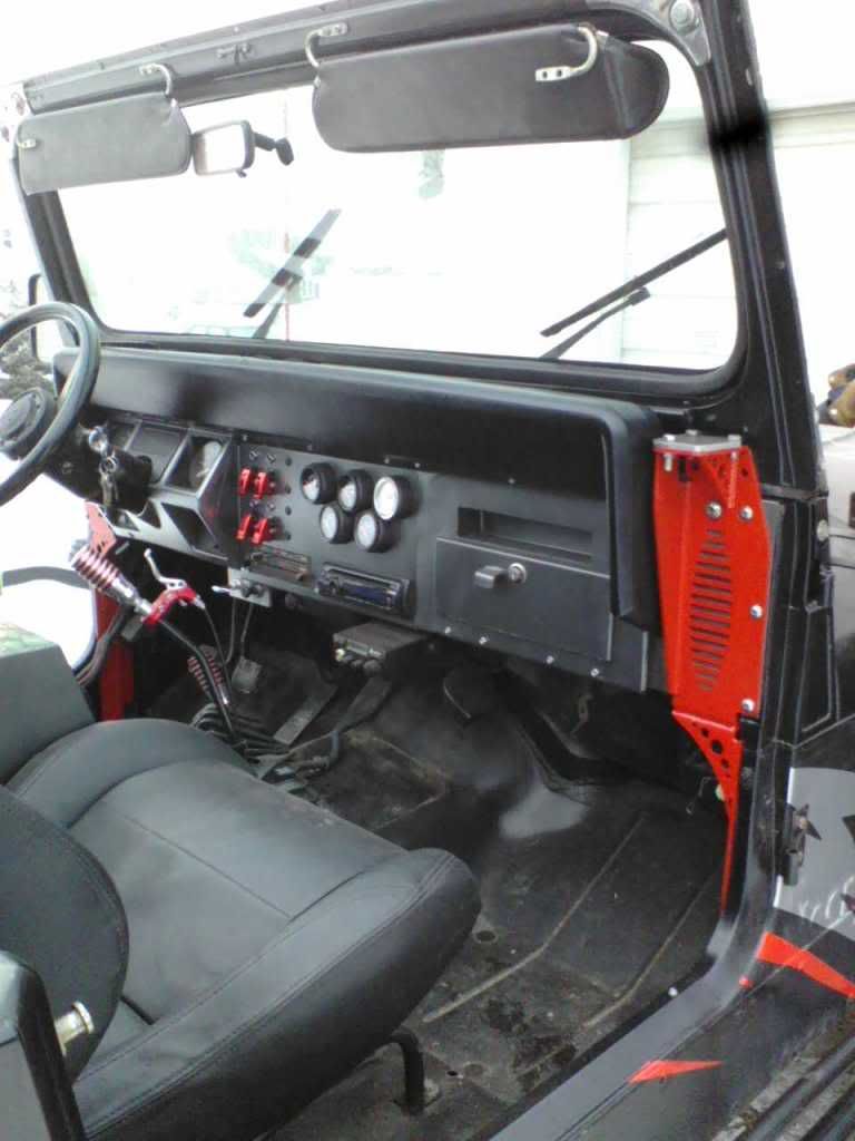

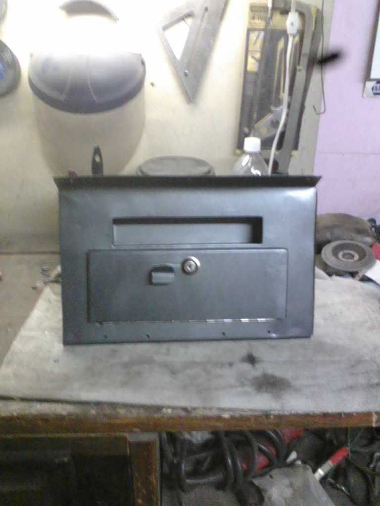

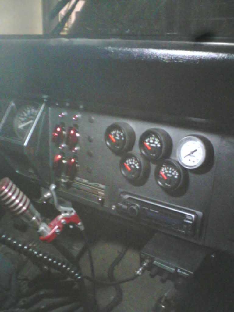

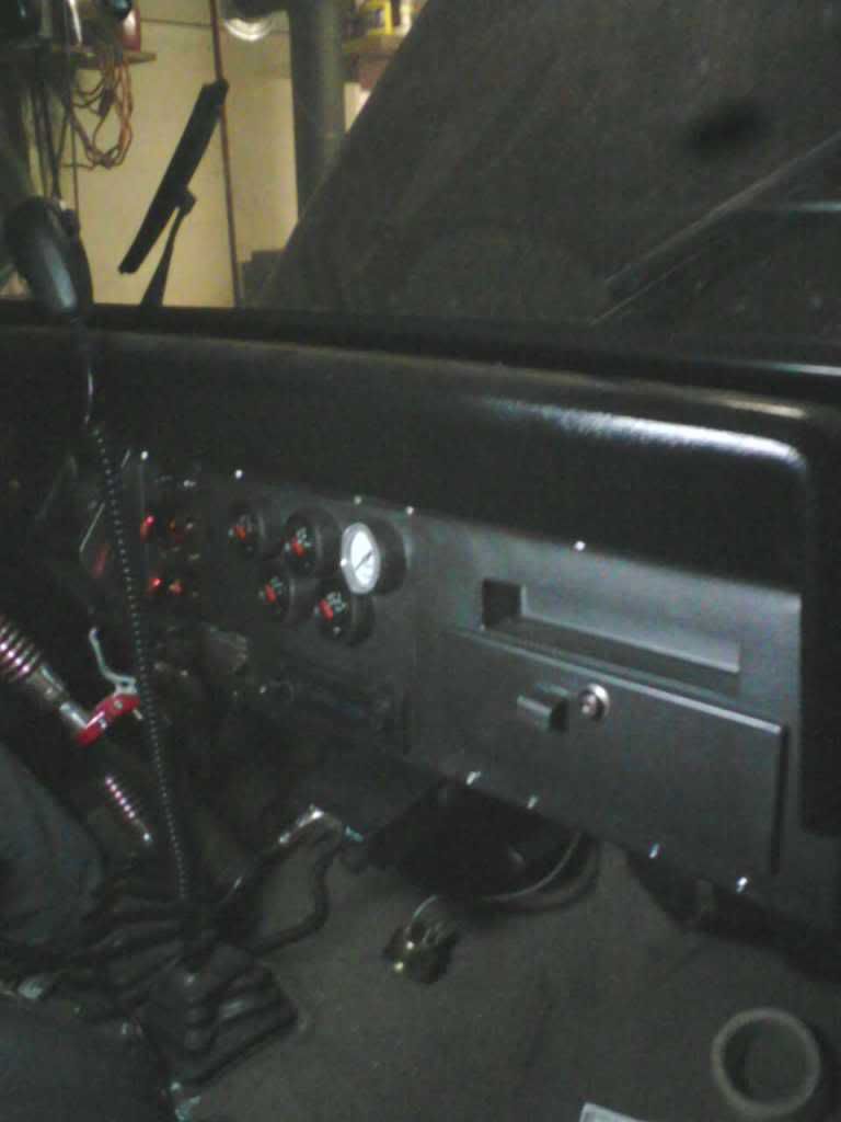

Got my glove box done. I do have to say I like this dash set up much better than stock.
And a few crappy cell pics of the dash installed.
Hopefully will get some better pics soon.

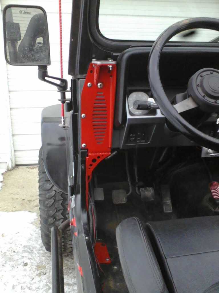

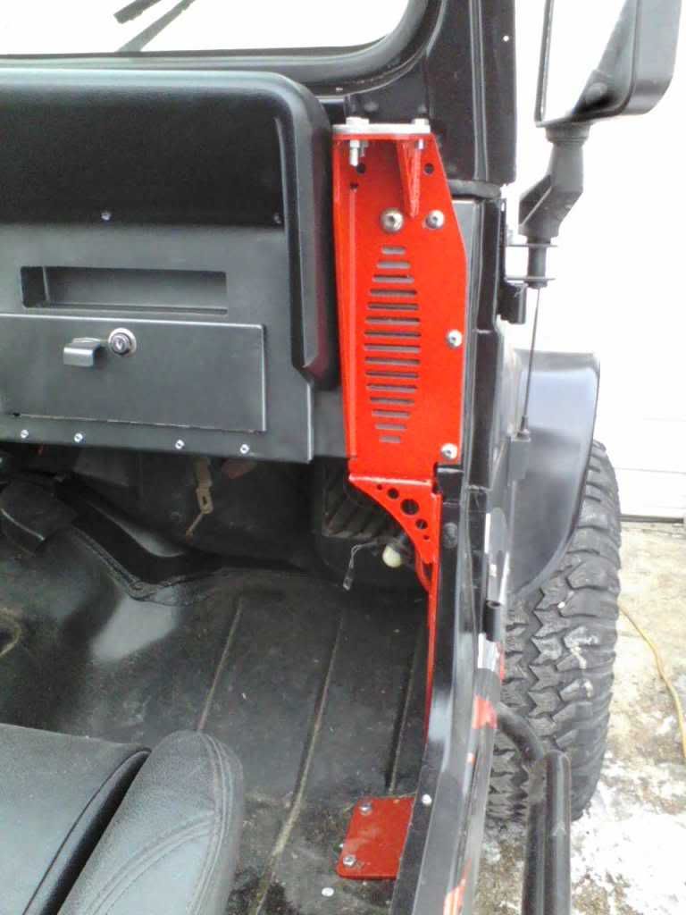

Moving forward I have the Gen Right Cage Stanchions installed. Just to let anyone know that might want to install these, bolt the top and bottom parts together before you put it in the jeep. Once I had it set I tightened the bolts and welded it together. It says just to bolt them, but I welded for strength. Here is a tip: If your running a hard top, make sure you have your windshield angle set. The stanchions tend to push it forward, and will interfere with the top fitting. Here is a sneak peek if them installed:
