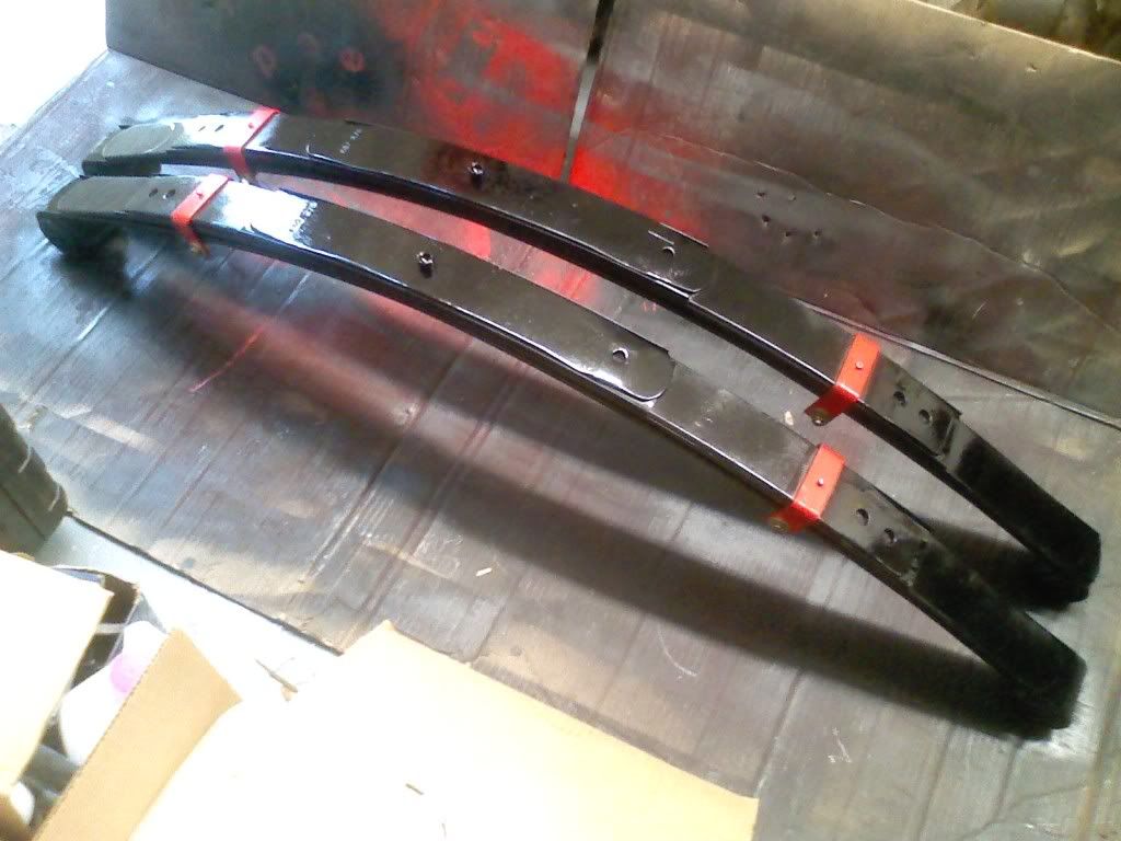

Leaf packs are assembled with the new liners for the last time. Shot them with a final coat of paint. And.....DONE!

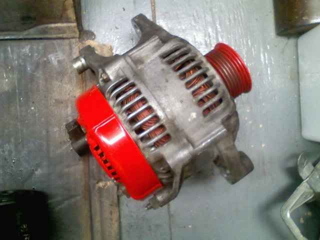

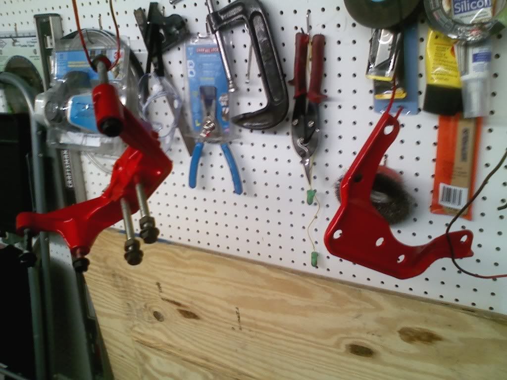

Also picked up a 136A alternator from a 98 Dodge Ram 1500 5.9L. Also grabbed some alternator brackets from a wrecked XJ to grind. Ground them down to fit the larger alternator, and painted. Also cleaned and painted housing on the alternator.

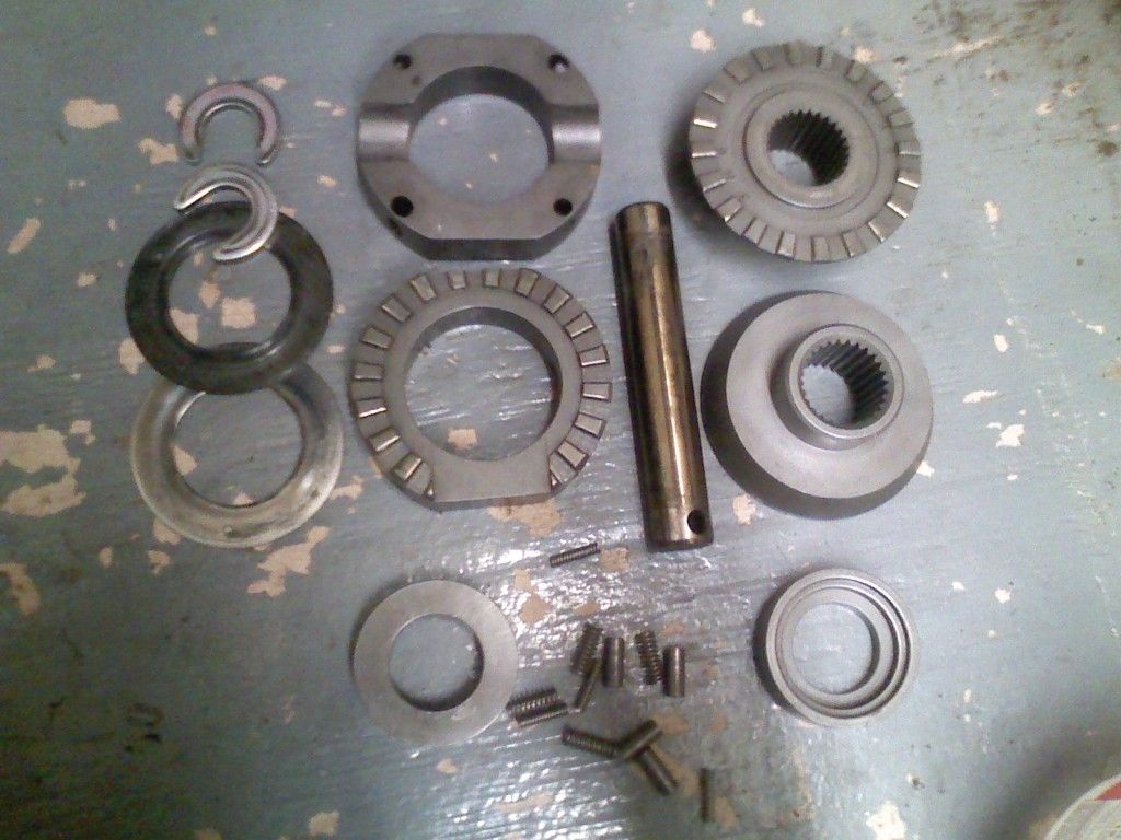

soo....figured out last night when i started disassembling the locker that it's not a powertrax, it's a lock-rite
oh well...still works for me

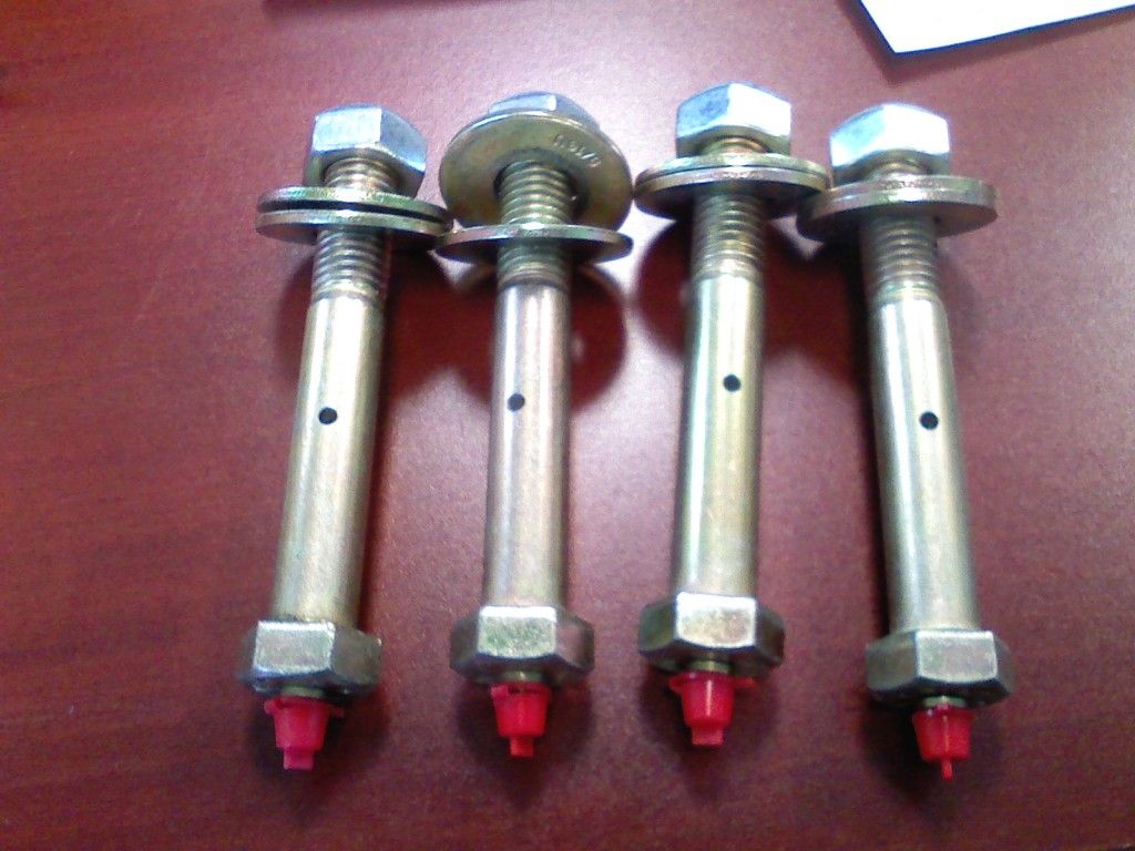

$40 in bolts....
not as impressive as I had hoped lol...

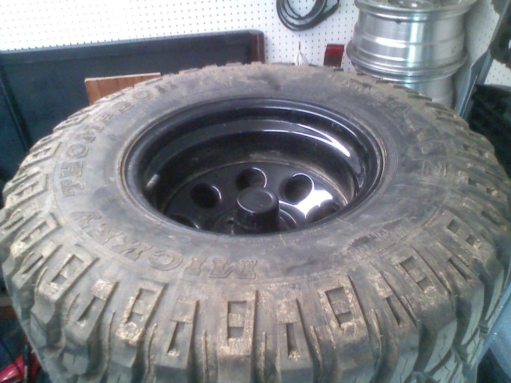

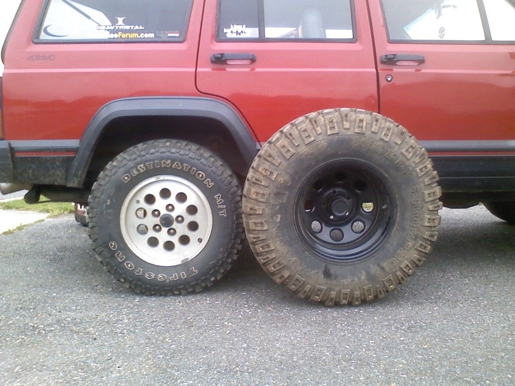

Finally found some tires...
33x12.5x15 Mickey Thompson Baja MTZs on 15x10 procomp series 98 wheels. Letters still have the blue coating on them....
picked up for 800 bones down in Virginia.
I think i need to bolt them on before I lift it :w00t:

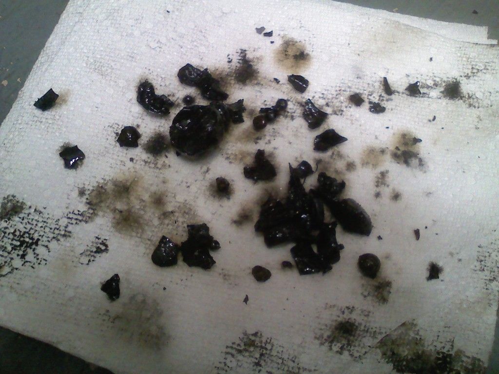

Then after picking the tires up I went home and pulled the locker out of the axle sets I picked up. Found pieces of grenaded bearings inside....nice...

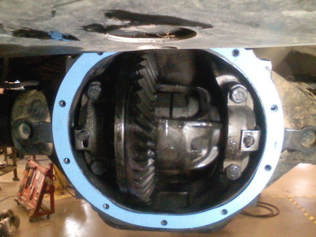

Saturday I went to to shop and installed the locker in my rear end
Driving with a locker in the back with a 5-speed is...interesting...It's gonna take some getting used to for sure. Part of the issue right now is my rear tires are slightly different sizes (full tread 235 and a worn 30), so the locker isn't as happy as it could be, and i get some massive torque steer under hard acceleration/deceleration. Fishtales though a grassy field like a boss though!

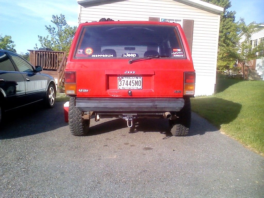

I cut and folded my rear quarter panels Sunday (fenders to come later). I used Paraleyes's writeup on JeepForum as a starting point, but then kinda just started cutting stuff on my own. Worked out well lol.
http://www.jeepforum.com/forum/f11/c...t-way-1007865/
Still need to rivet the **** out of it, seal it up, and bondo/paint. But looks good anyways. Also stubbed the rear bumper a bit to match.
(this looks weird at this angle lol)

Little difference....
Now THAT is impressive. Your rig is going to look like friggin Bigfoot when those go on.
Just to look at it, it doesn't look like they will fit in the wheel wells. What do you need to do to make em fit?
4.5" lift is going on first weekend in June. I'll be trimming about 1.5" from the wheel well lips (up to the pinch seam), and installing rear TJ flares front and back. Beyond that I just need to bumpstop to keep them from getting cut up.
