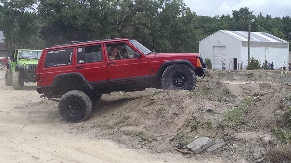

Jeep did great at JeepWeek in August. JeepJam obstacle course was a blast - Danger Cart dominated. Crushed a portion of rusted rocker panel, and found out if I REALLY flex out the jeep and turn the front drivers tire rubs a bit on the inner fender. No biggie.

evidently i had way more pictures from OC JeepWeek on another camera. Here are some highlights
