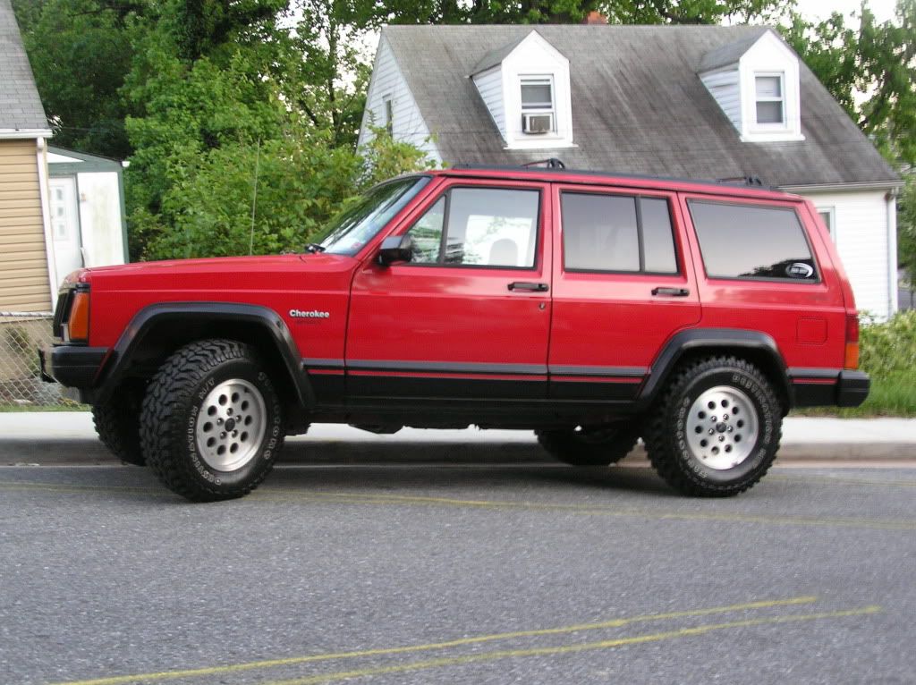

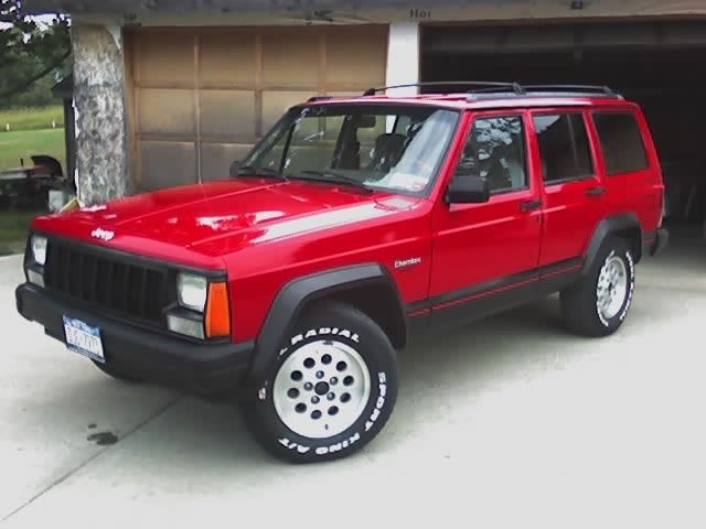

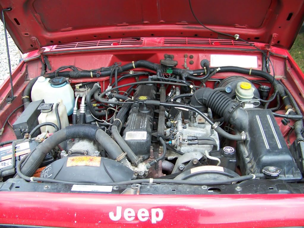

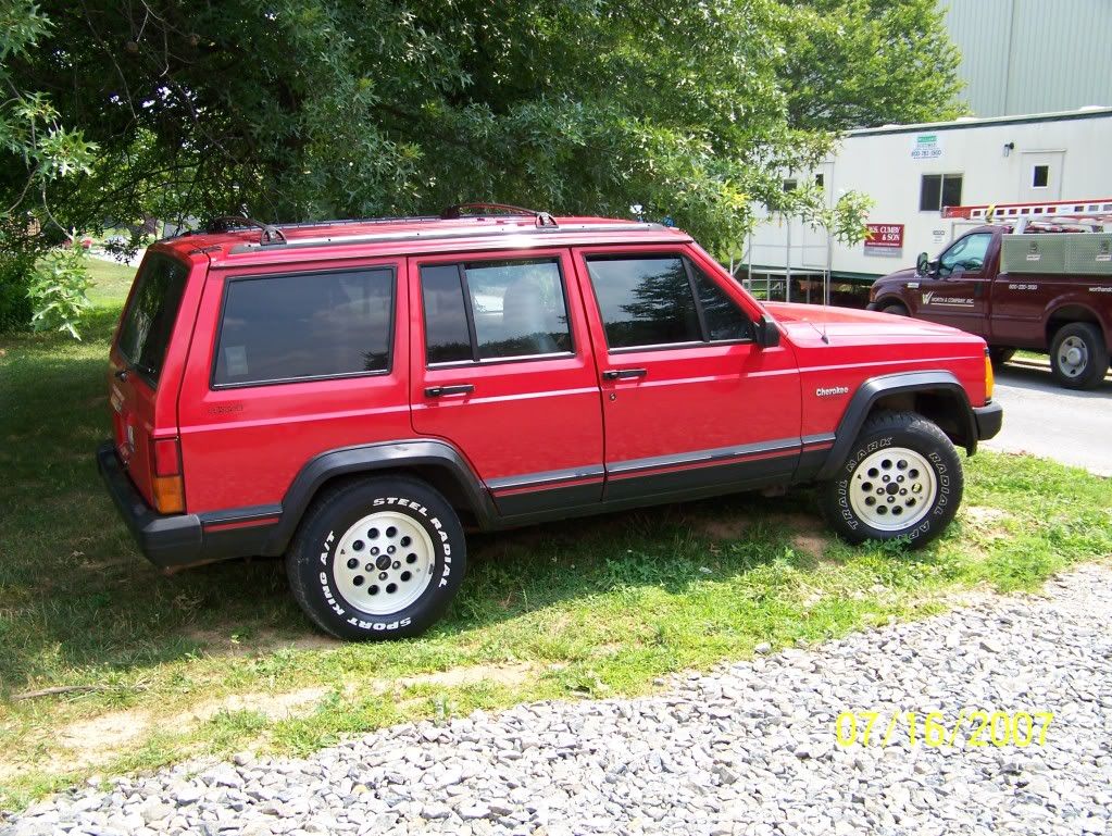

So...this is what I started with. A 1995 Cherokee Sport, flame red, bone stock with a sagging ***. 4.0L H.O., Np231 and AX-15 (god I love it being a 5-speed). D30 front and c8.25 rear. 196,xxx miles on original engine and transmission.
It was in pretty bad shape when I got it - busted out rear window, non-functioning radio, no rear brakes, and packed to the roof with trash and junk.
Spent about 2 days and 6 contractor bags cleaning it out. Replaced the window and rear brakes, and gave it a thorough wash and wax, as well as a shampoo. Cleaned up pretty damn good - but those tires have GOT to go

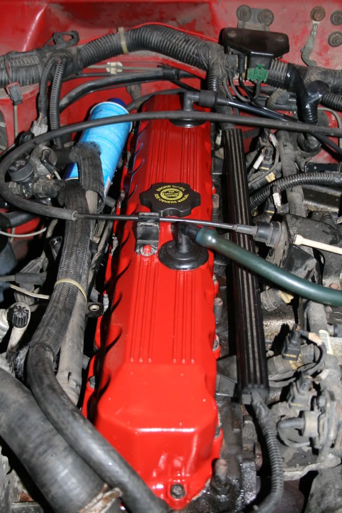

The legendary 4.0L

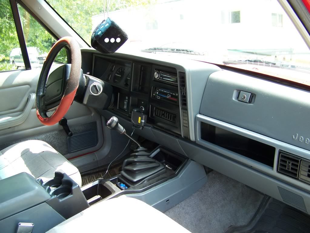

And installed a new head unit

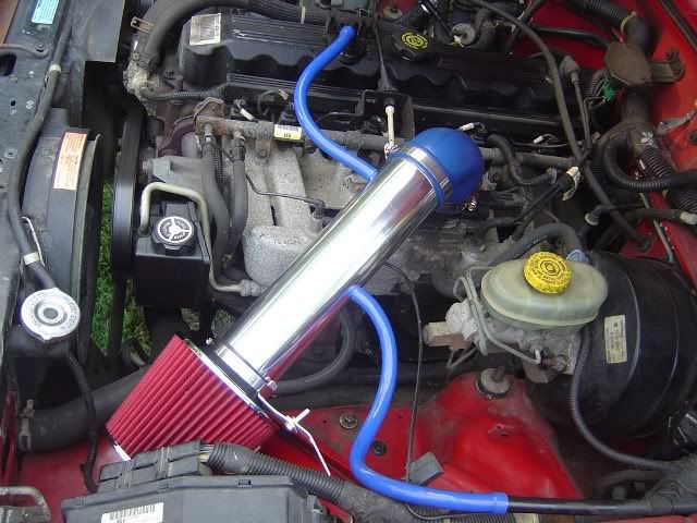

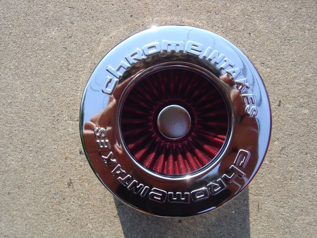

Then I decided I was tired of the stock airbox, so I picked up an intake off ebay for like $35. I made a shield too, but don't have a picture. Works pretty awesome. Great butt dyno impact
OOO Shiny!!!

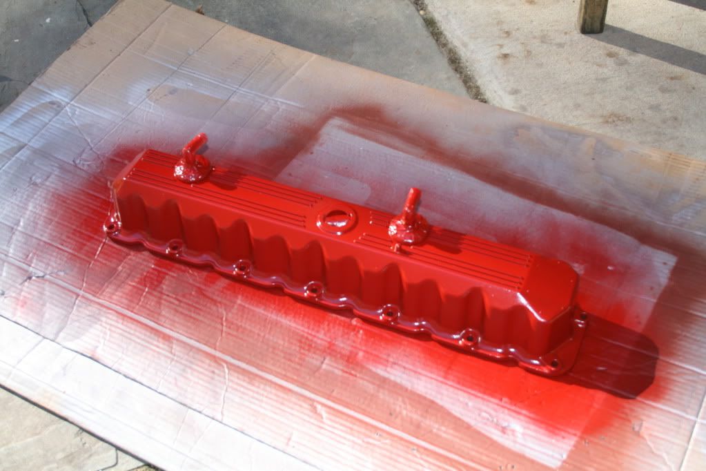

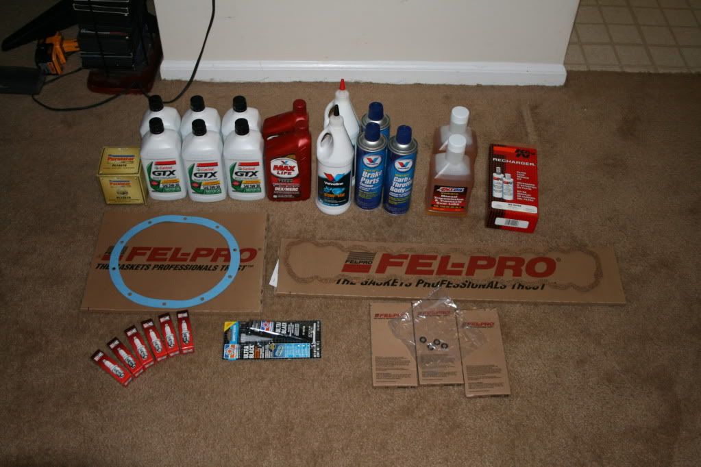

next on the list - mucho maintenance. Diff fluids, tranny fluid, and transfer case fluid change, new valve cover gasket, and new spark plugs
And some paint to spice things up!

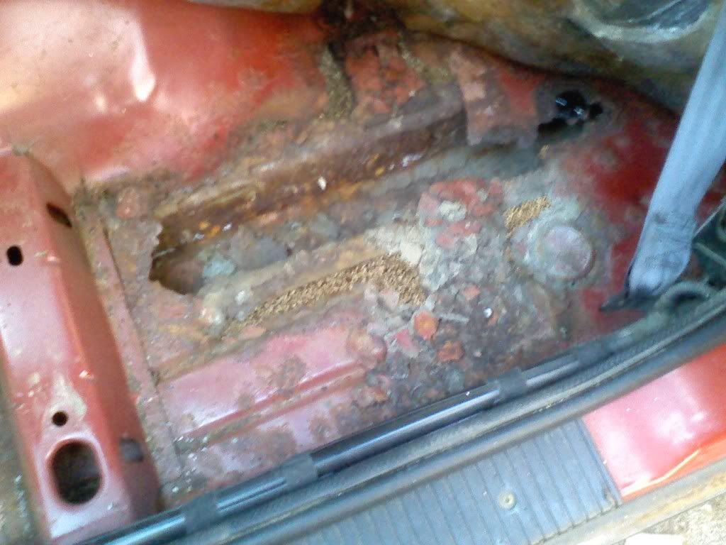

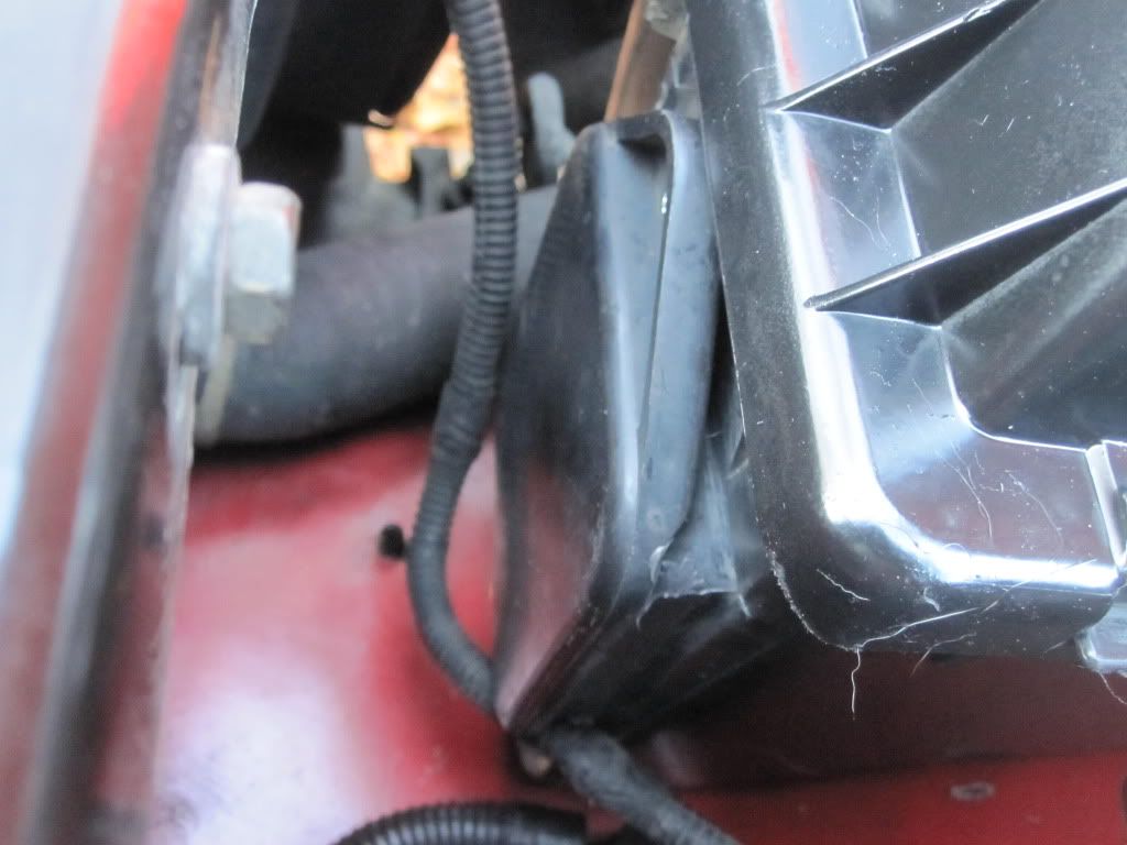

oh...and I peeled back the carpet to find this...(see the leaf?)
Temporarily patched with sheet metal, silicon bath caulk, and self tapping screws

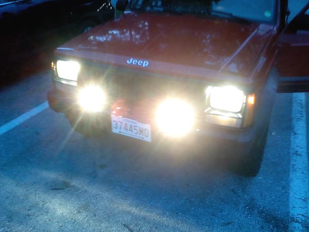

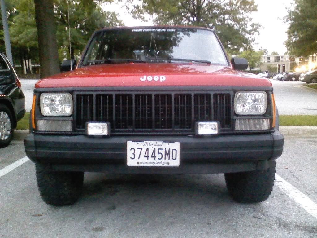

Picked up some cheap Harbor Freight driving lights, and installed some H4 conversions

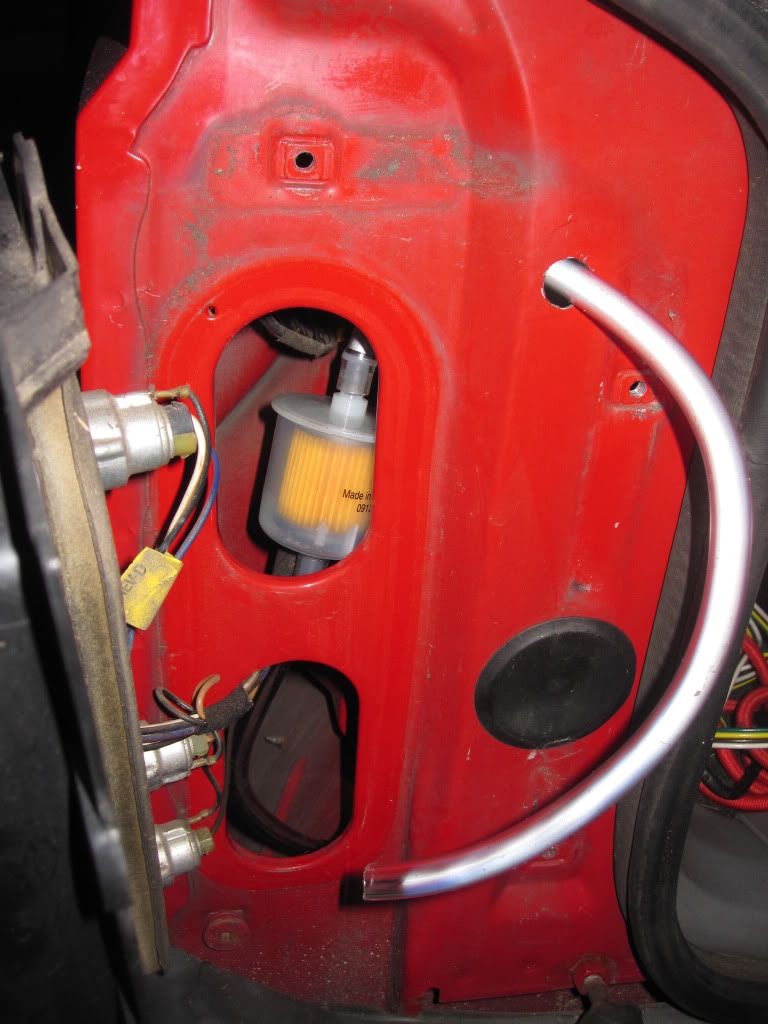

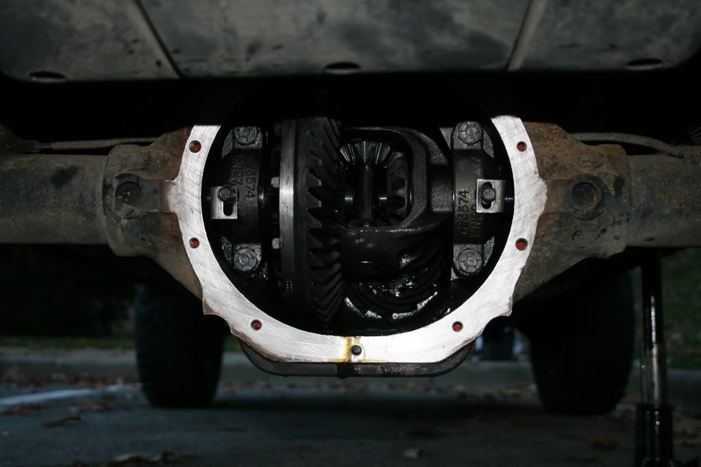

I had my first wheeling outing coming up, so I decided to make my jeep a little more trail/water friendly.
First was a vent extension for the rear differential. I used a one-way fuel filter and some clear line. Installed behind the driver's taillight - much higher than the stock vent.
Full writeup here: http://www.jeepforum.com/forum/f11/h...-vent-1137497/

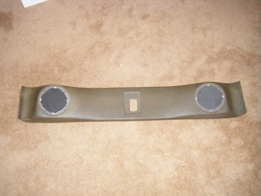

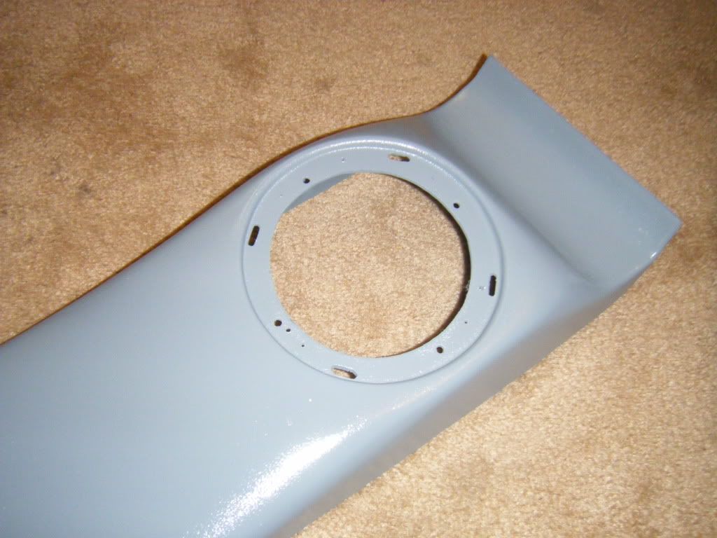

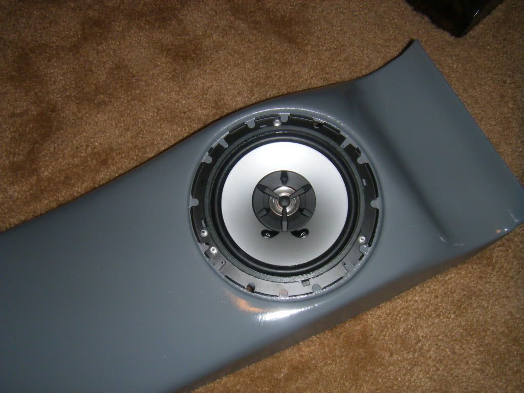

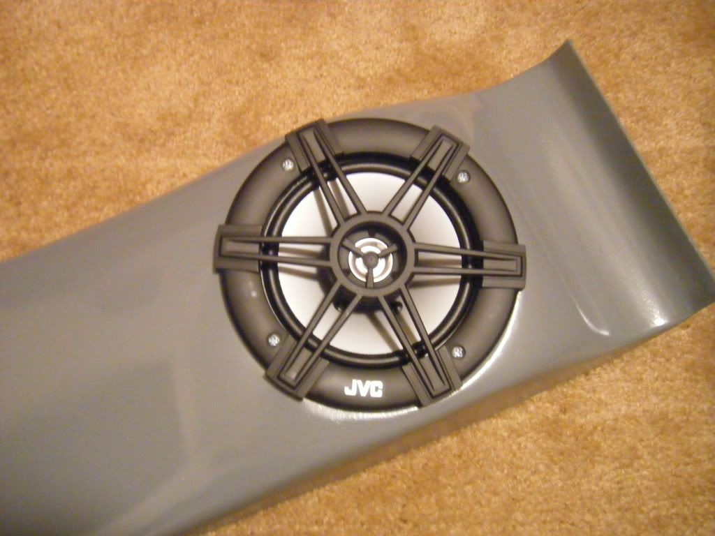

I was tired of my speakers crackling...or not working, so I snagged a set of 4 6.5" JVCs off crutchfield for $60. Installed 2 of them first in the rear speakerbar.
Little bit of trimming required to fit them, but nothing major. Also tore the sagging fabric off, sanded it down really well, and spent about 4 days priming, wet-sanding, painting, wetsanding, etc. About 16 hours into this - came out great!
More pictures and writeup here: http://www.jeepforum.com/forum/f11/r...heavy-1104865/
With the fuzzies removed:
Painted:
Speaker Installed:
Looking and Sounding good:

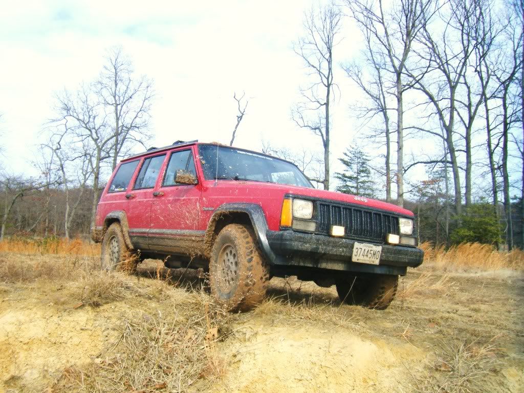

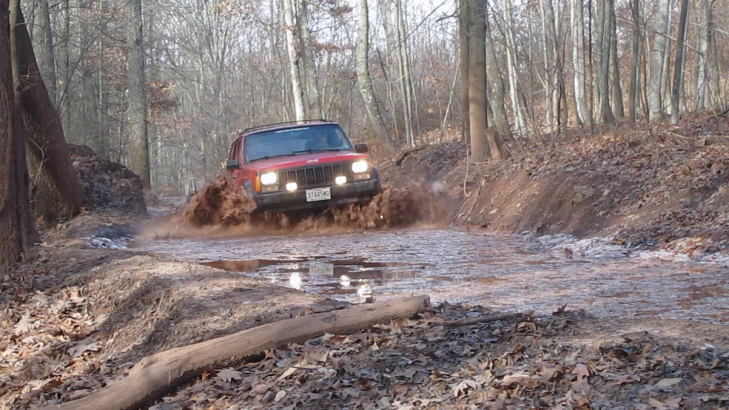

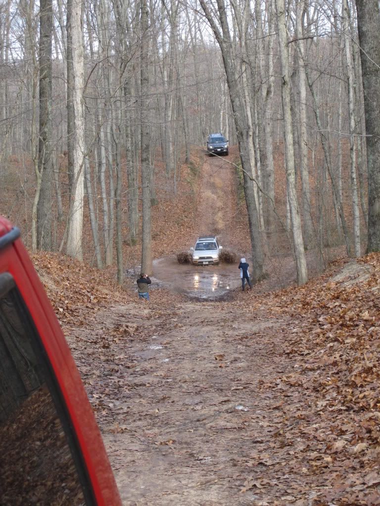

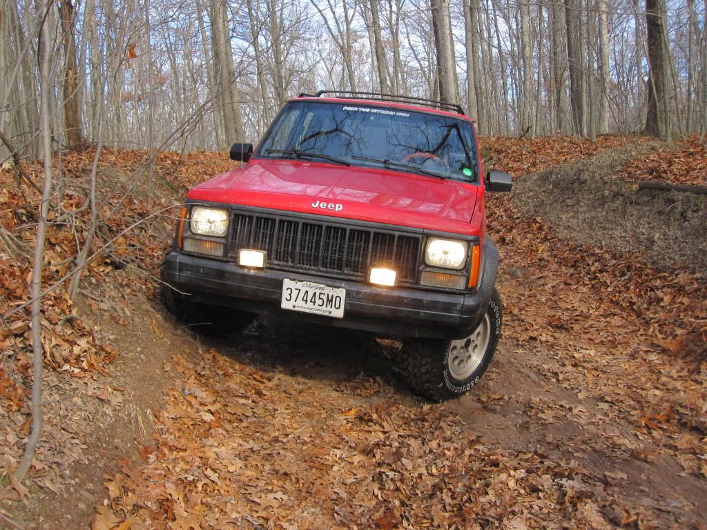

Went wheeling for my first time in mud (had previously gone in snow).
Green Ridge State Park ORV. Nothing crazy - some small rocks and a LOT of water - sooo glad I had that cowl snorkle
...didn't save my alternator though...RIP. Had to change it mid way back to my house...that sucked.

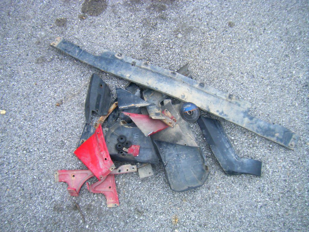

Got ambitious one day - borrowed an angle grinder, and then this happened
