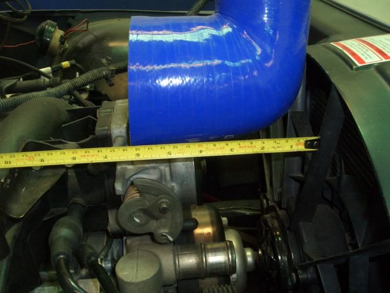

Here's the intake elbow I picked up for $20 on LS1tech.com:
As you can see, it was about 2" too big.
Measured how far I could shove it onto the intake manifold, and drew a line on the elbow and cut it down. Fits like a glove
Picked up the MAF from Advanced Auto and the couplers from the local hardware store. This so far has cost $200.

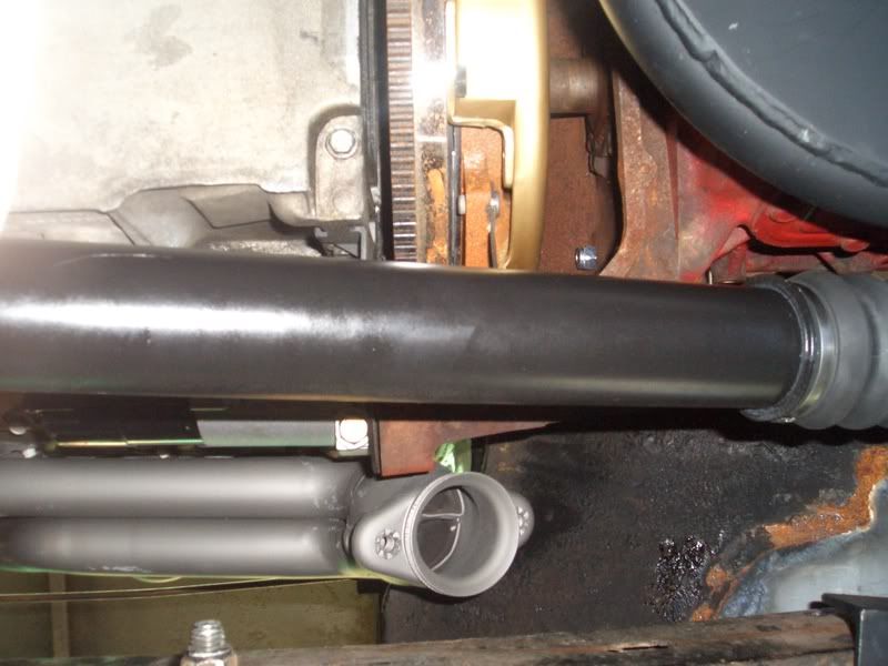

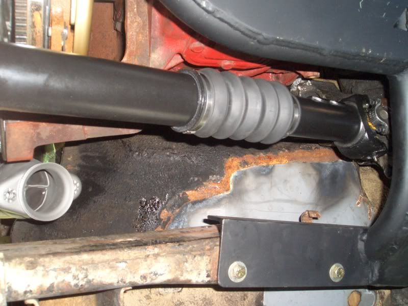

Got the front driveshaft in the mail. One of the bolts in the front axle yoke is busted inside. Gonna drill and tap it when I get it on the frame lift. It's kinda close to where I think the exhaust is gonna be. Think it'll melt the rubber boot? I can flip the driveshaft around so the boot is on the bottom, but I'd rather have the boot and slip joint up and protected by the skid / frame.

Wrap the exhaust with the high temp insulating tape. It will keep the temperature low enough to not melt the boot.
