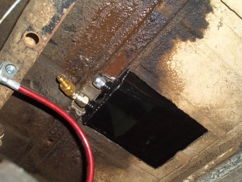

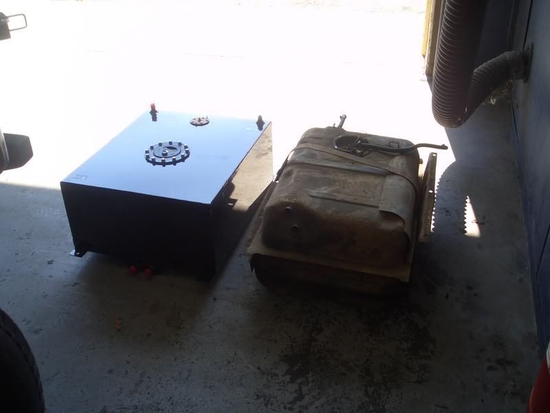

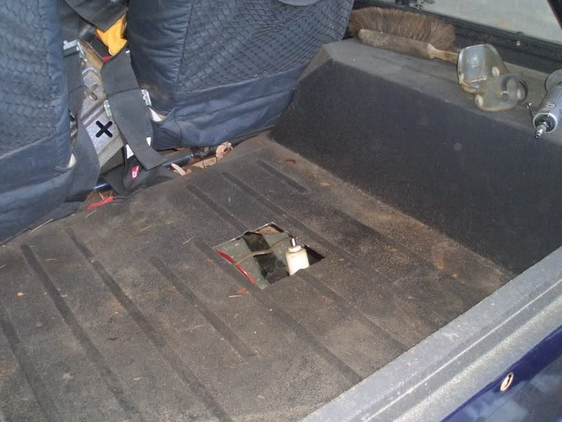

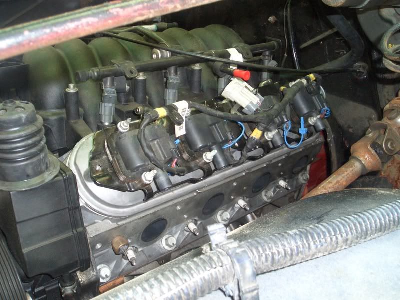

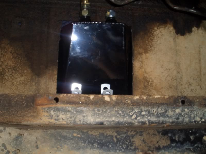

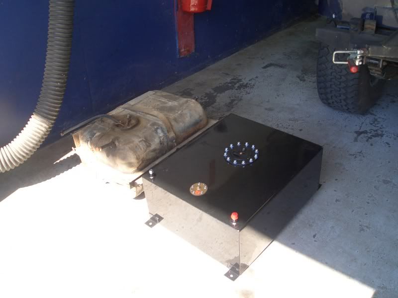

This past weekend I did some cutting. Got rid of the old tank and mocked up the fuel cell. Had to cut a hole in the sheet for the sump. I'll mount it inbetween the frame rails later on when I have more of the two things I'm short on right now.

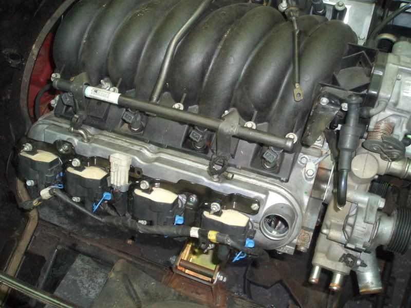

Also, finally got my valve covers in the mail. Now I'm able to mount my coil packs. I'm glad I waited for these because I think this looks waaaay better than using a relocation kit. And that junk is expensive. This actually put money back in my pocket by selling the aftermarket covers.

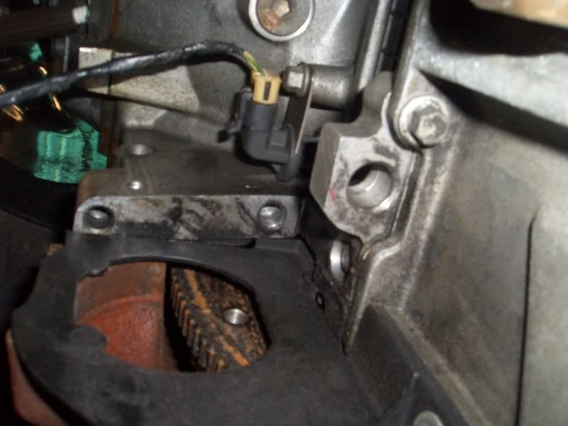

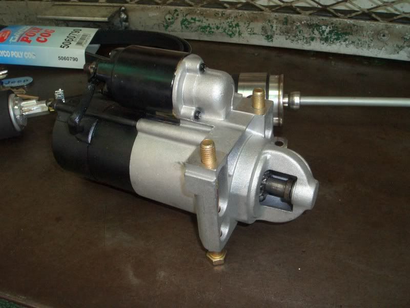

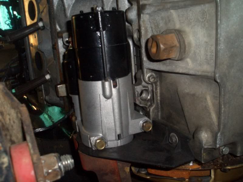

See the square peg with a hole in the center coming off the block right infront of the starter hole? It was in the way.
So instead of breaking my block I decided to break the starter.
Fits now.

Gonna have to move the fuel cell forward an inch or two. But I got it in. I'll figure out exact placement in the next few days.

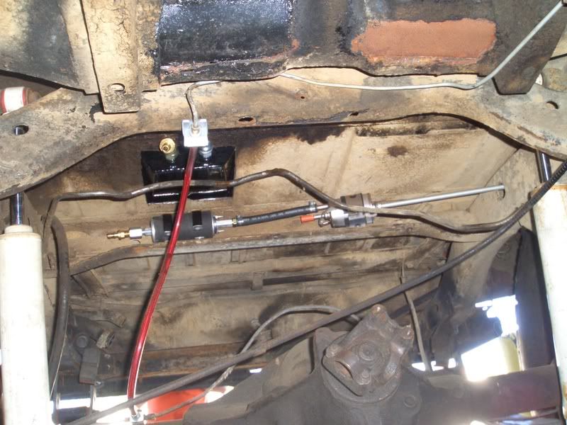

What do you guys think of this spot for the fuel pump / regulator? I really can't figure out a better spot. I would love to put it along the frame rail, but I'm pretty positive the exhaust tubes will take up all of that space.
Gonna have to fab up something to make it bolt in there. Hell might keep the tub together longer.

Eddie what do you think about that spot for the pump / filter? Think they will be safe from gobs of u-joint grease? And especially road debris. This will be driven to and from the trail head.

Field replacement might be a PITA but I think the stuff will be well protected there.

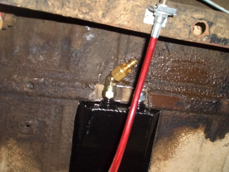

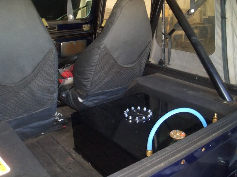

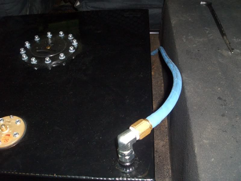

Knocked out the fuel system today / yesterday.
This one is for you, Glenn.... Hehehe

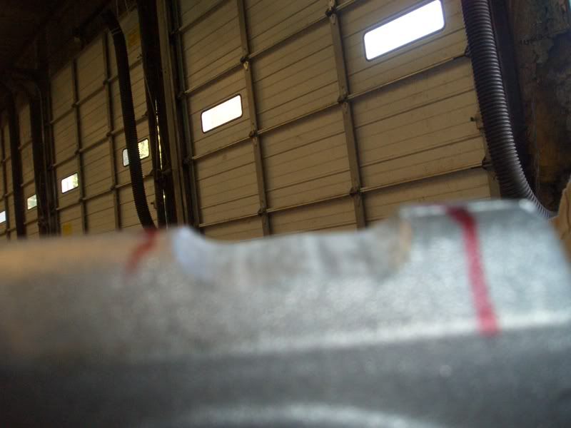

Couldn't keep it as close to the tailgate as I wanted to...
Here's the reason why. There's about a 4" sealed space between the back of the tub and where this lip is underneath.
Same deal on the side
Good thing I'm never putting a backseat in again

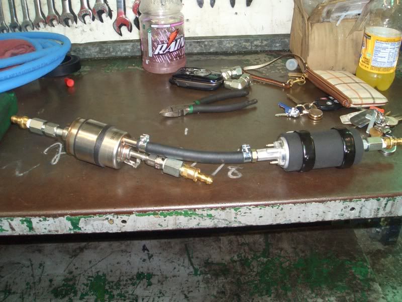

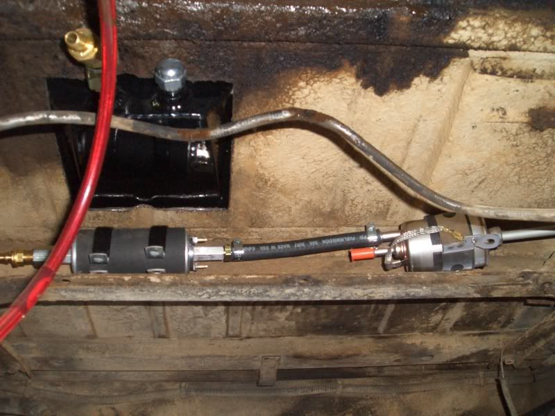

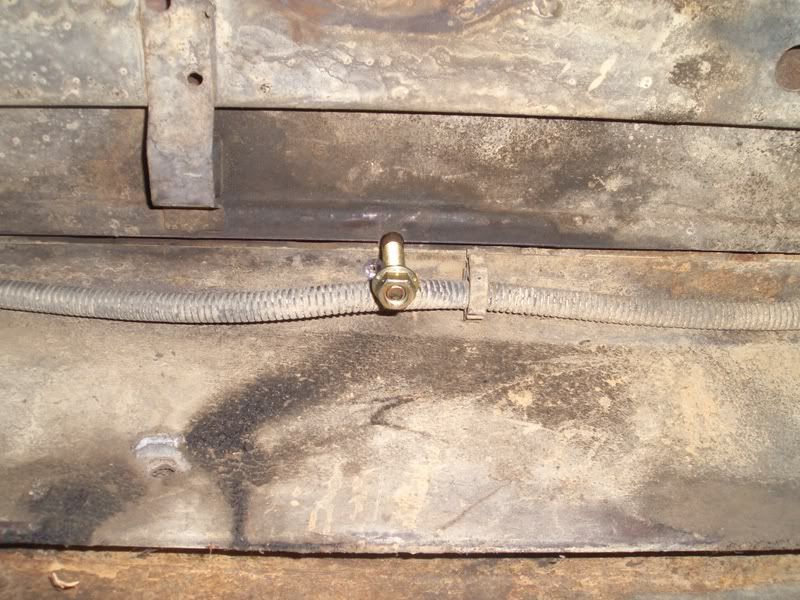

Picked a different spot for the pump / filter. I hope I never have to do a trail repair on this mofo! Would be a PITA to get to. Right on the driver side frame rail. Hopefully the exhaust won't be too close to it.

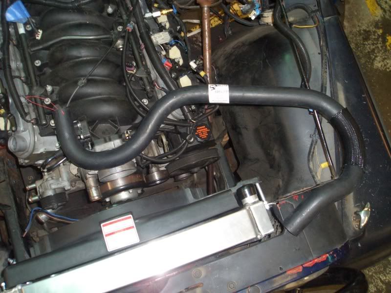

Radiator hoses are a bit long.... But looks like they should fit. All I have to do now is to actually get them on. Another PITA chore.

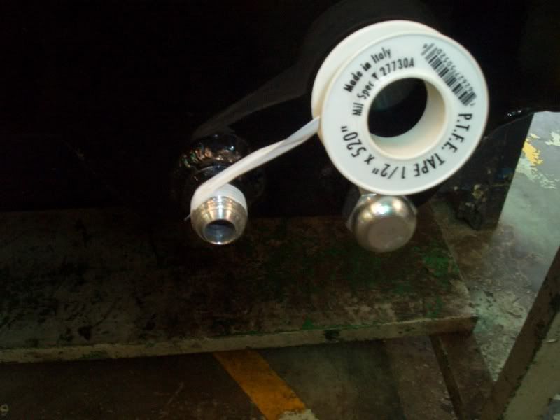

Just FYI for future reference, but you're spinning that Teflon wrong. You're going the right direction with the tape, but flip the spool over so that it feeds out from the bottom; as the spool spins on your finger you can apply a nice even pressure with your thumb and keep the tape tight on the threads, vs. feeding it out from the top where you have to hold the tape itself or keep stopping the spool in order to keep the pressure even.

Heh. So there is a trick to it. It stuck to the threads decently well, but like you said I had a hard time spinning it and keeping it on there. Thanks

Another suggestion on the teflon tape... ditch it and get some teflon paste and you'll never have to worry about it.

Those AN fittings are flared right? If so, you shouldn't use teflon on them at all. You rely on the seal at the flare.
I completely missed that and you are dead on. AN = no teflon. Good catch.
