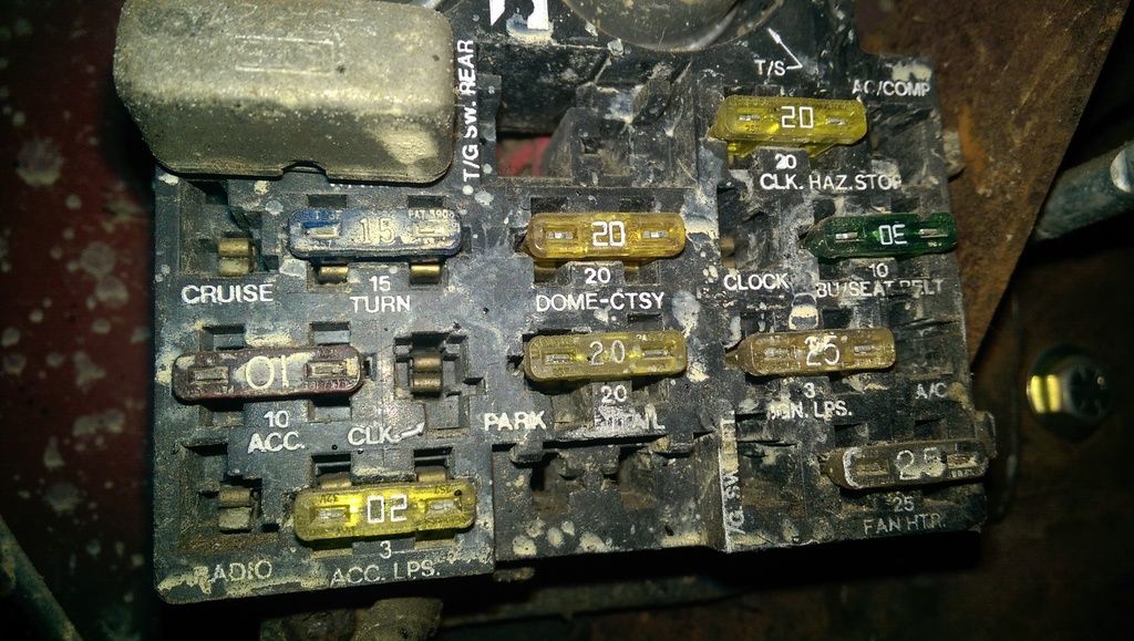

Spent some time going over wires today. Got my headlights working! My running lights front and rear light up, but no turn flashing or brake lights. Also I'm only getting 10 volts from the firewall to the starter. 12.5v coming in through the connector, but only 10 out. I'm thinking I'll have to take apart the steering column and chase some wires inside it. Not looking forward to that.
