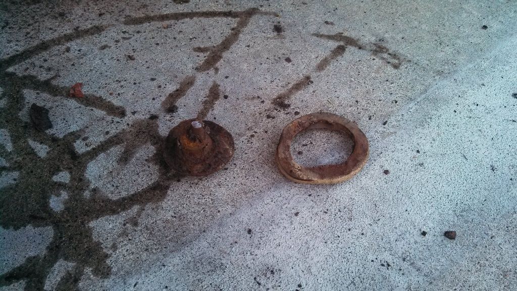

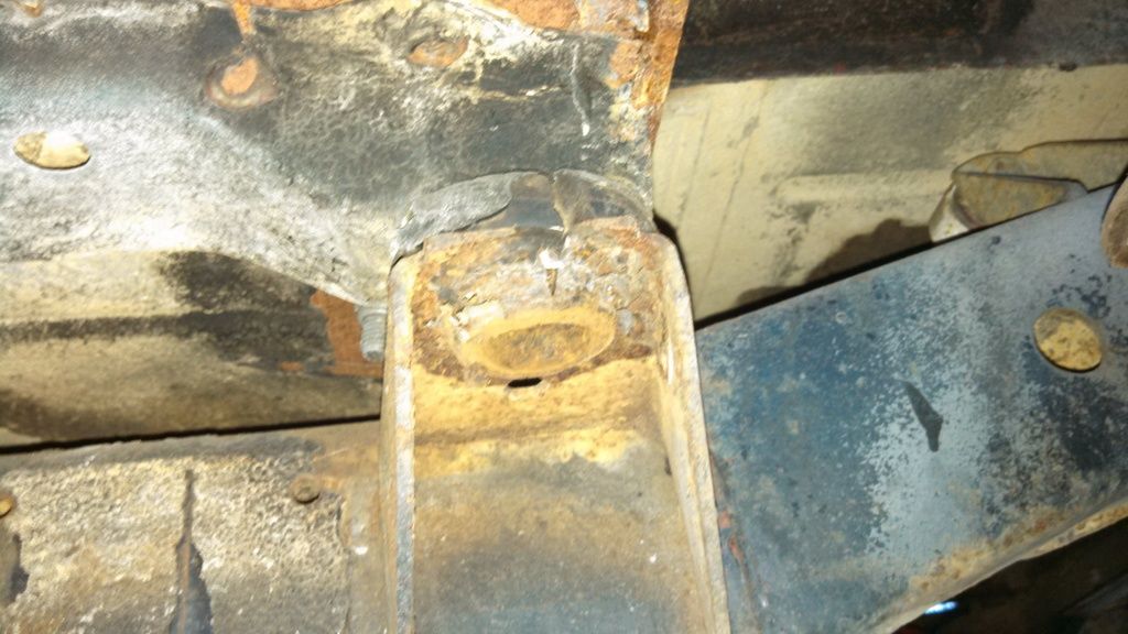

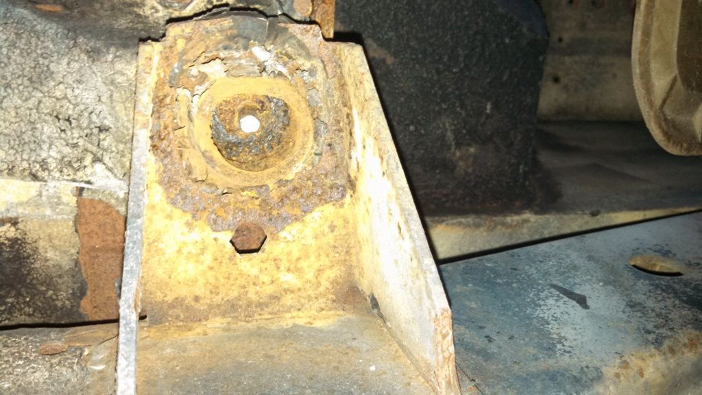

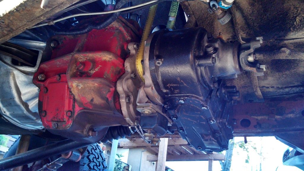

Got the D300 rebuilt and back inside the Jeep yesterday / today. Buttoned it all up and ready to take it on a test drive tomorrow once the sun comes up.
While I was down there, I couldn't help but notice how much rust was dripping into my eyes. So I found the source of it.
Looks like I'll be shopping for some body mount bushings, and at least 1 new bracket.
