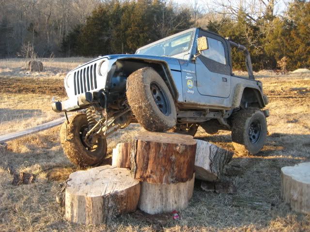

fenders on, manifold replaced, hood pins installed... gonna wait to put the rockers on till the rears are installed but they are also cleared and ready to go.
flexed it out on some big stumps out by my place
not quite full bump... but darn close
time to get bigger tires...

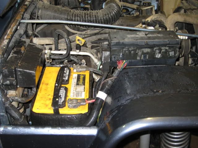

under hood relocation again

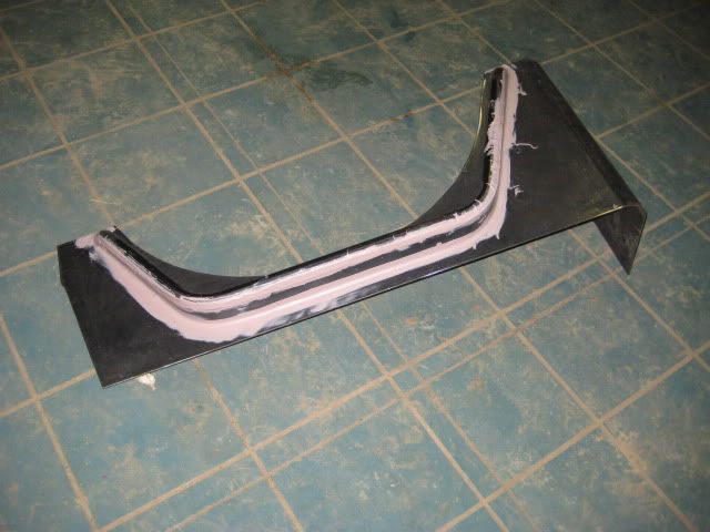

and the rears skinned and bondoed

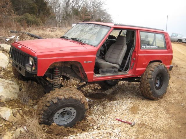

we finally got my buddys jeep driveable... weve been building this since sept. this was in 2wd (no front ds) so not even close to flexed to its full potential
96 XJ 38s HP44/FF60 Coil conversion rear w/ triangulated 4 link/ 3 link front
little better flex here

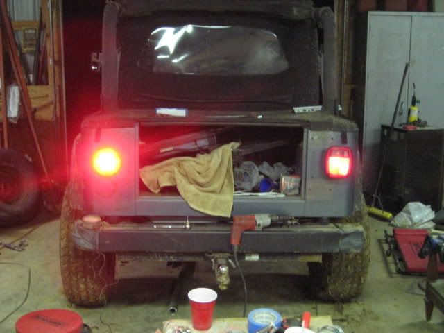

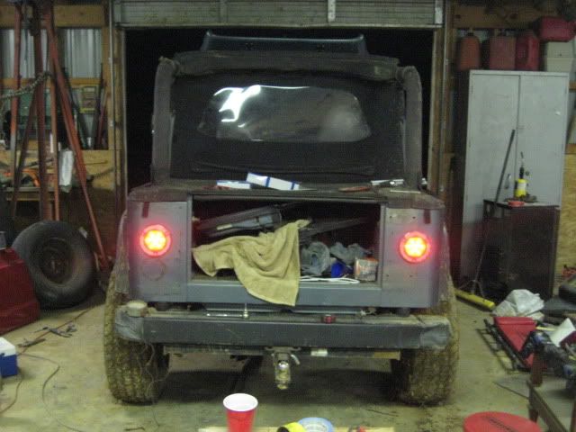

So, sorry Ive been slacking, theyve uped my ours at work (local fab shop) and by the time i get home im tired of fabricating lol so ive been slacking pretty hard. But last night i wanted to go something and was tired of sanding bondo so i decided to install my LED Tailights.
Brake light diff over stock
Reverse light over stock
the reverse lights are crazy bright! the difference when backing it the dark is literally night and day!

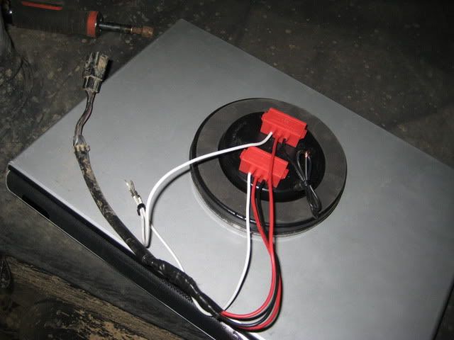

Heres a pic of the plug. The stock case is grounded so i have to run a seperate ground but the rest of the wires were spliced into the factory plug. i just cut the old plug off the stock light.
So heres both installed
Tail lights
Brake lights
Reverse lights... almost look like head lights lol

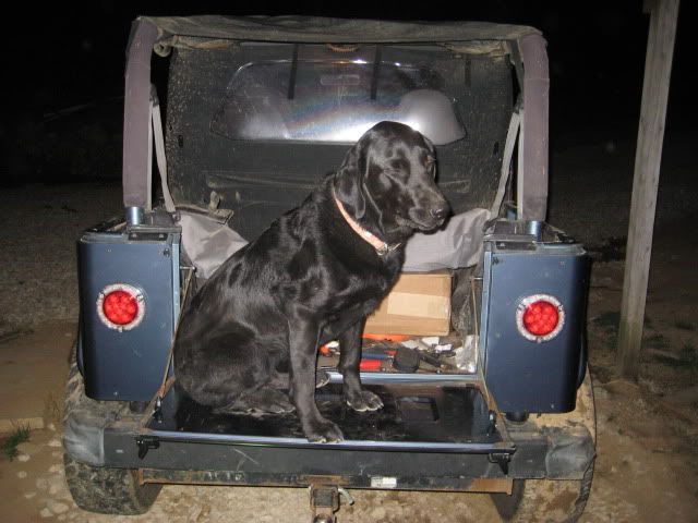

Got the corners and tailgate installed tonight!
Some more details on the latches i used...
Got'em off mcmaster, they are 200# rated draw latches
and another of the latch partially open
with the weather strip on the duster cover... seals up super tight
gate down
drivers side fenders
pass side fenders
and a little load testing... my 100# lab puppy, Sid. I sat on it with her but thats kinda hard to take a pic of when youre by yourself.
