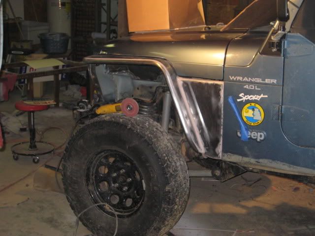

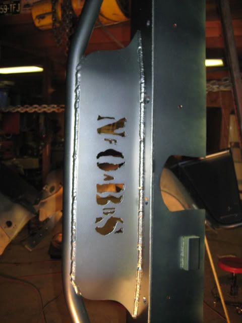

thanks, its been a lot more work than i anticipated, the whole hiline thing really throws a wrench in the whole inner fender configuration. i got the other side cut and my emissions and relay box mounted so now i just need to mount me sliders and trim them, then its finally ready for paint. as soon as the weather turns around anyways... looks like 20s and snow this week... not exactly ideal painting weather...

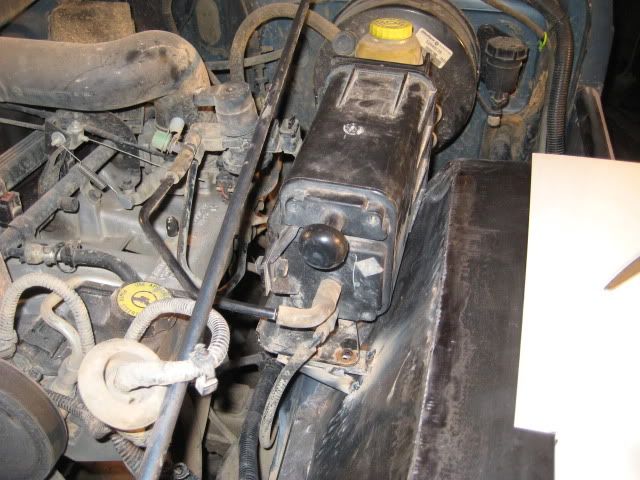

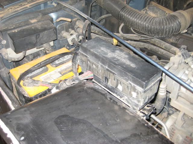

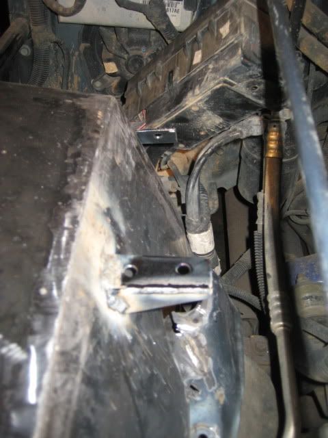

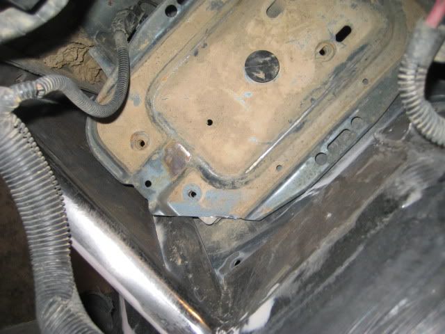

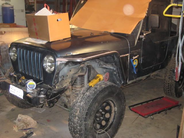

stuff i did over the weekend...
cut driver side
relocated the emissions and relay
trimmed battery box
nice when things work out... my horn will bolt right back up
heres a shot of the underhood... gonna have to do something about the windshield washer bottle...

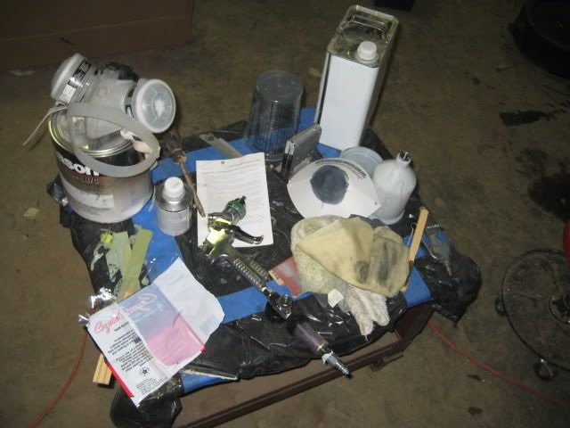

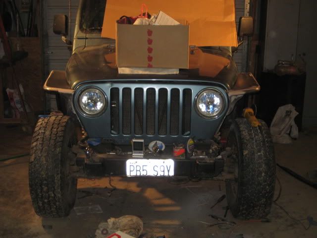

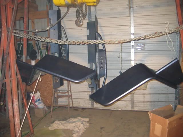

PAINT!!!!!!!!!!!! well, kinda... primer anyways...
Nick stealing the spot light from my handi work
pass side
looking down the edge... not too shabby for being a body work guy
also sprayed the rockers yesterday
needs one more coat of primer and then ill start color.
Im having a weird issue so hopefully someone on here has some exp w/ spraying....
I have a filter then dryer then 3/8 line to a regulator attached to my gun. I have a HUGE pressure drop coming out of my dryer... like from 125 psi to ~60 psi. not a big deal because i need to spray between 40-60 psi. but my regulator isnt really regulating... pressure builds to about 100 psi and then once i spray it goes down to about 25 psi. no matter if the regulator is open fully or not.
the issue is i can only spray in burst of about 12 inches then i have to wait. its a brand new regulator, dryer, and filter... im gonna put another reg on but i also dont understand why im getting such a pressure drop over the dryer... anybody got any advice?

color!!! they still need another coat or two and then cleared but im almost done!
