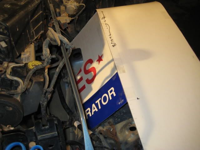

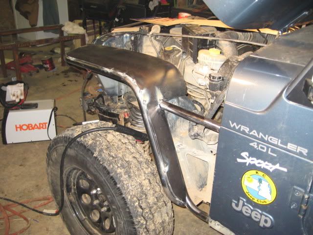

got some more done today,

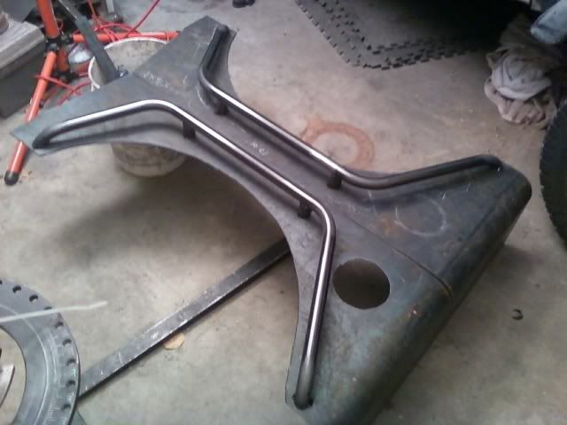

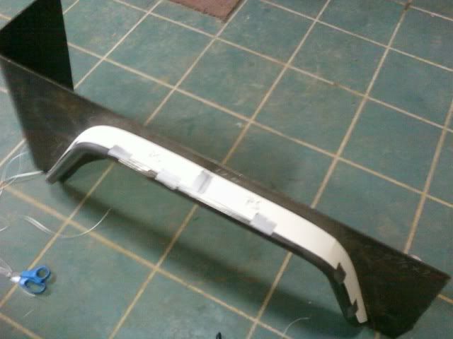

and because I seem to like making my life difficult just to add a little "flare" (pun intended) when i build stuff you can see i made the flare taper up from 2" up to 3", not a big diff but you can see in the pic its just one of those suttle things that added like 2 hrs to my fab time.
and my new tail lights came in today... BLING!

are you going to add sheet metal over the top

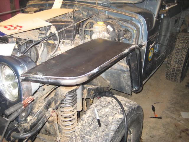

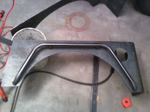

thanks, and yeah, the flares will get skins... i actually made he templates for them tonight

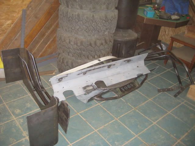

not much of an update but ive got a pile of parts starting and its getting a little out of hand... time to get back to work i guess...
newest additions to the pile... CJ tailgate, prepped for paint

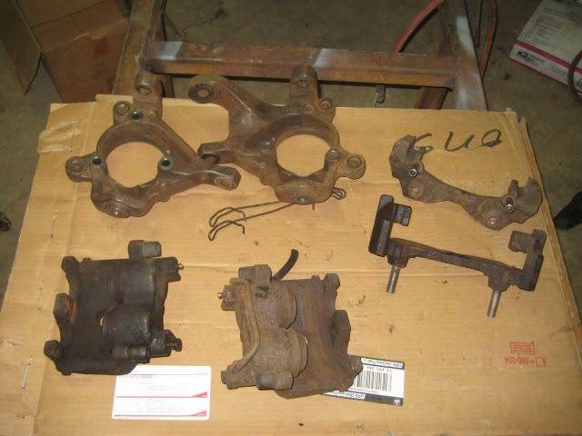

and the next big "functional" upgrade... WJ knuckels and brakes for crossover steering and biger calipers to stop the future 35s
and the old pile... in my living room... :roll:

corners look sick man i want to make some for myn now haha, how will they attach

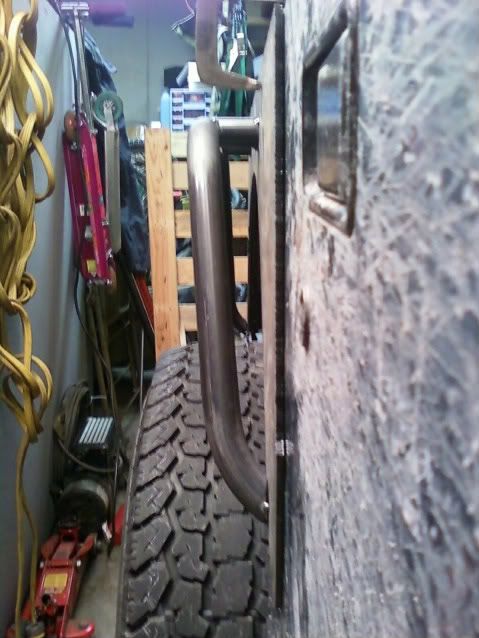

thanks every one, yes I am doing a drop down tail gate, its off an 84 CJ7. Just waiting on paint and the latches im going to try to use ao i can start putting it together.
Ya know ive worked there for 3 years and i dont think ive ever noticed that sign lol...
I have the same 1/4-20 stainless flat head cap screws that are used on my rockers to mount the corners.

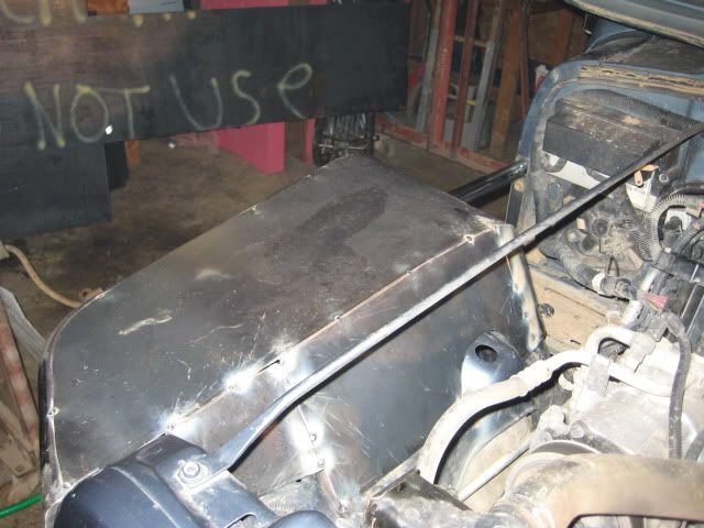

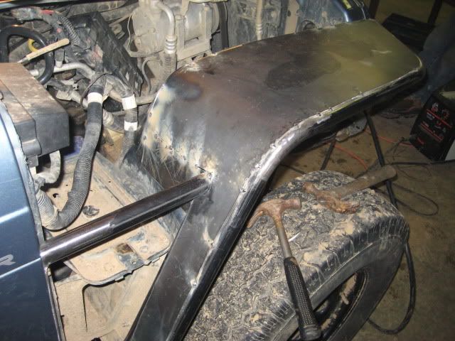

Getting closer...

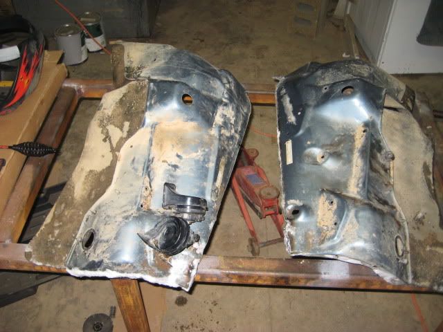

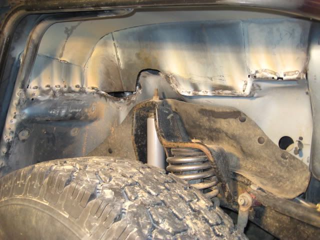

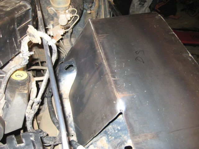

so the big issue weve been dealing with is making the inner fender, the high bend instead of goin straight back makes thing interesting
we decided the best thing to do was use as much of the original inner as possible
next, we bolted them both up and connected the old inner and the outer skin.
then, its off to the plasma and losts of grinding and tacking later...
and a fun little shot from standing on the roll cage... hood still isnt cut, and Siddy was not very happy about me being up so high lol...
cgmrdc is offline
post #71 of 392 Old 01-31-2010, 05:32 PM Thread Starter
cgmrdc
1988 MJ Comanche
Location: Denton
Posts: 909

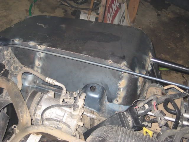

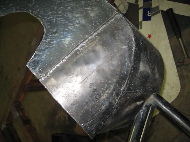

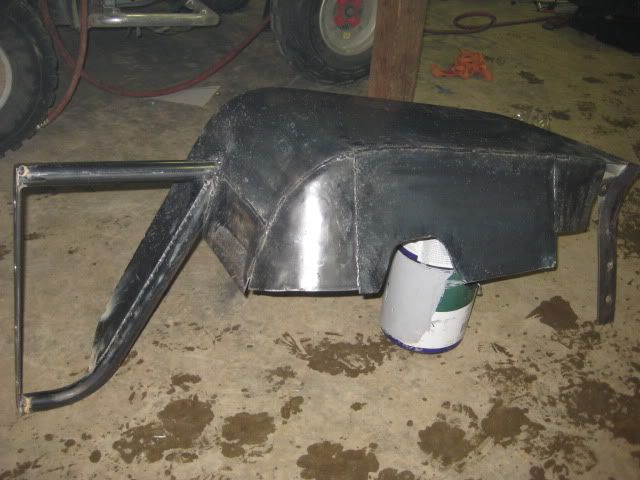

Me and nick got quite bit done today, all the inner fender peices are done. next is just pull it off, trim the stock inners and weldem together... then paint! Nick did some sweet forming on a couple peices to match the radius of the stock inners

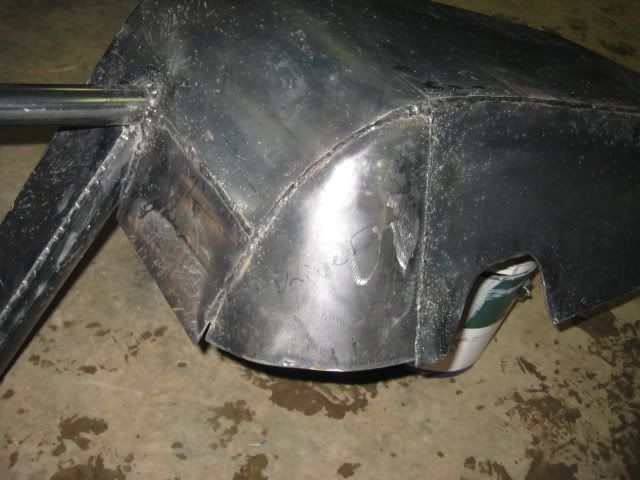

save the hardest for last... they actually werent too bad, just a roofing hammer and the edge of the welding table later...
Driver (Mine):
Passenger (Nick's):
all thats left is to cut and reattach the little bit from the stock inner to be used and attach the side panel, but here is whats been actually fabbed, ready to clean up and prep for paint

thats pretty sweet I like how you rounded the corners in on the wells. Jeeps lookin good! I'm subcribed!

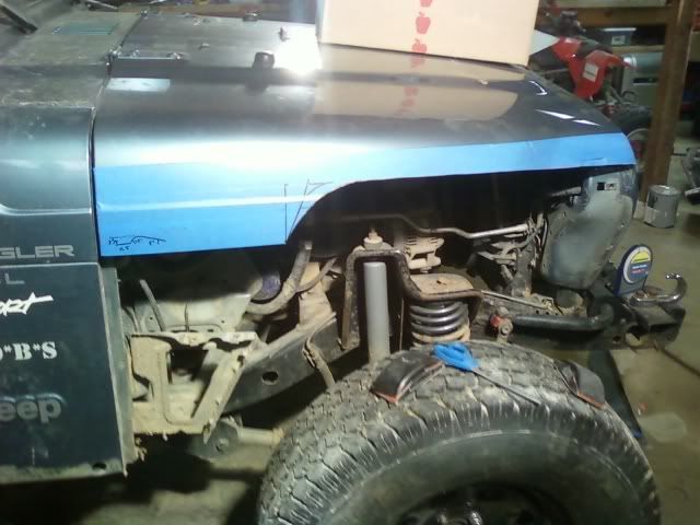

here ya go guys...
so my land lord was hangin out in the garage with me so i thought id let him contribute a little... oops... aparently following a line with a sawsall is a harder task then i thought... and so is griding the paint of around the edges... he broke one blade and destroyed the backing plate for my grinder discs... so the hole in the corner is the only thing i couldnt salvage with his hack job so i need to patch it but other than that the are ready to prep for paint.

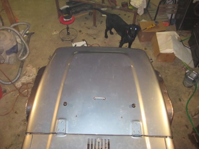

got the hood cut for the passenger side today!
I need to trim a little in this pic so the hoods sits a little closer now.
about the same coverage as a stock flare...
and here was when i was marking it out... can you say pain in the butt...
