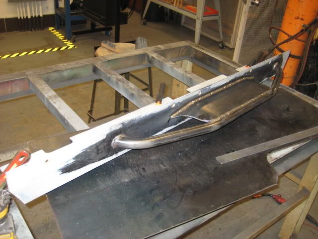

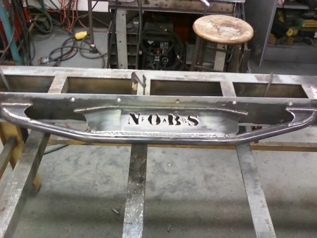

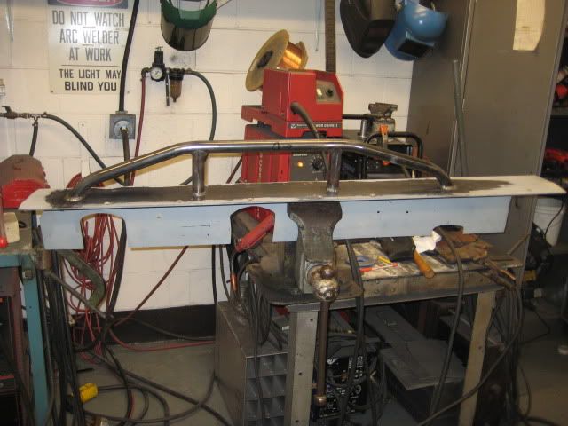

finally got some more work done...
the step
still need to cut and weld the corner "gussets" and plasma the "NOBS" out of the step... and then do it all again to the other side lol

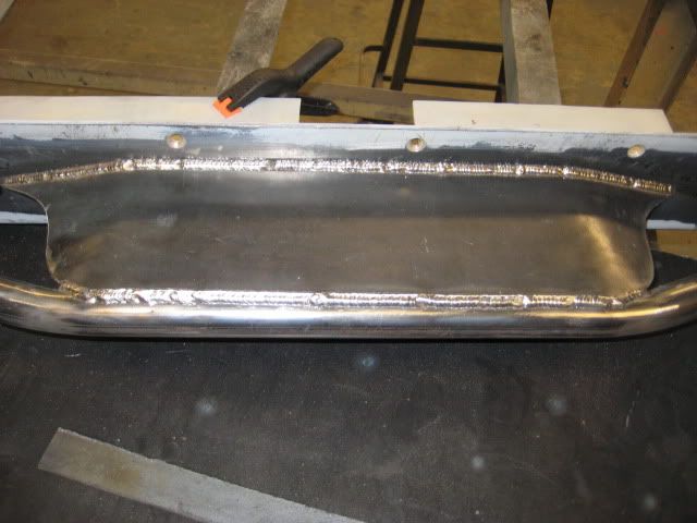

all fab is done on the drivers side!!!
and the now the pièce de résistance...
now its just wait till its warm enough to get these painted and done with!
Also my gf ordered my xmas present today! Set of full corner blanks!!! so it looks like over xmas break its time for hiline fenders front and rear!!!!!!!!! the TJ is really starting to get the look Im going for...

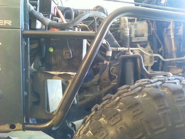

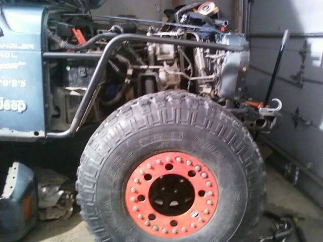

FINALLY, we got to work on my jeep, the snow has killed my fab time this week... anyways, a guy in my club bought some 36s locally and let me borrow them to open up my wheel wells since i plan on going up to those this summer.
so first we started by figuring out how much we needed to trim off the wheel well. we flexed it out on some snow... only good thing its done for us...
so the trimming...
Before
During
After
then we marked the corner gaurds and took them to a buddies shop and plasma'd the wheel well, door opening and gas cap
also, we pulled the fenders off mine and put the hilines we are working on for another guy just to see how they look on mine 8).
we are starting on mine in the morning
also quick pic of my jeep on 36s :twisted:

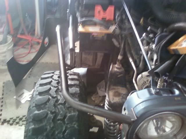

cgmrdc
1988 MJ Comanche
Location: Denton
Posts: 909
tubes bent and tacked, not gonna skin it till i get to school. also ran out of tube so i didnt get to do the rears. Ill get more in the morning and finish those tomorrow.
sorry for the cell phone pics, my gf took the camera to north carolina...
a tube was added to tie the flare into the main tube dont worry
