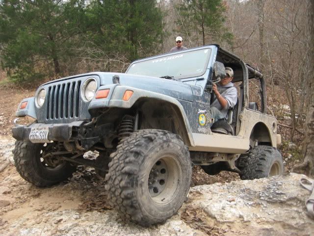

this was the second day there on v-notch. I made it the first day but i rained/snowed that night and was a lot wetter the next day... this was before I installed my locker so i couldnt drive out

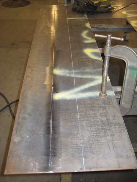

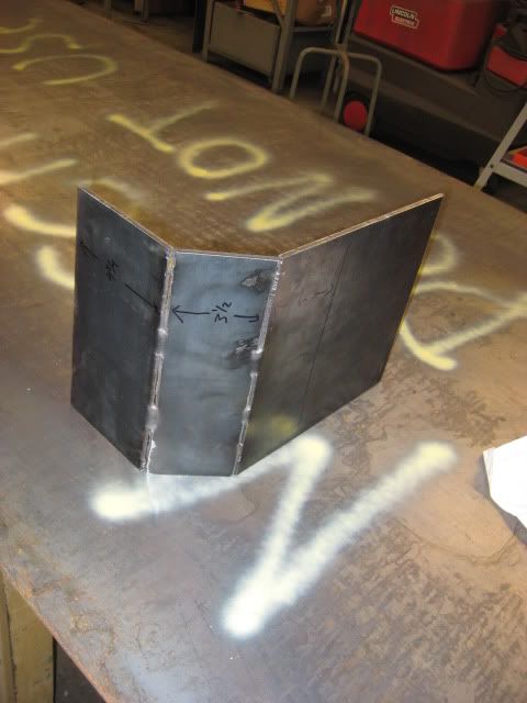

the template

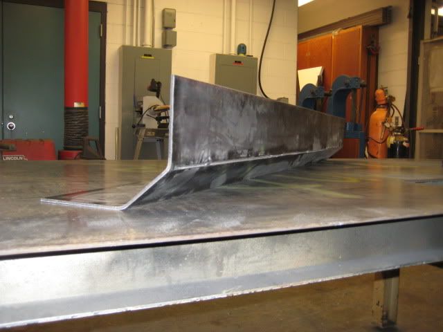

clearancing... so much for haveing straight rockers...this was the hardest part
once i bent the template to the correct angles i cut the full rocker out. I
cut it leaving 4-1 inch sections left so i could beind it

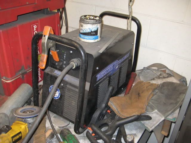

the torch

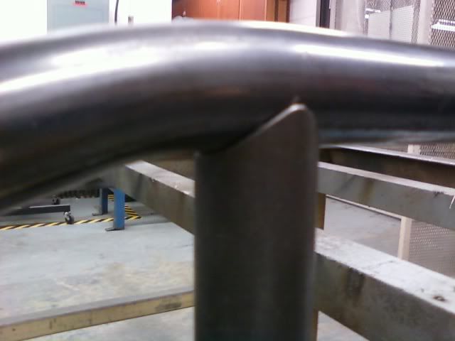

got the sliders on for a test run to flat nasty this weekend. The clearance difference between these and my old tube steps is unreal! i actually had to purposefully drive over a rock to get them to hit just so i could see how they held up, and that was the only time i touched them all weekend... but now the lowest point is the body mounts so im gonna fab up some skids for those too
backing plates on the sides are 2x1/4 stainless strips, floor is 2x1/4 mild...
10 stainless counter sunk bolts per side for a nice smooth surface.
now that wheelin season is over....... im gonna pull these off, stripem back down, weld the tubes on, clean up some of the grinder marks and ill paint it gunmetal to be the same color as the TJ

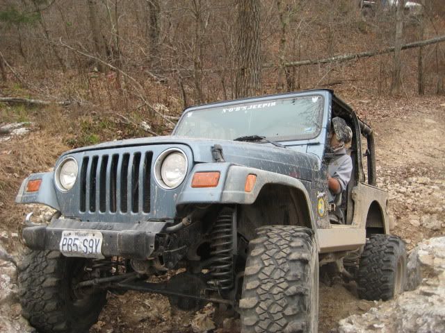

Attempt number 15 on the hill entrance to proving grounds... my rear diff kept getting hung up... i have 15 pics of me going a little further up the hill each time "OK Nick, last attempt and then im done will this stupid hill"... actually made it up
