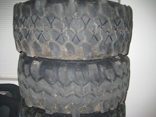

and on to fixing the tire flex issue... i borrowed a groving iron (thanks glen!) today and after doing lots of reading on pros/cons i got to cutting
first cut... like butter
i did two angled cuts, per Glens recomendations, and removed most of the center wear bar
on top of an uncut tsl
i only had time to do one tonight but it look about 40 min... i suspect i will have that down below 30 on the next 3...

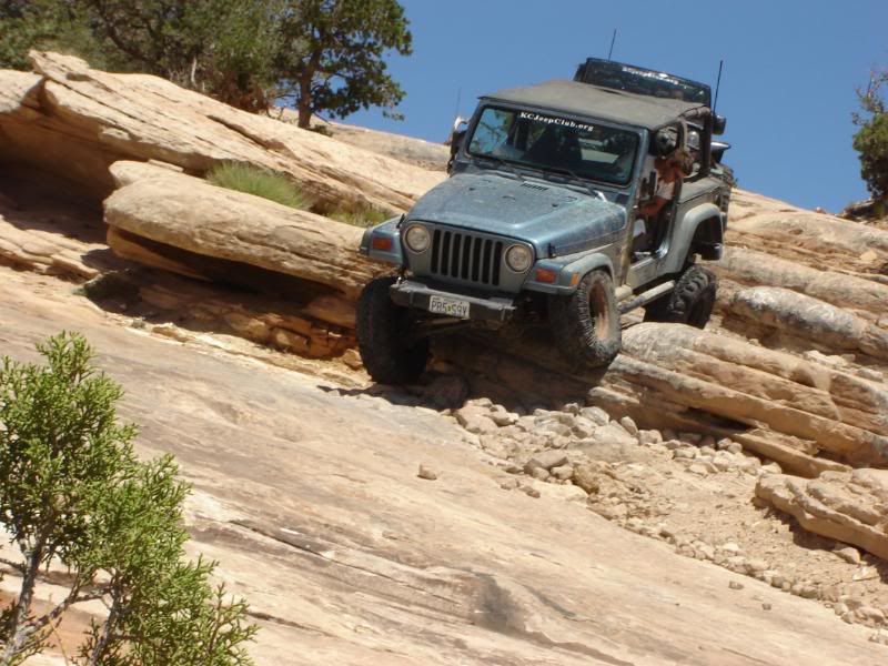

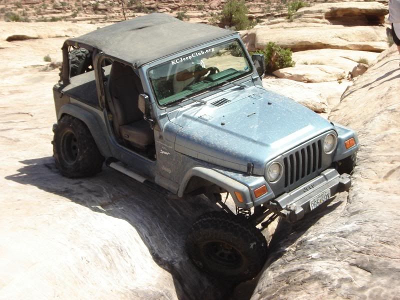

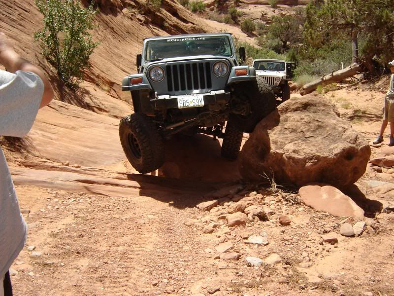

After i finished those it was time to head to CO and Moab for a week!
bent track bar trail fix... highlift jack handle...
this doesnt do it justice but that wall was prob 10+ ft tall!
me not making it up escilator
sweet flex! 8)
the crack

you may notice a tire change between CO and moab... i blew out a side wall going through vail pass and had to run my bald mts up front :cry: which i think contributed greatly to me not making it up escilator... so now do i buy two more 33s or save up and buy 4 35s :twisted:
over all im super happy with how my jeep did. the LCG had a huge impact on almost every obsticle! there were times i could walk up when others would bounce and/or pull a tire :wink:

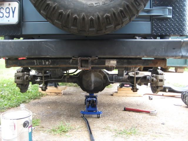

I also got new coils!
as you can see... my rear springs were shot! the old were 2.5 in sky jackers and the new are rough countrys new progressive rate 2.5 in springs

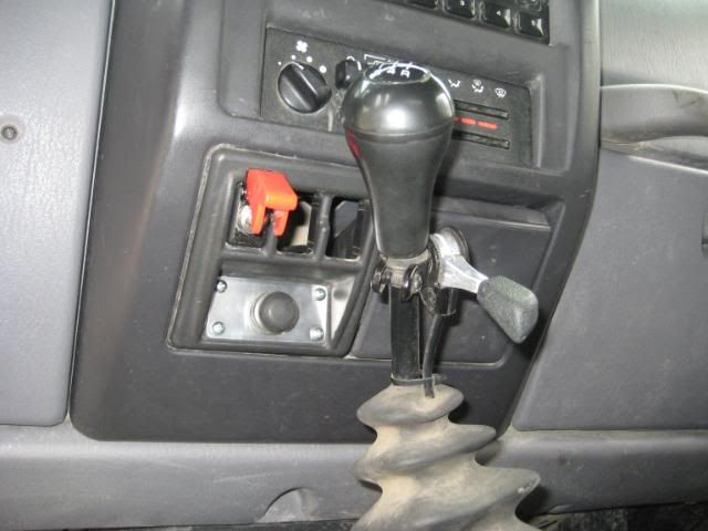

My jeep was stolen and returned in Feb 09 but they destoyed my lock cyl so...

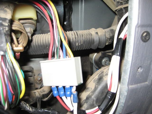

I installed a push button start and some other stuff...
trying to find a good ground for ignition... actually the most comfortable position i could get in...
ill get more pics tom when i finish putting all the trim back on

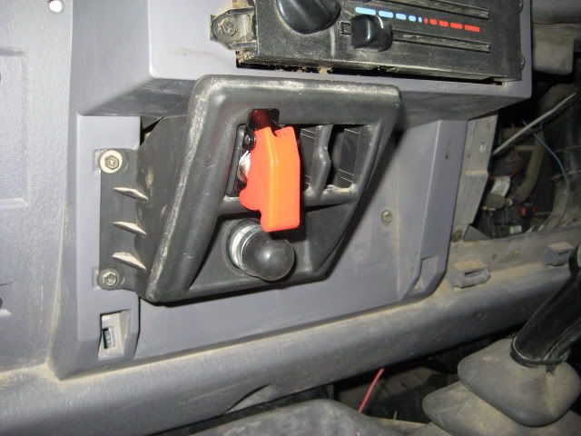

i did this by a single paragraph "this is kinda how i did it from what i remember" so its not too hard once you figure out what all the wires do...
this is the ignition connector that plugs into the lock cylinder, i dont know what the ones with the chips look like or how they work, also as you can see i didnt repin to every wire, i cant figure out some of them and i dont have a fsm to give me a pin out... but so far everything works :roll:
also bc my jeep was broken into and the lock cylinder was destoyed i no longer have a steering wheel lock, for those who do this unless you take apart the steerind column and remove the lock you will still have to put the key in.

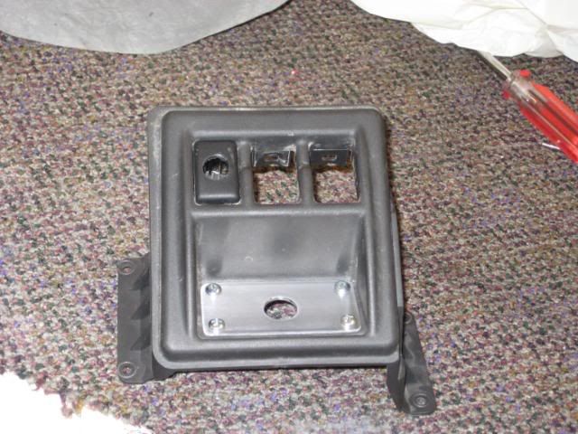

some final install pics
made a peice of brushed stainless to supprt the push button
over all
jeep off
jeep on
as you can see i pulled the other switch fillers out... some trial and ERROR messed up the other too... so if anyone has some theyd like to let go let me know so i can wire up my acc switch...

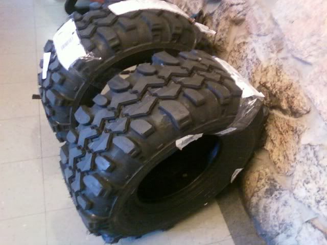

brown santa came today and dropped off some new rubber!!!!!
man thats some deep tread!
these with be replacing this
thats what happens when you run an ltb with no air pressure through Vail pass at 12am :roll:
