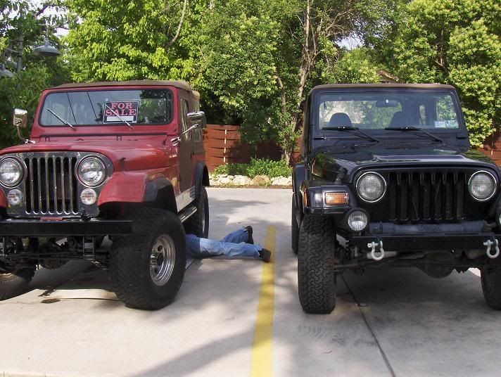

Originally Posted by Hal The Killer
congrats on the old jeep! its beautiful!
i still would like to get that cj i was looking at but the guy still refuses to bring down the price.
That's cuz it comes with a pair of legs.

that was just the guy he hit on the way over
