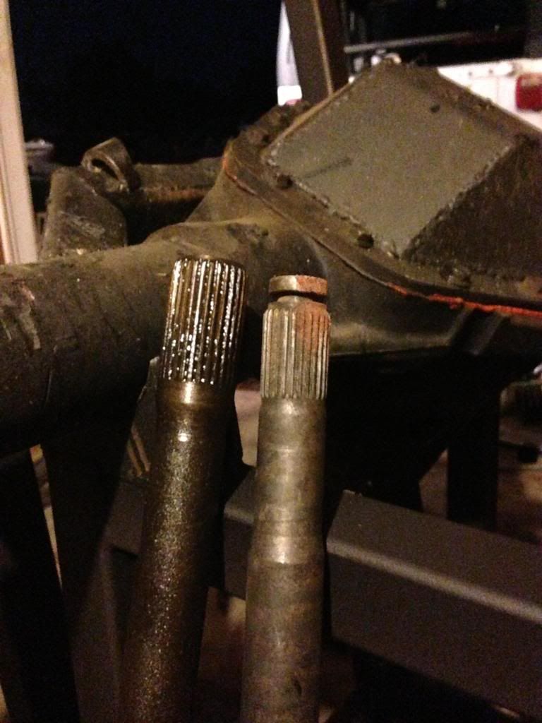

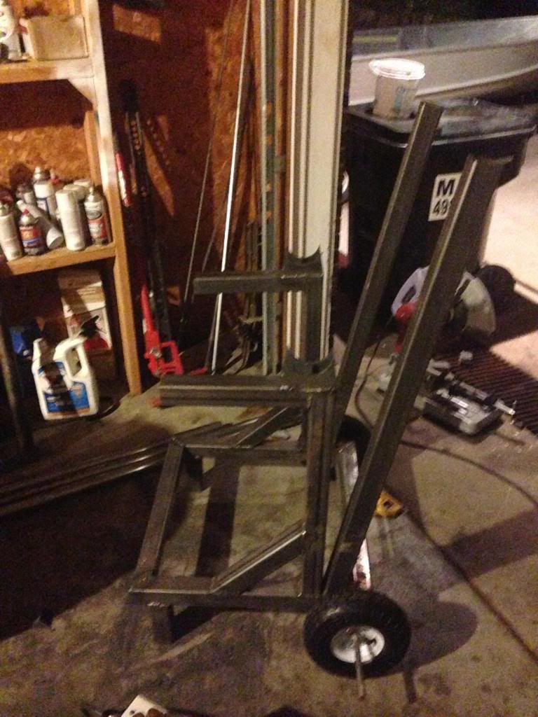

I have gotten sick of tearing apart axles on the ground and lifting them up on jack stands. I've dropped my axle twice now off of the stands and it just sucks, so I made an axle dolly. The steel is 2x2x1/8, I sketched up a few mounts on AutoCad for the axle for the dolly and the actual axle retainer for the 14 bolt.
I marvel every time i see the different between a 14 bolt and a dana 35
My wife got be this the other day for my birthday
I'm taking another step back in this build to redo all the mounts. I never thought it would come to this as i have tried to keep this under some budget, but as more people bring their rigs over for me to tinker on, i see that there is a small potential for at least a side income. I realize that plated leaf spring mounts arent as pretty has other mounts so lets see if I can make this a little more professional looking.
