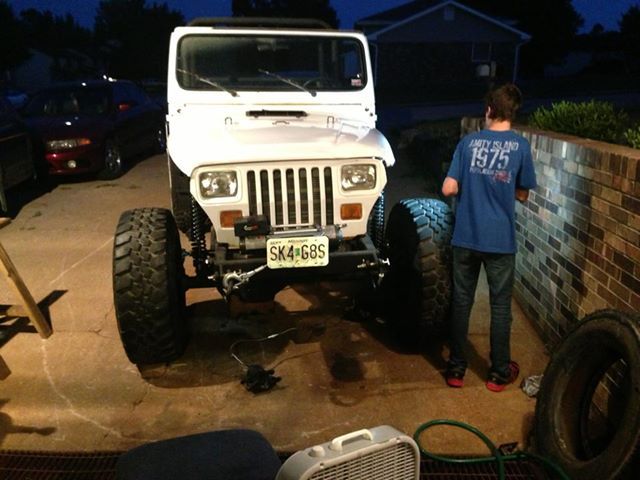

Wow, been gone so long that I had to re read my thread. since last time i got on, I've finished the 5.3 and started it up, the only issue was that i didn't have the computer grounded properly, once that was fixed, it started with a rawr. I decided to cut all the brackets off my ten bolt and install coil overs, it will be a little bit before i do the same to the rear, im anxious to drive it. I cut my cage apart to have it done better by Scott from hellorado customs when im ready. here are some pictures.

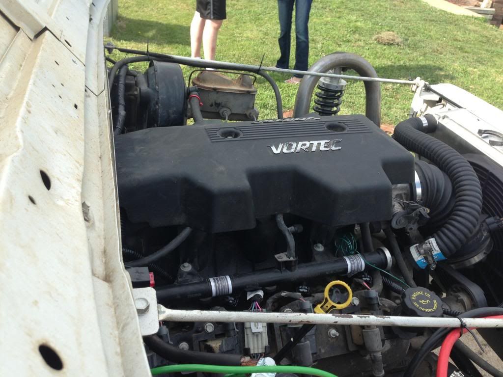

But on to betty, Here is her engine, I'll try to get a better picture of the wiring later, it honestly looks pretty stockish I think .

Your hood closes with the cover on the engine? Mine won't quite fit, but oil pan clearance was more important.

Yes, and I have about an inch of gap too.
I have plenty of oil plan clearance.
I modified the front half of frame to push steering box forward and raise grill up, and I used gen rights body mount lift to raise the body mount positions.
