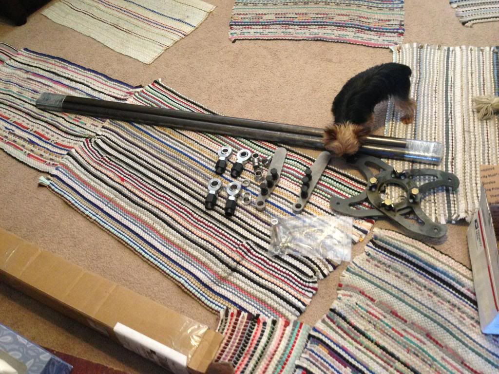

Presents from Ruff stuff and other various suppliers. Yes, those are the second set of brake brackets. Doing a hydraulic handbrake.
Still waiting on a bunch. Time to go cut some brackets.

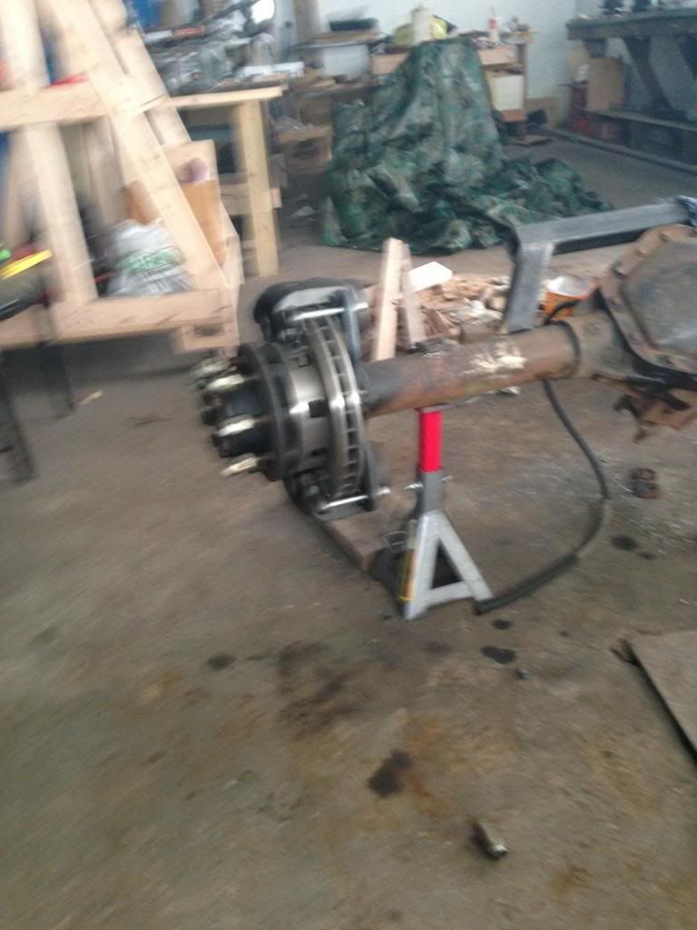

I'm hacking up a 14 bolt right now and I am about to order the disc brake set off ebay. Did you get the one from chevy_eater? If so how hard was it to assemble?

I got the one from Greatlakesoff road: you can find it here
http://www.ebay.com/itm/14-Bolt-Diff...127360&vxp=mtr
Unlike most other brackets, his isn't bent, he added spacers. I was able to take the drums off, and put on the complete brake system in about an hour and half. It was my first time doing it so im guessing its a pretty easy job.it also comes with the washers and bolts.
I literally just came back up from the shop from welding on the new calipers. All i did was cut the circle off of the brackets and weld on the arms to the bracket already on there.

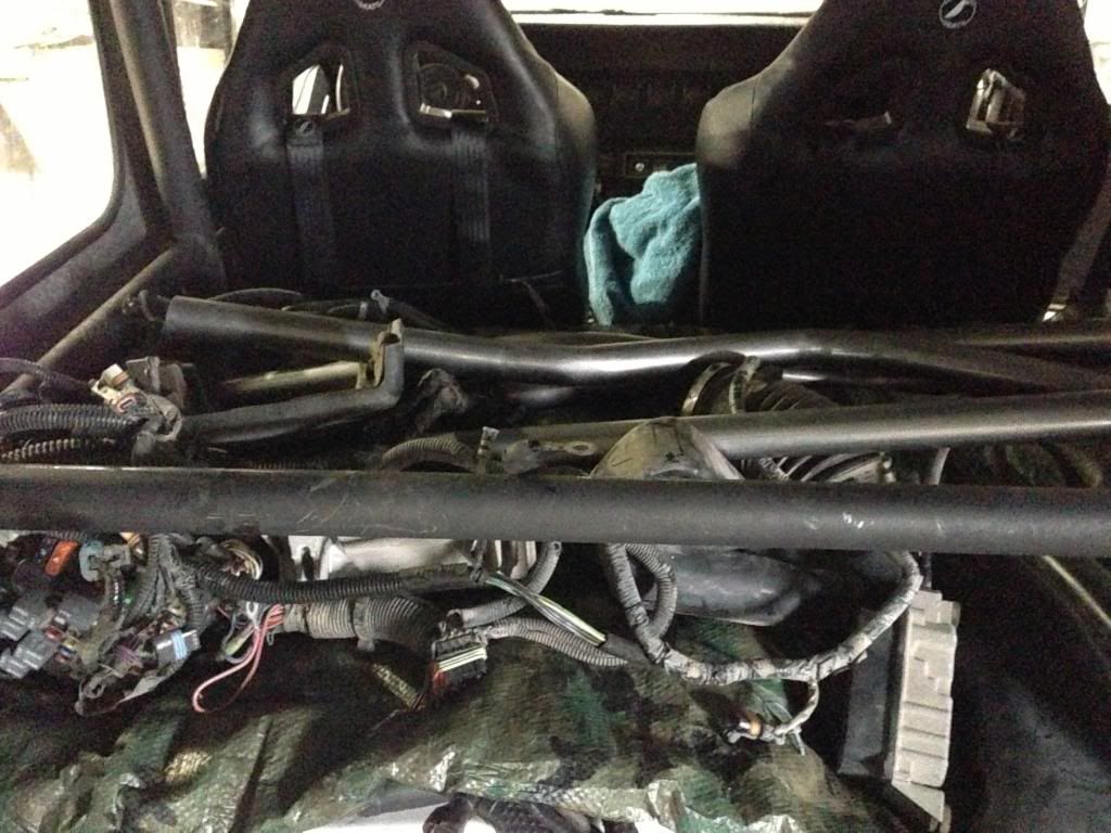

I got the front seats/harness in, and I made the 4 hour drive to West plains for my dad to bend some tubing for my cage. He couldn't make the 100* bend for the a pillar, so i'll have to weld in a pre bent tube piece.

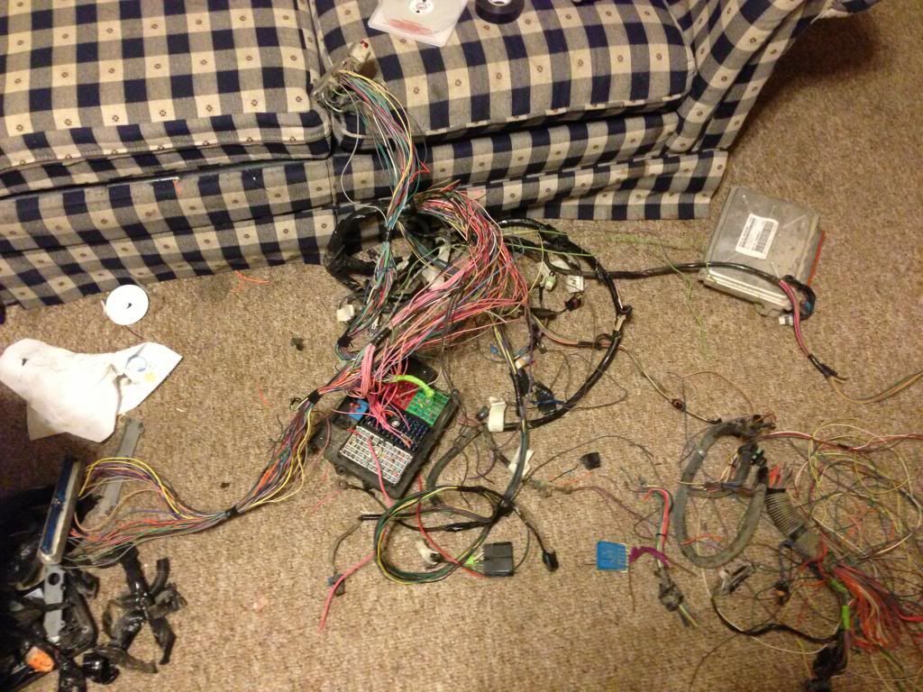

I also pulled out the 5.3 I bought and it's ready for me to pick it up. I didn't feel like pulling a trailer behind my 4 angry squirrels this weekend. I don't have any pictures of the weeks work except for what I hauled back this weekend. Bent tubing, and a wiring harness to play with.

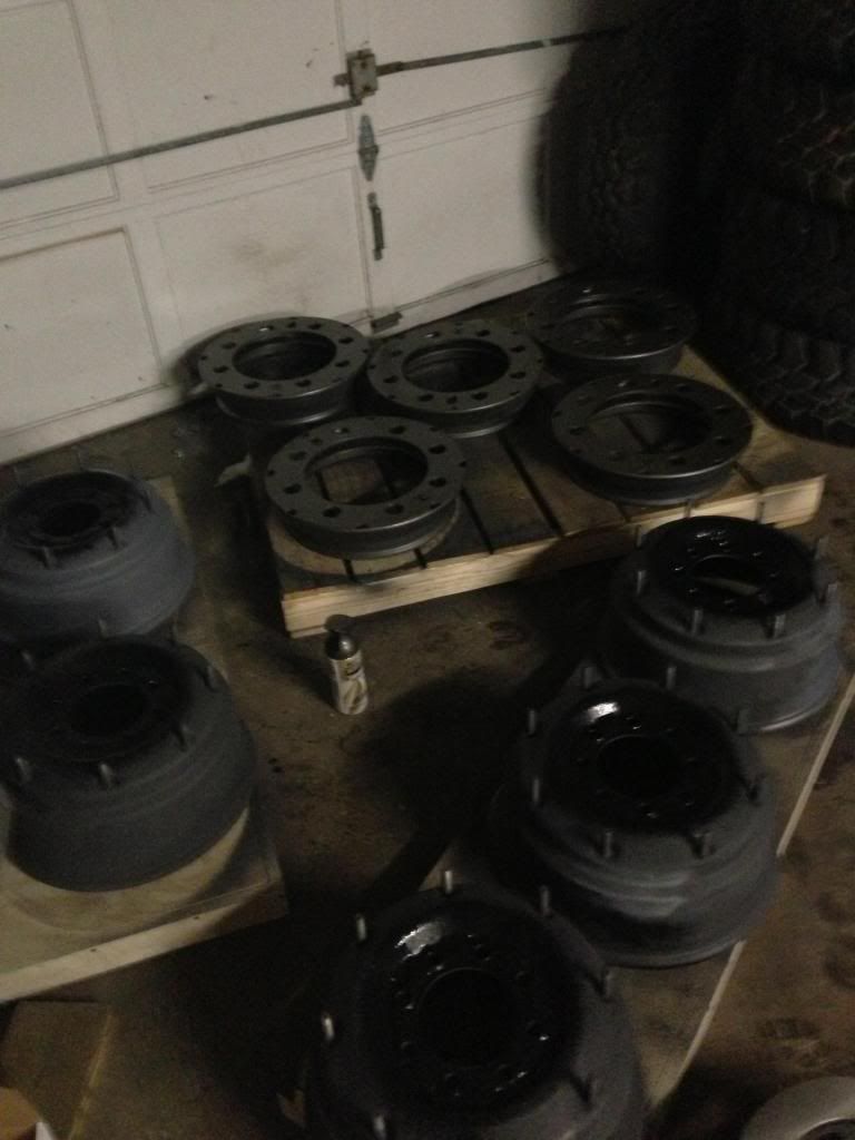

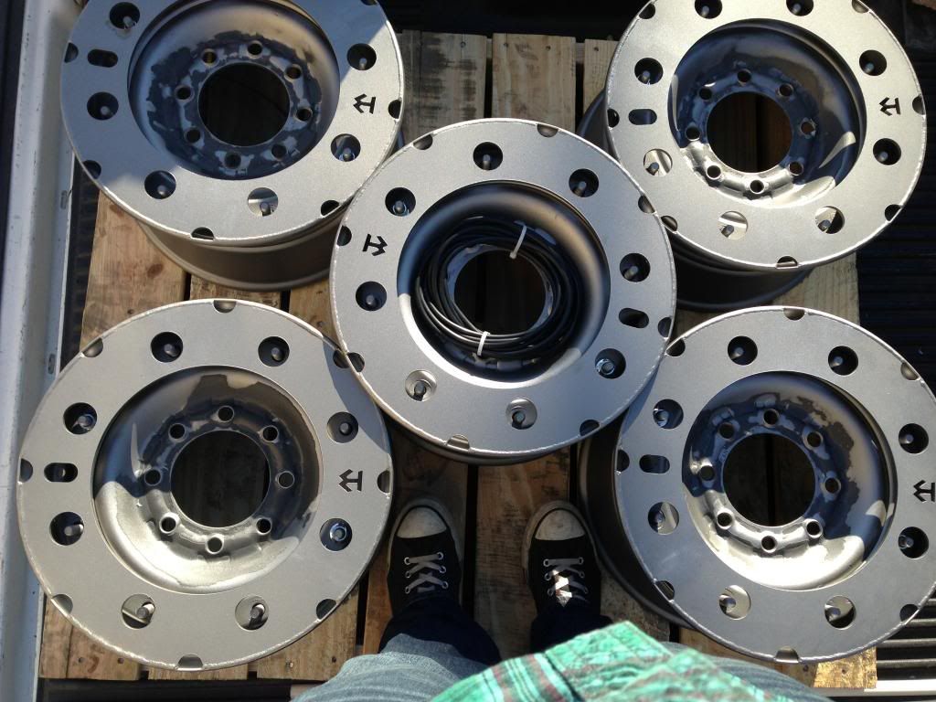

I had to drive 30 minutes to the nearest dock so I could grab wheels and tires from Treadworthyfab.com
I'm very happy so far with my purchase.
It's hard to tell but i seperated the wheels and painted the wheel mount and the inside of the large part with bed liner, then i painted the rock ring part with a hammered dark bronze, it look good. I'll post brighter pictures later

Wife and I took the spare wires off, still need to loom it.

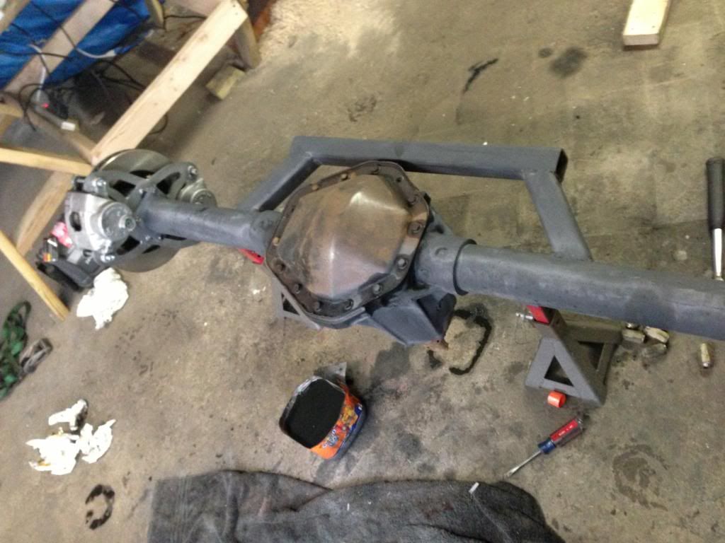

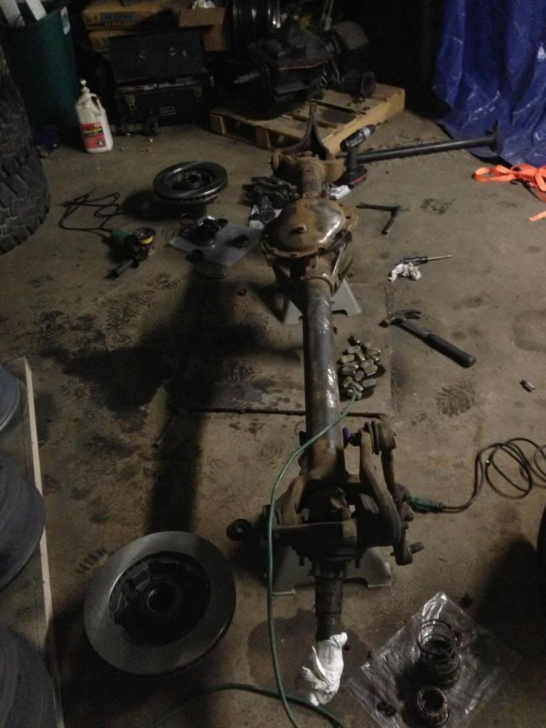

I have disassembled the rear axle, painted it and reassembled.
while I was at it, I finished welding the brackets on the inside for the parking brake. here is how it looks now.
Once I am ready to weld in the coil buckets, then i'll bed line it.

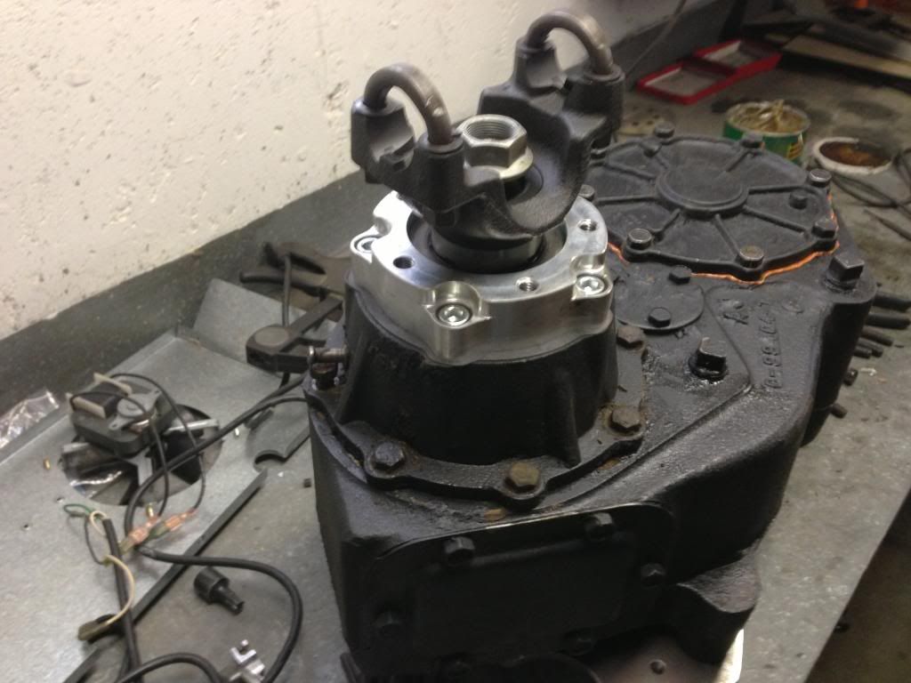

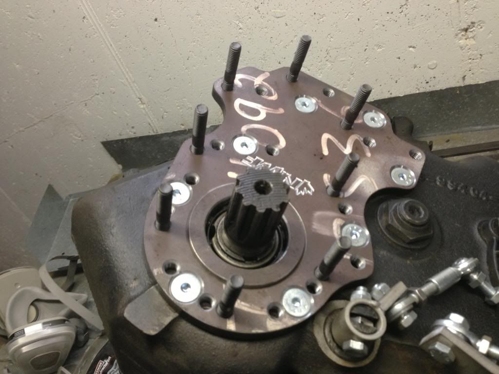

I also finally got the 1410 tcase rear yoke and the clocking ring int from northwestfab.com
They are installed.

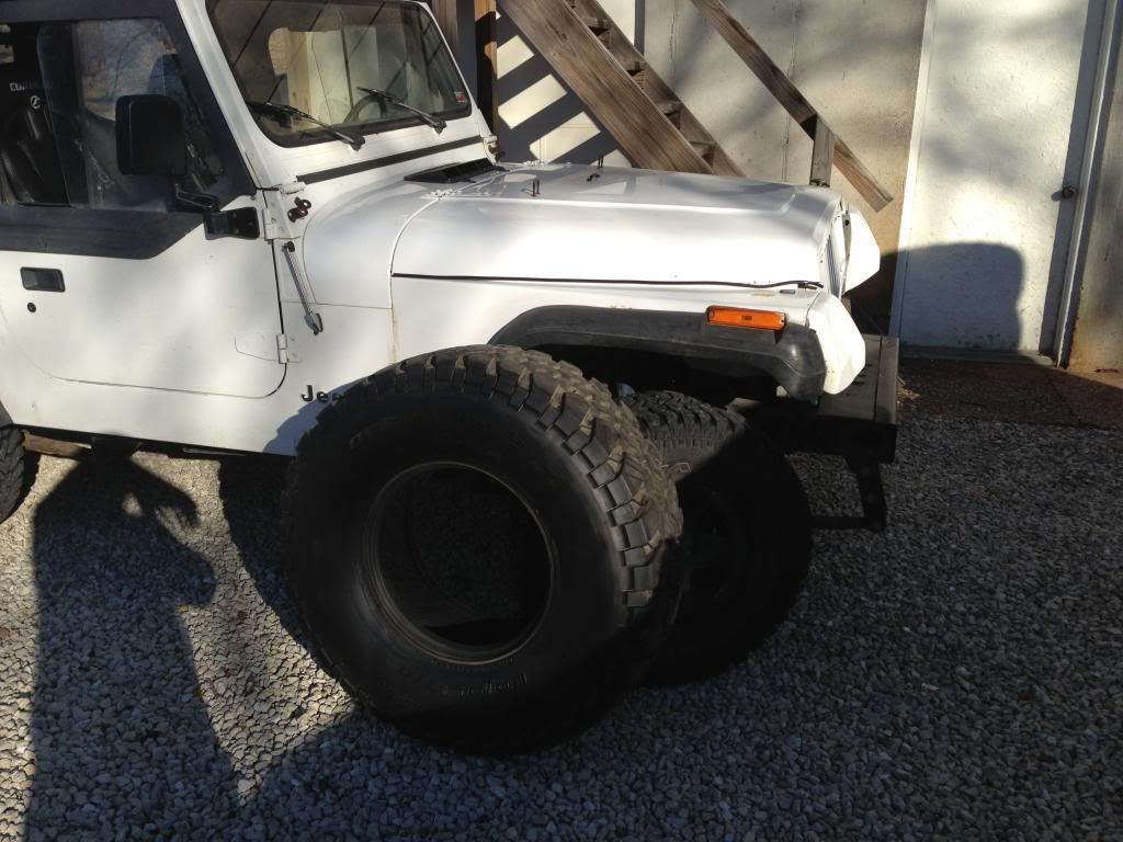

Grill off, all that jazz. Ready to lift

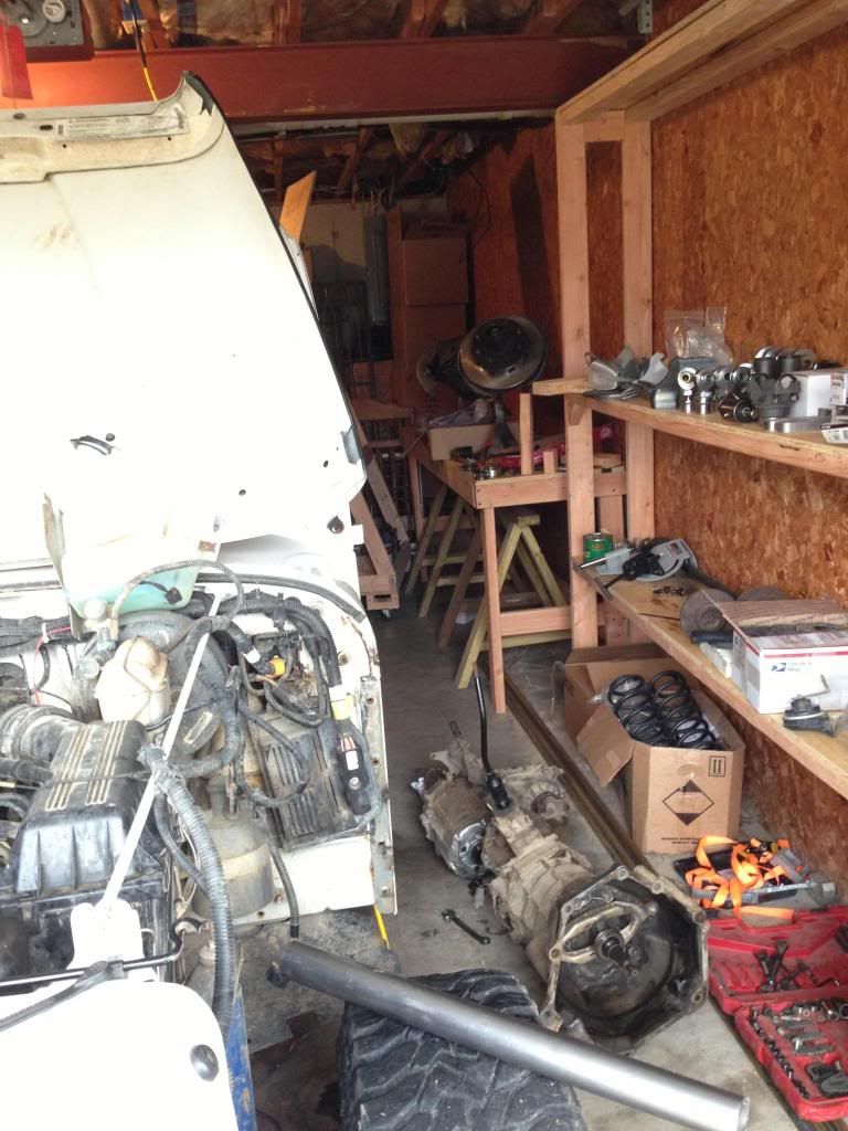

Engine out, all brackets cut, and working on cage ad body mount lifts. I broke a bolt off the drivers front body mount. The sleeve won't even move., rusted tight. Any ideas ?
