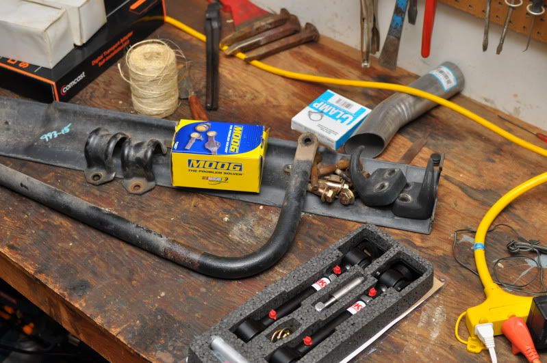

So the JKS Quick Disconnects are ordered and shipped from Quadratec. In preparation, I've removed everything from the front frame rails (bumper/lights, anti-sway bar with mounts) so I can strip the stock anti-sway bar and repaint it. I'm also going to strip and repaint the stock mounts and replace the bushings with OEM from Advance Auto. Going to strip the frame rails as much as I can in the front and repaint (rust). Going to replace the anti-sway bar mount hardware with grade 8.

The JKS disconnects should be here today. Next week, I'll be sand blasting the anti-sway bar and both mounts in preparation for enamel or heavy-duty paint so I don't have to do it again. I also picked up two new anti-sway bar bushings (p/n K7352) from Advance Auto. Might as well do it right since the 12 year old ones are all but torn up.

Got the JKS disconnects ... out with the old, in with the new!! Just have to strip and paint the sway bar, mounts, and front portion of the frame ... might as well since everything's off. It's been a WHOLE day now, plenty of time for everyone ever on the internet to see -- I'd really like some comments on the components I've got in the plan.

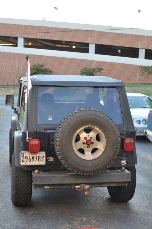

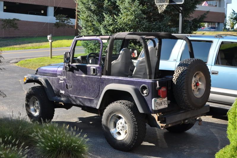

BESTOP TREKTOP NX

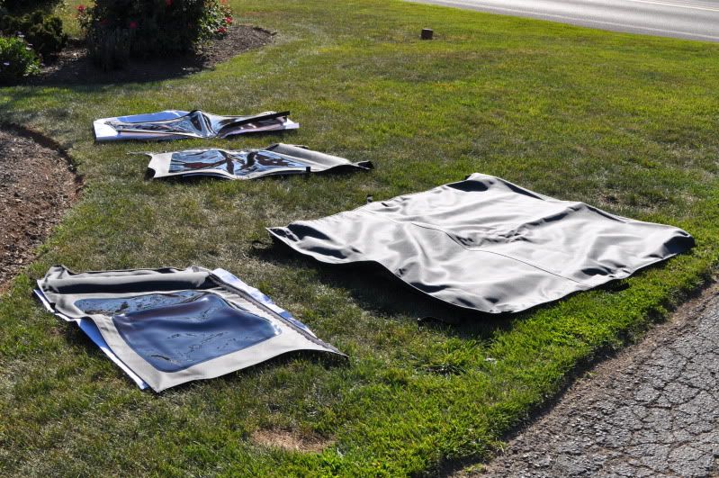

I already had all the padding off the rollbars for the past two years (since I've been running the hardtop or no top exclusively) so I washed them all up and got a can of fabric/vinyl spray in flat black. Didn't feel like doing the two small pieces that extend to the windshield ... so those are still a bit purple still for now.
Tinted windows laying out with the top to loosen up, per others' advice since the first installation is quite tight.

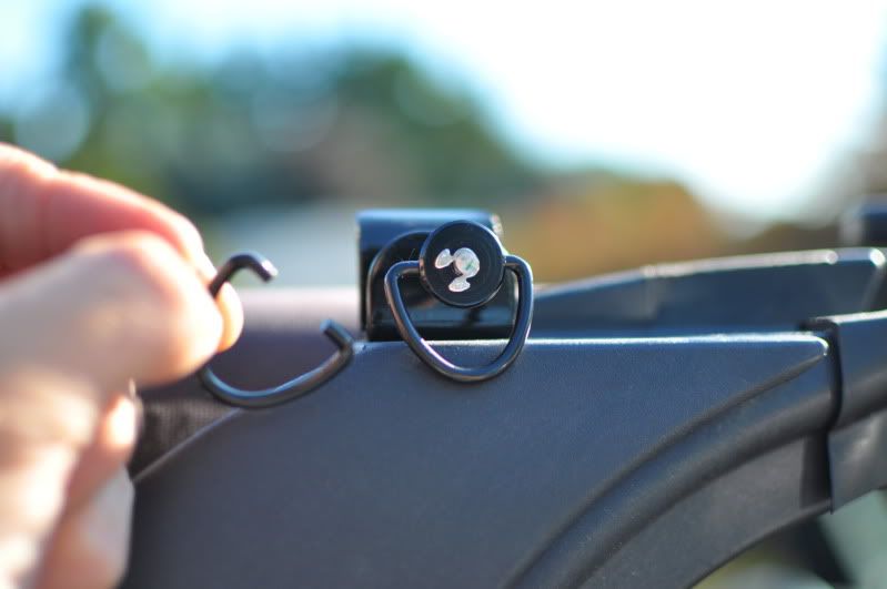

The D-ring for the sunrider fulcrum point has been known to fall off, which mine did during shipping/packaging. No biggie -- pair of pliers took care of that. Honestly, they're not really necessary so I won't be upset if they do fall off on the road.

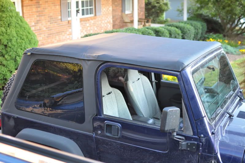

Tight fight! If you had the OEM softtop, this one's no more difficult to put on. Just takes a little extra time during the initial install to get the wrinkles pulled out and everything stretched.
Really like the top. It's every bit as quiet as my hardtop I literally just took off (bedlined with no carpet). Even though it's supposed to be nice all night and tomorrow, I'm leaving everything on tonight to let it acquaint itself.
Very happy with this one.
