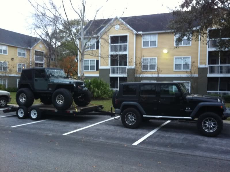

Thanks haha yeah I just sat back and laughed for a good 5 minutes after I pulled it out of the garage. I can say this.. I will be building a set of 60's for this TJ, when I don't know but it WILL happen. Lucky for me I will have my actual 37" running Toyos under it after our trip to MOAB Easter Jeep Safari!!! So for now I'm just gonna mall craw and do some mild FL wheeling haha nothing to jeopardize the "pressure limits" just yet.
And thanks guys for the thumbs up, seeing cool feedback makes me realize that Im not the only one reading this thing haha
Mentioned a few post back remember, these tires aren't my 'stick with tire' they just came on the rims I needed for the new Lug pattern. 37's will be whats ran in a few weeks. also cromo shafts are coming for sure. no question there. I don't want this to happen again on a trail..
Here's a comparison in size from 35" on the JK to a 42" on a TJ

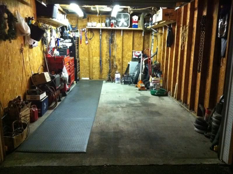

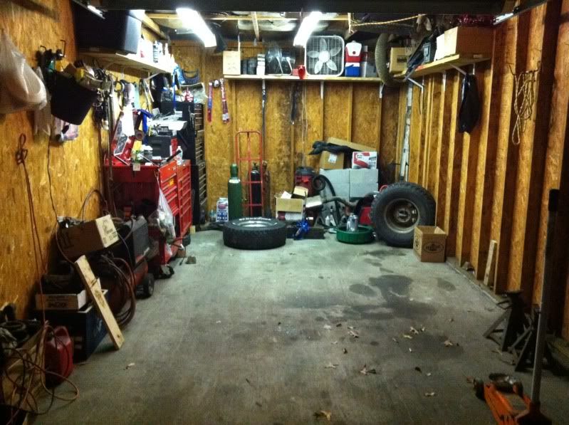

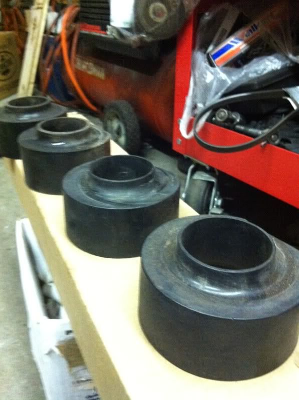

On another note. I ordered in another 1.5" X 40' cush pad for the counters.. Out with the old and in with the new.. So I split the mat with another worker and made good use of this in the now CLEAN garage. In cleaning the garage I rounded up a few old parts that have been taken off the jeep.. .. Any one need anything? haha I'm gonna CL most of it I guess...

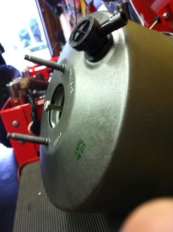

Let me first state this: I have worked in a shop for over 4 years. I’m no dummy when it comes to vehicles. But if I can’t get something to work for the life of me, I will take it somewhere who can.
With that said… Took the Jeep to the dealership Friday to get the brakes checked out. I had no pedal what so ever. All new brakes, everything. Lines, it was all redone. 4 months ago I put a booster and master on it. Well I took it to Jax Jeep Dodge to have it “diagnosed” I loaded it back up onto the trailer and dropped it off to them. 45min later the guy calls me and said “its your booster and master that are bad” Now I know they didn’t bring it into the shop and put it on a lift and check EVERYTHING out on it. In 45min .. I said “I just replaced that” needless to say I got a lil run around so I said to fix the brakes and get it done, I want them to work if that’s what it takes. 6 days later I get the phone call..” parts are in and the tech is bleeding it now should be done in a few.” (3:00pm).. I showed up at 6:00PM to pick it up, and he was still bleeding it!!!! Wtf.. If you bleed brakes in 30min and you STILL have NO pedal.. Something else is wrong!!!!! This means a FALSE diagnostic to begin with! My booster and master were fine!.... anyways the brake pedal STILL goes to the floor, stops, but all the way at the floor. Sketch I know. They charged me 1000$ for parts and labor that I didn’t even need. And I’m in the same place I was a week ago.. NO BRAKES!! I'm BROKE i dont' have 1000 to throw away to not even fix it. they wanted to keep it longer and keep charging me and I laughed.. put it back on the trailer. I went to talk to the supervisor but it was so late no1 was there. Needless to say I’m fighting for my 1000$ back.. Or ATLEAST the 650$ I’m out in just parts I didn’t need… I take it to the pros.. and I get this… I know its aftermarket.. but they “know it all”…
Needless to say I know what’s wrong. Not that I’m looking into things. I bought a BIGGER master cylinder from a 00 Dodge 3500 for the bigger cylinder bore to compensate for the larger calipers. I should have thought about this before but my mind had been racing at 10000000 miles an hr with everything else. I got so fed up with not having brakes I did the unthinkable and sent it to the dealer.
I’m sure many of you are laughing calling me a moron, and will probably stop reading this build after this one.. but things happen.
So root for me in my fight of the Service Manager Tomorrow and Sat.. cause I’m gonna need it.

I have fought the good fight, If there is 1 thing I have learned from my father, its to fight for what is right. After countless phone calls and the run around I finally spoke to the right higher up and got some sort of compensation. They told me to eat the labor and i can get my money back for parts.. but because there used ans restocking fee yada yada they will give me 520$ back when I give them their parts. I am NOT pleased with this one bit. not at all. Unfortunately there is only so much i can do as 1 person. So i went ahead and talked to a friend of mine at the better business bureau.. This should spark a flame somewhere. but that is where I'm at on that topic
Fixed a few problems as stated previously..
Ordered shorter shocks for the rear Rancho 9000XL's adjustable
Also a rancho steering dampener
Exhaust is complete and ran, also bent away from front drive shaft
Bump stops are in
Vent hoses ran
New Rollbar net top
adjusted pinion angle (Too far forward tho.. have to extend all 4 rear arms to recenter axle)
Brakes are FIXED by MYSELF and work GREAT!!
There are things i need to still address but I'm trying to put miles on it and break everything in so i can get a fell for the ride. Took it 40 miles on the highway today. Steers quite well with the 42's, no pulls or drags. rubs in rear on compression, 3000RPM at 70ish MPH.. not too bad.
I swapped MC's and a new booster that I purchased through work and the brakes are great, everything worked according to plan. All that was needed was the pushrod in the Booster to be extended about an inch and the proportioning valve bracken to be ground down to fit the bigger bore MC and everything else was just bolt up and bleed
