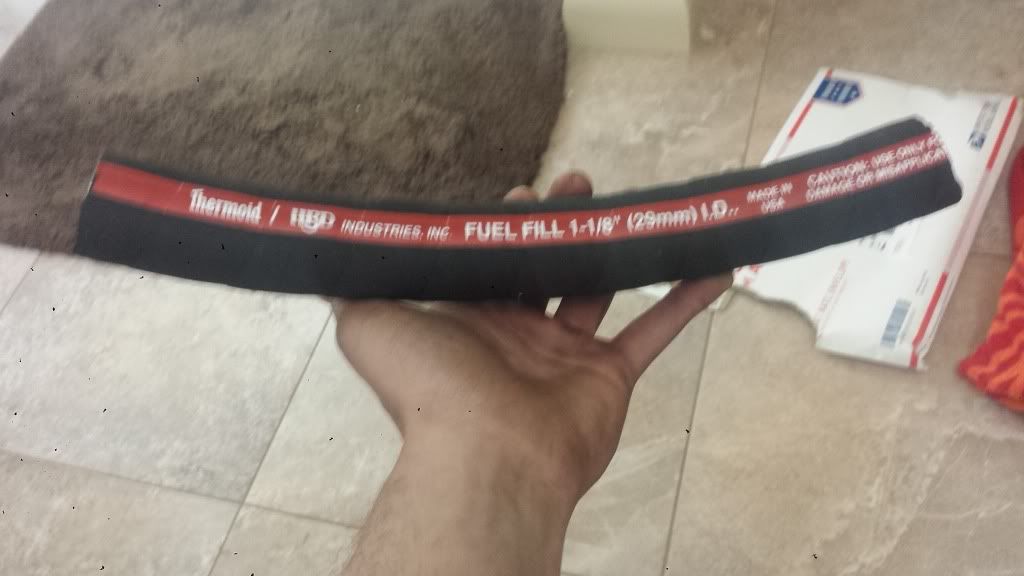

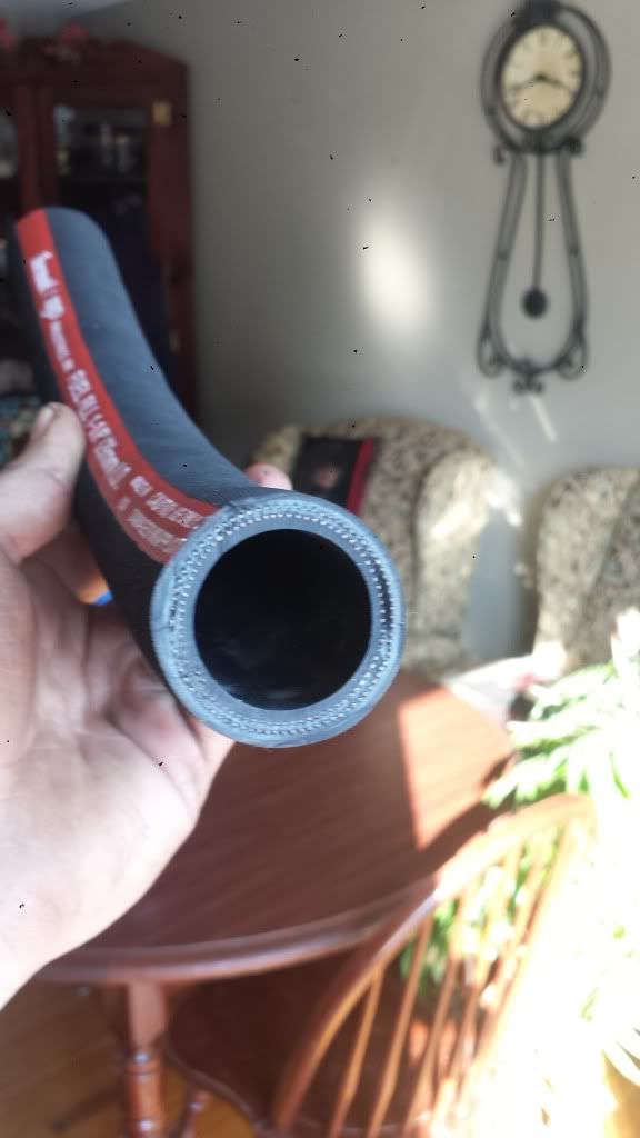

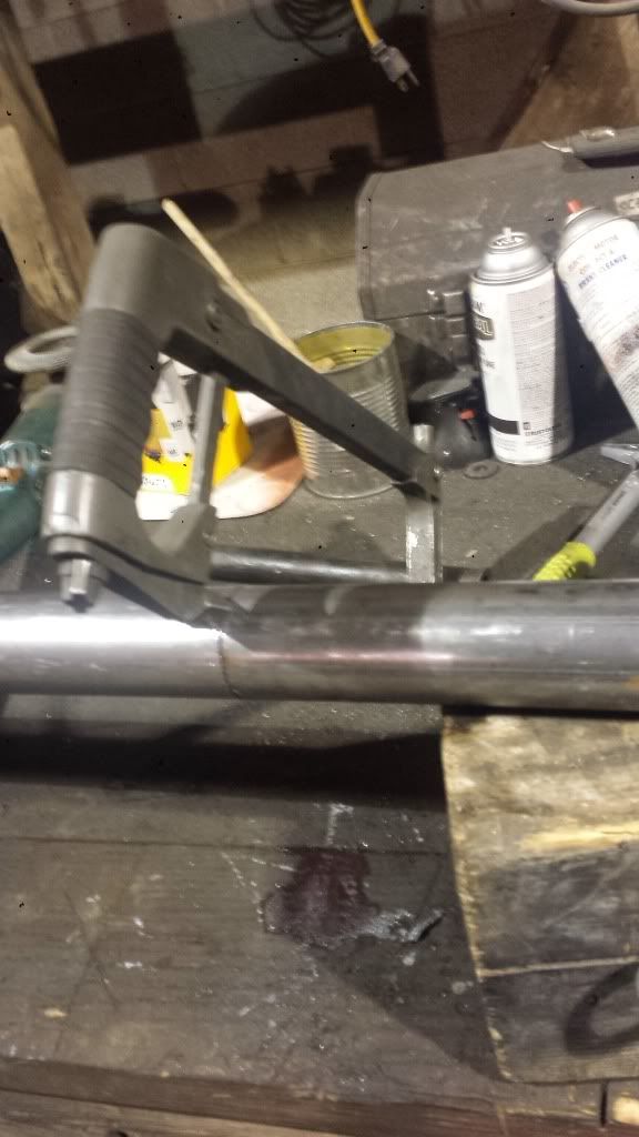

Welp we did some measuring and math last night. I'm aiming for an 8 " stretch it seems, but with the adjustability of the arms joints I'll be able to go anywhere from 7-9". This will be key once everything's together to get the wheel centered perfectly in the wheel well. Insert crappy pic of cutting dom with a hack saw
Also got home this morning to some filler neck hose, brands name is thermoid, and the cheapest place, by far, that I could find it was ebay.

man i would have raped the dom with a grinder lol

Hacksaw ?! You guys are sadists !

Haha I got out the cutting wheel pretty quickly after that.

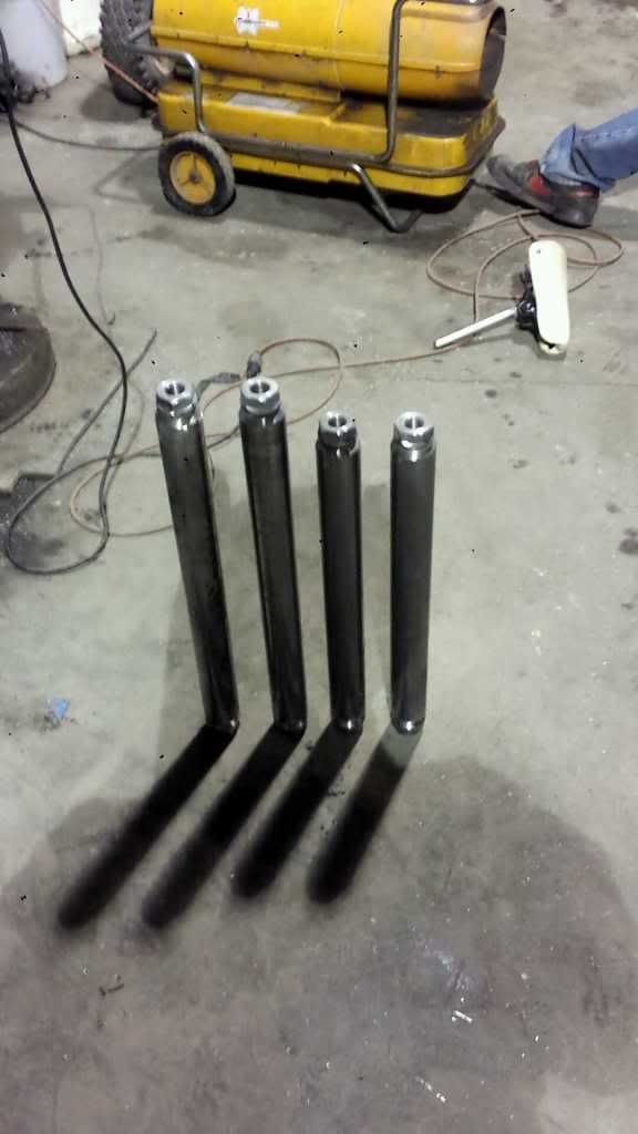

Then I got my arms assembled, the ruff stuff adapters were awesome, perfect fit with some nice rubber mallet action. Waiting till after the mock up Thursday to weld them, I kind of like the shiny look? Might not paint them black, maybe silver?
