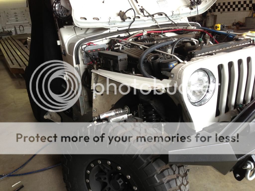

Since I added the OBA I thought nothing better than air horns mounted under the hood These mothers are LOUD

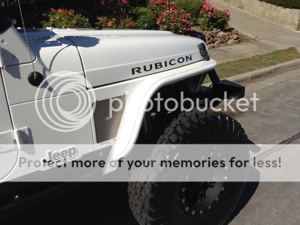

Made the first cut on installing new Gen-Right Alum front fenders. I looked at a lot of new front fenders but being an old guy I still like the looks of the more traditional flat fender look.
When I started I ordered the steel fenders because of the price, but once I received them and held one in my hand I went holly s$$t these are heaving so back they went. I reordered the Alum ones, after thinking it would get even heaver if I do the rears.

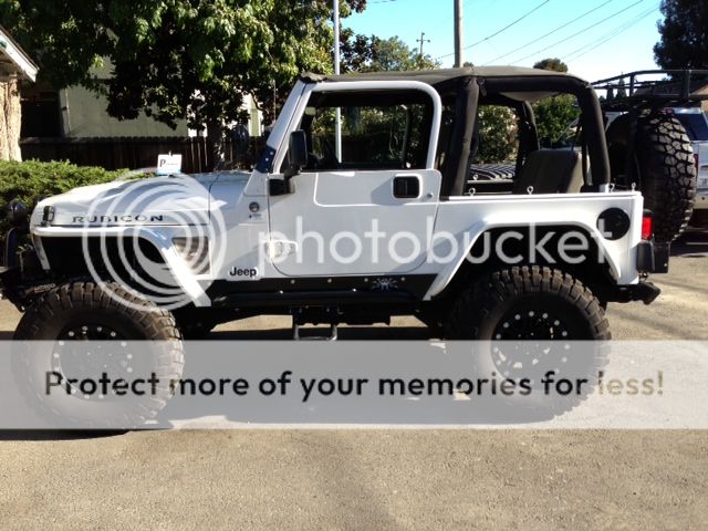

Got the tubes installed and painted, and got the half doors lined up and mounted. I am very happy the way things are coming together. It's beginning to look more like Idaho's TJ

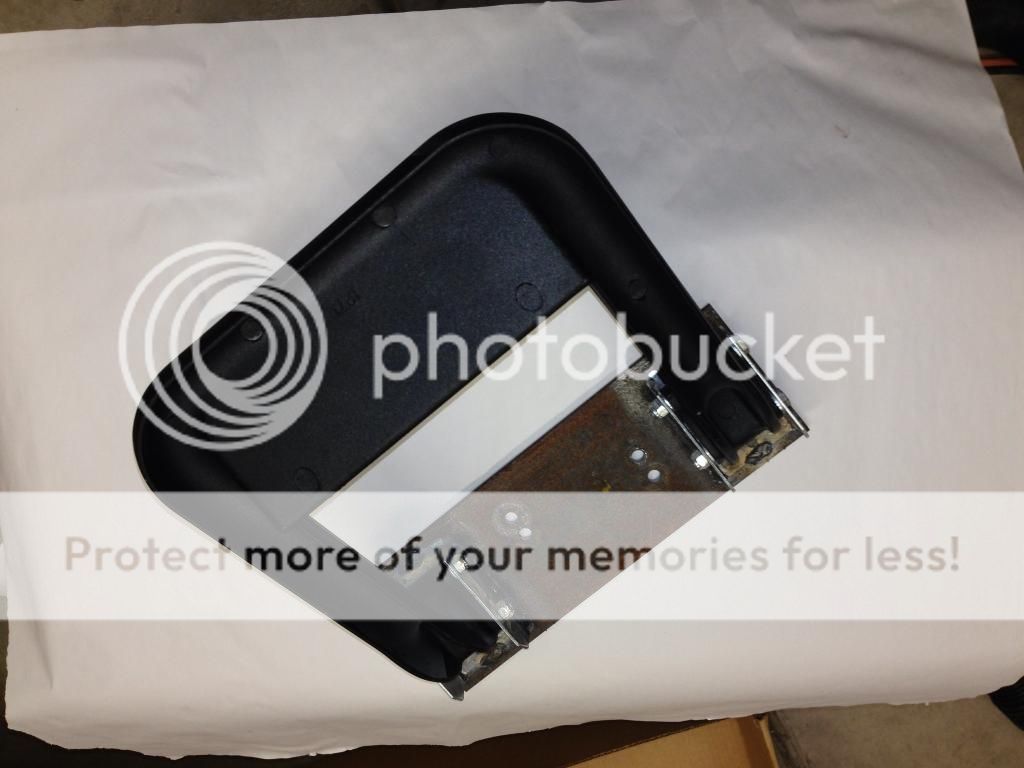

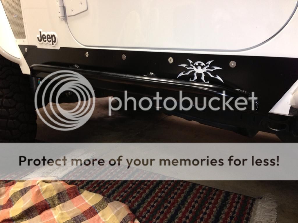

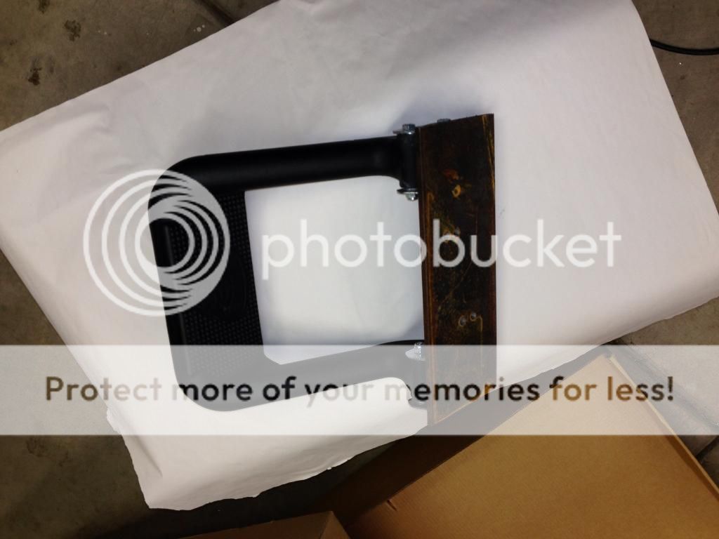

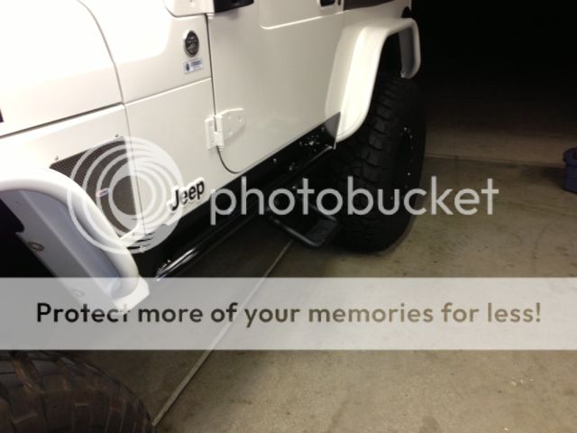

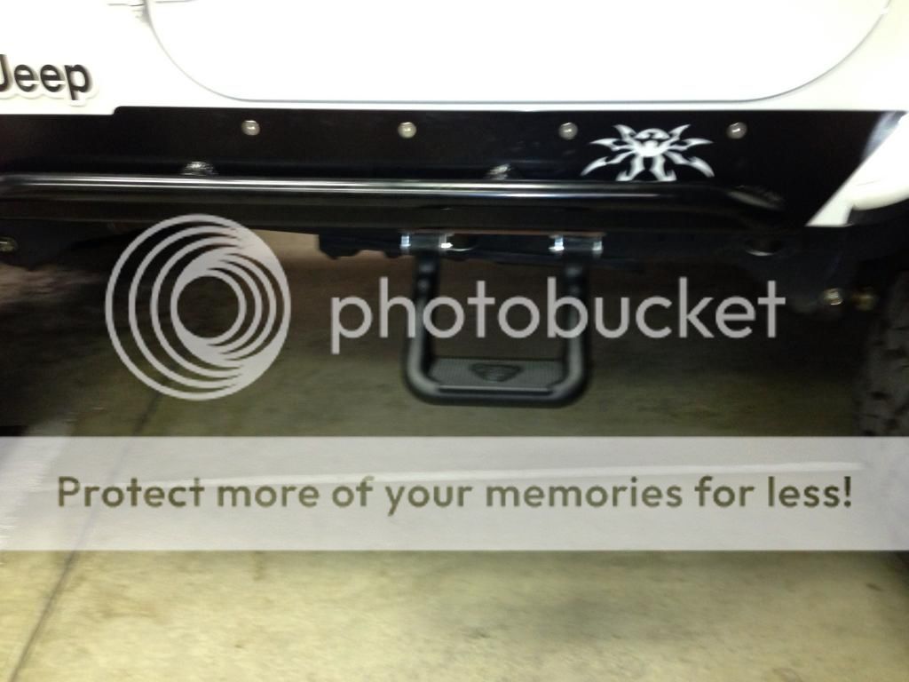

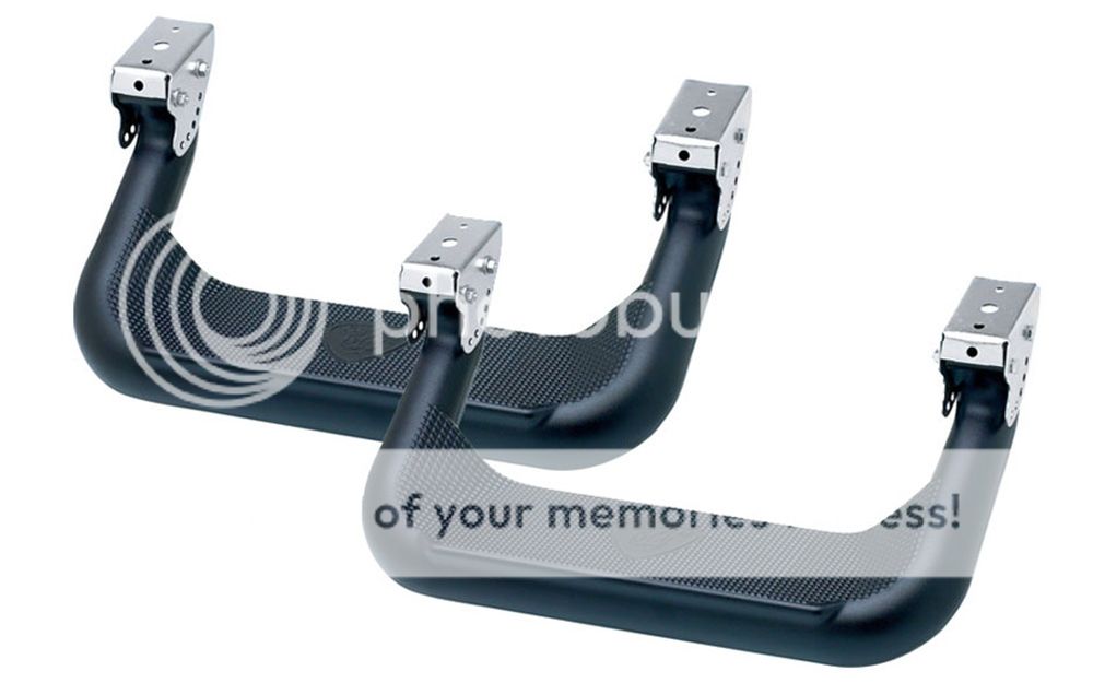

I wanted to add a step to each side, but I also wanted it easily removable. I searched and searched the web and could not find what I was looking for so I bought some Carr steps and welded them to some steel plates. Then I drilled and tapped the underside of my Rock Sliders, so now I just remove two 3/8" bolts and I am ready for the trail.
