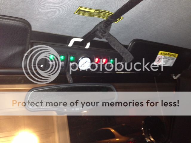

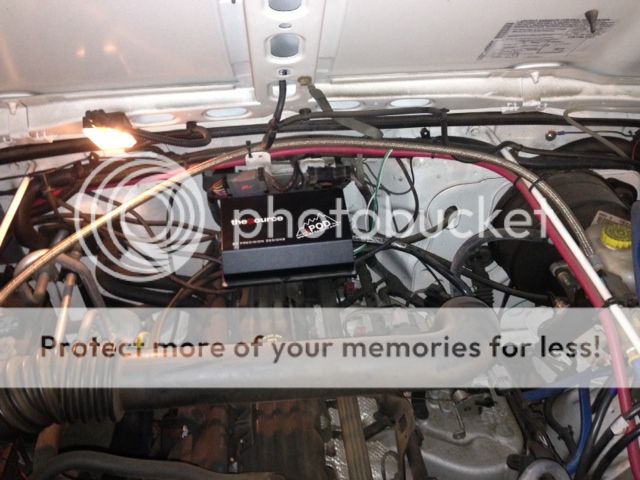

Ordered the S-POD, I know its pricey but it is a cool system
The install was very simple and Now a place to hook up everything w/o cutting the dash for switches

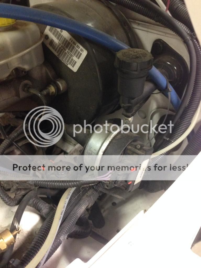

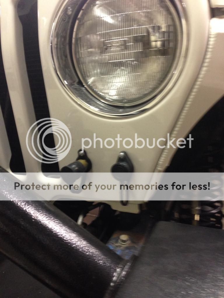

Relocated the winch control to under the hood, but I had to relocate the cruse control first. I moved it to the open spot below the master cylinder.
Had to make a bracket to hold the controller

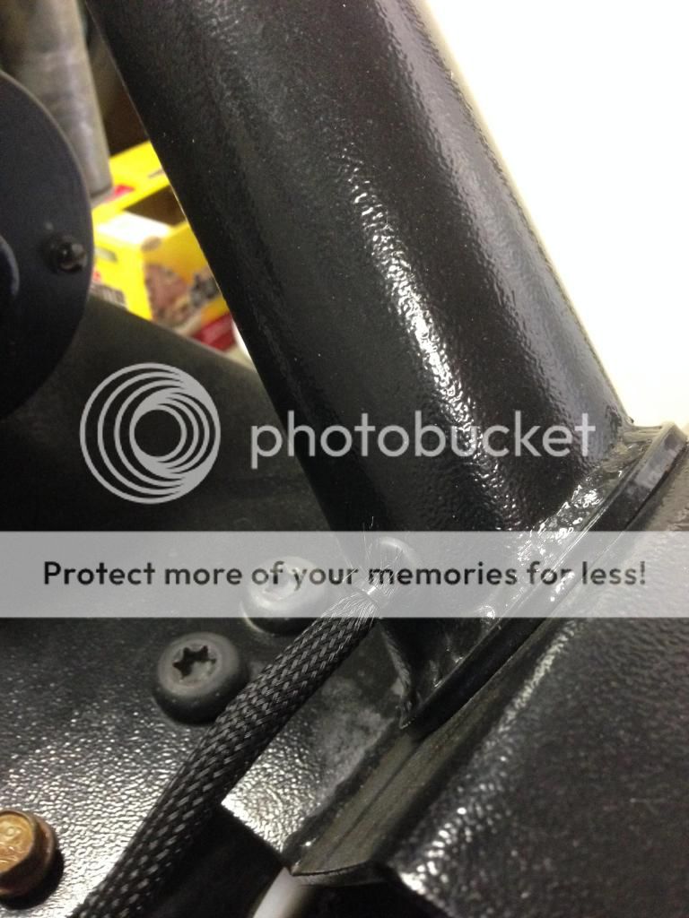

Also I wanted the wires from the front lights to be hidden so I drilled holes in the tube and ran the wires down and out at the base of the tube.

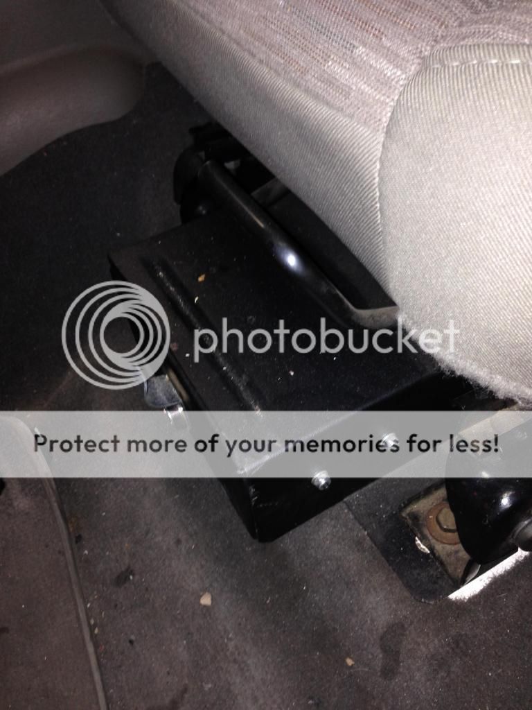

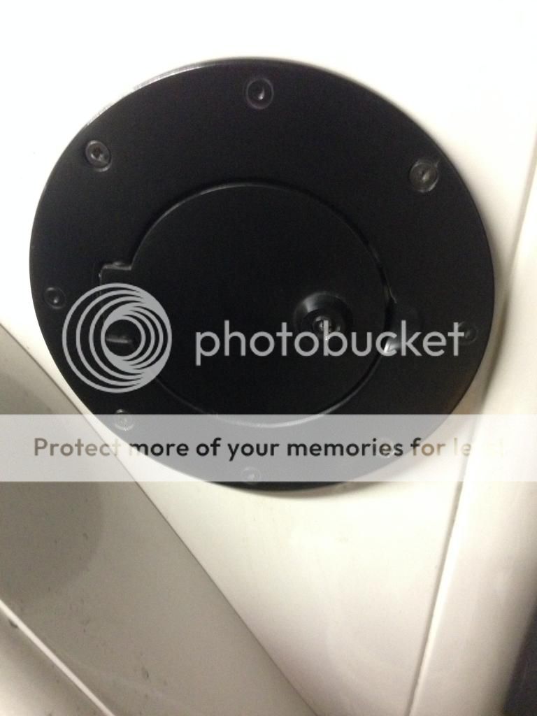

Added this for security
I had a problem with the piece that covers the bolt making it hard to remove, I had to drill a new hole in the metal to get it to work properly.
It now works great, other than a bit small, I think the ones that fit the non-flip seats have a bit more room in them.

Relocated the winch control, had to make a bracket from a wood framing bracket. Just a bend here and there and some new longer cables. I first went to a battery shop to have them made, and they guy told it would be cheaper to buy 6' long cables. Then cut them down to size and add new ends myself so that's what I did no big deal

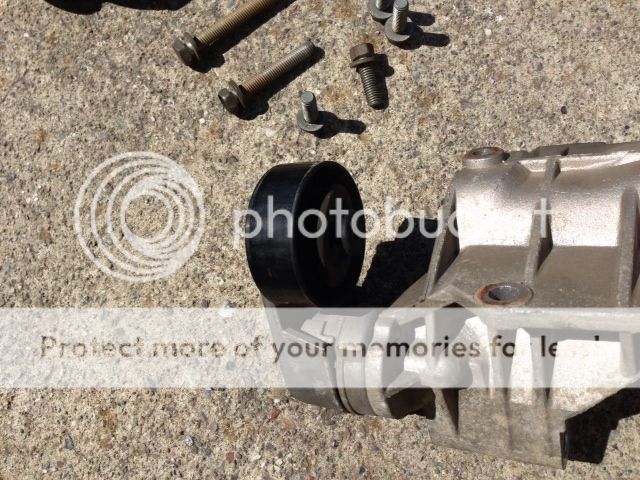

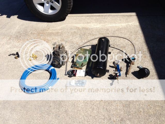

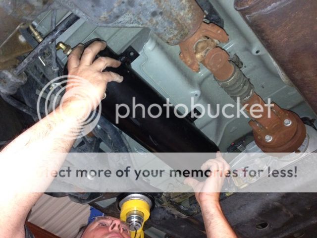

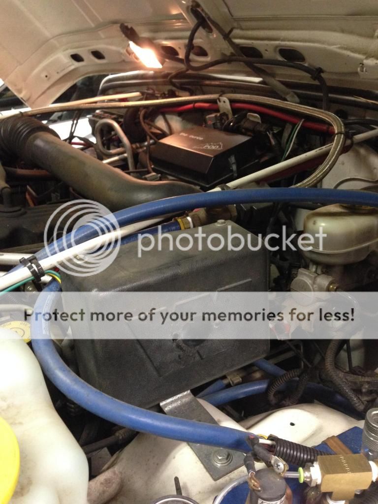

Next was the OBA System. I robed it from my YJ. I had to order a new bracket from Kilby to mount the York, you have to remove the belt tensioner when installing the new bracket along with the Alt. The Alt gets inverted and mounted to the bottom of the new bracket and also a new serp. belt.

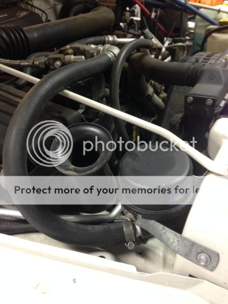

Ran a hose to a filter just in front of the air intake on the main box and made a sheet metal bracket to hold it in place.
And installed a quick disco one in the front and one in the rear. The one to the left is the air the one on the right is the new winch remote connection
Mounting the air tank
