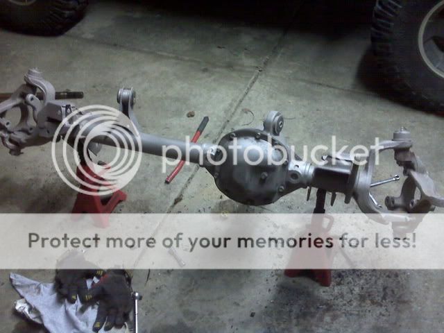

Heres the HP D30 after the sandblasting....will look even better once its geared, locked and painted

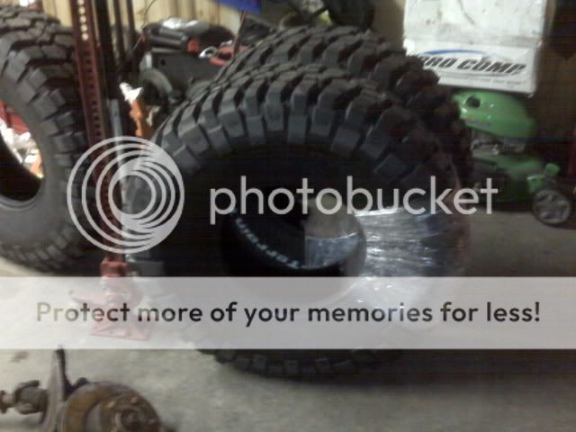

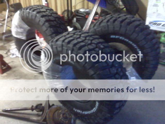

got 3 of my 35" km2s yesterday, the 4th is coming today
sorry for the crappy cell pics
