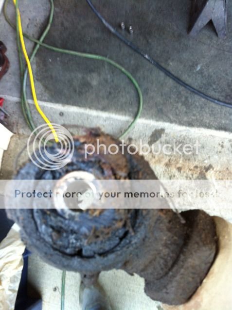

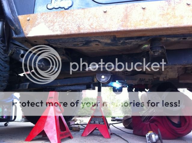

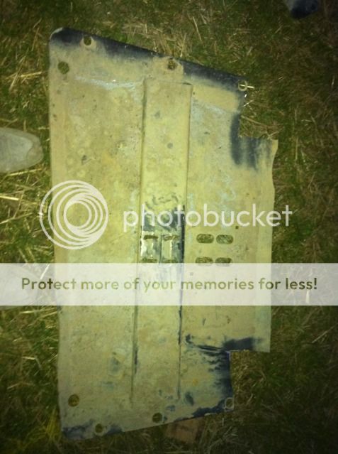

Better late than never - here are last weekends updates and some pics
The reason I am replacing my front suspension
with this
I bought a used set of Clayton radius arms off of the dude doing the welding - has rebuilt jjs and bushings - ya I know they aren't the sexy trendy mid arms, but just like my leaves - they are simple and effective (and the right price). Had a buddy in our club (brown) cut some brackets for me. Still need to add a gusset to each frame bracket before it is wheelable. I also have jjs for the axle housing I need to install yet. I really wish I had a video of the housing bushings, the pass side we used a ball joint press on and it popped out within like 3 cranks, the dr side I literally pulled out with my hand...
had to notch my skid to fit the brackets - since it is aluminum I need to have someone tig a brace across it to reinforce it before I wheel.
It drove so freakin great on the way home. It will be even better when I put the housing jjs in and get some much needed steering upgrades. Next up is extending the front shock towers and getting some 12" bilsteins on all 4 corners.

Those arms look good man! I bet it rides awesome now. I'm curious, are you running the factory transfer case shift linkages with that ultra high clearance skid? Do they still work as they should?
Edit: oh yeah, and are you still rockin' the factory exhaust?
kyle_craig is offline
post #582 of 660 Old 04-12-2012, 07:36 AM Thread Starter
gribbles
Location: Indianapolis
Posts: 1,678
thanks man, ya its a huge difference - still a bunch of work to do tho.
I am still running the factory linkage - it works, could be better - the novak is on my short list.
As far as exhaust goes, I had a different muffler put on a few years ago cus I wanted a better sound - I just hacked off the pipe where it curves up to clear the axle at stock location. Kinda a high clearance turn down, lol. Plan was to put a turn down right behind the muffler but this actually worked out pretty well.
