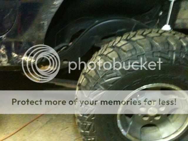

major progress over the past 2 days...doesn't seem like a lot to me, yet, but I won't be truly excited until its done. Tomorrow is a big day; gotta bleed the brakes, which I hate doing, pick up the steel for my rockers and make them, fit and cut my savvy blanks, do a **** ton more grinding and cutting, get my drive shaft lengthened, hammer in some new u joints in my super sexy front chromos and install those, and finally paint if there is time....there really isn't enough hours in the day. I've already accepted I won't be wheeling friday, will probably be finishing all of this up and getting to the badlands friday evening to camp and relax around the fire before hitting MI saturday. Sorry for the run on sentence but I am exhausted
some pics
love the look without a gas tank
just realized these are really ****ty pics, I'll try and remember the camera tomorrow.
those are just some ****ty rancho 5000s - I didn't feel like dropping much money on shocks yet - we'll see how long these last. As far as travel goes I have right at 6" of up and 6" of down travel - We'll see if I need all of it, but its there. The clearances where REALLY tight for the lower shock mounts and that is about the only way we could mount them without either rubbing on the caliper or blocking the banjo bolt, but It'll work.
I owe Robert a HUGE thanks for coming over tonight to do the welding for me - Robert, you are the man.
