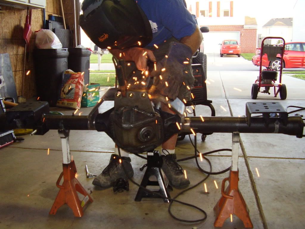

Sounds like some good plans here, but why an 8.8 for only 31's or 33's? Seems like overkill to me. Chrysler 8.25 29 spline would be plenty strong and it's an easy direct swap.
Why not? I need to do something with the rear axle with the whine I'm getting, a swap makes since, especially since I've got the 27 spline 8.25. The best options are 29 spline 8.25, Dana 44, and 8.8. The 8.25 is the most common bolt in, but the 8.8 is just as available, stronger, and already has disc brakes(big plus). Welding new brackets on is not a big deal for me, I have access to plenty of welders, axle swaps are not new to me.
I understand. Honestly, I wish I swapped my 8.8 into my XJ instead of my 8.25. Nothing wrong with the 8.25, I've wheeled it right hard with it being welded on 35's. I'd just like to have that added security of extra strength. It was cheaper for me at the time to swap the 8.25 than get brackets for the 8.8.
