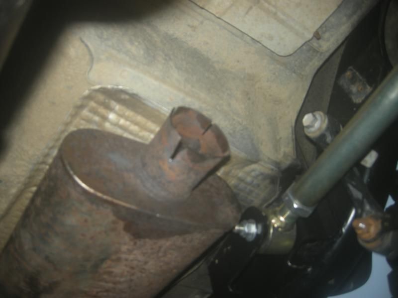

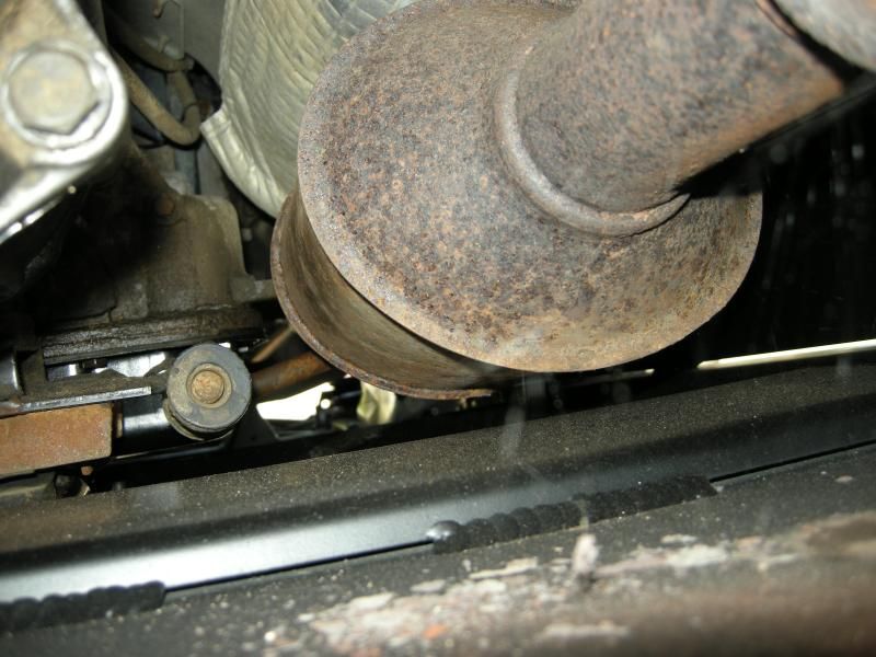

Here's a picture of what I'm working with.
It's probably no more than an inch and a half between the cat and skid. I'm going to try and bend the hanger first, but I'm not sure it's going to get me what I want...

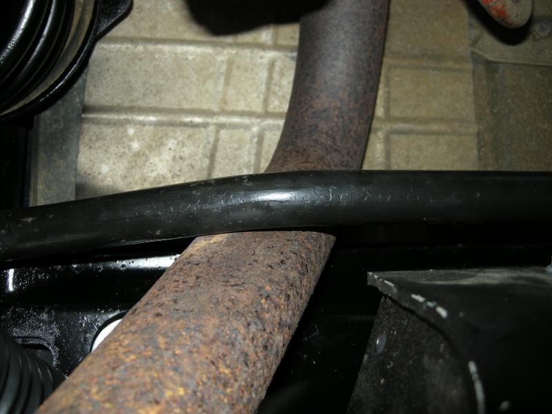

Oh yea, my other issue.

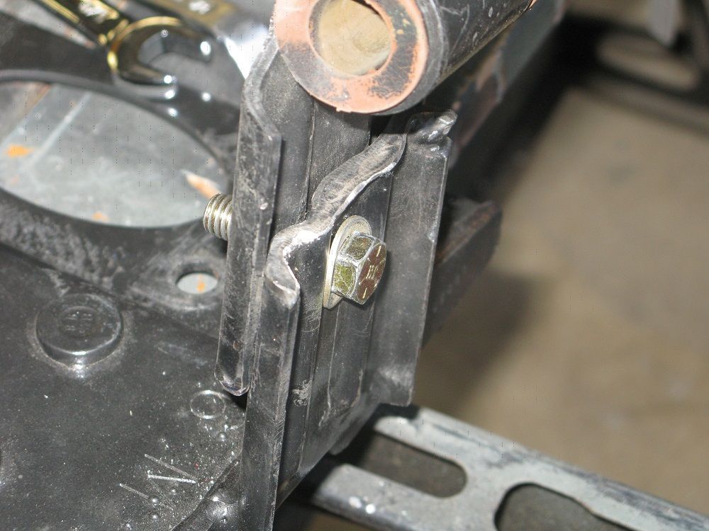

Alright. Here is my temp fix for the exhaust. All I need to do is fashion a turn down and adjust the cat hanger so the muffler sits alittle lower, and the exhaust will be done until I can replace it completely.

Got the custom turn down made up and bolted up.
We'll see how long this lasts. It's noticeably louder, almost to the point of being annoying. But that has a lot to do with the Banks muffler I currently run.
