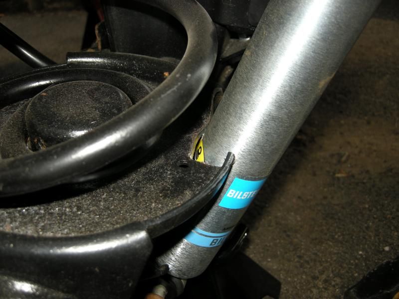

Kind of hard to see , but the lower spring perch has been clearanced in this picture. I have over 10k miles on the Jeep since this mod with no issues .
Nice. Once it cools down a bit more I'm going to head out and got to work on the perches. Hopefully I can get everything to clear...

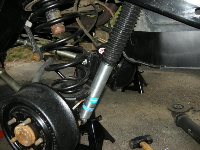

Have you test flexed the axle to see if that will work?

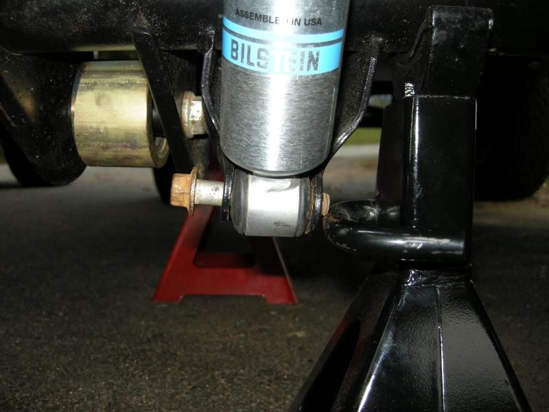

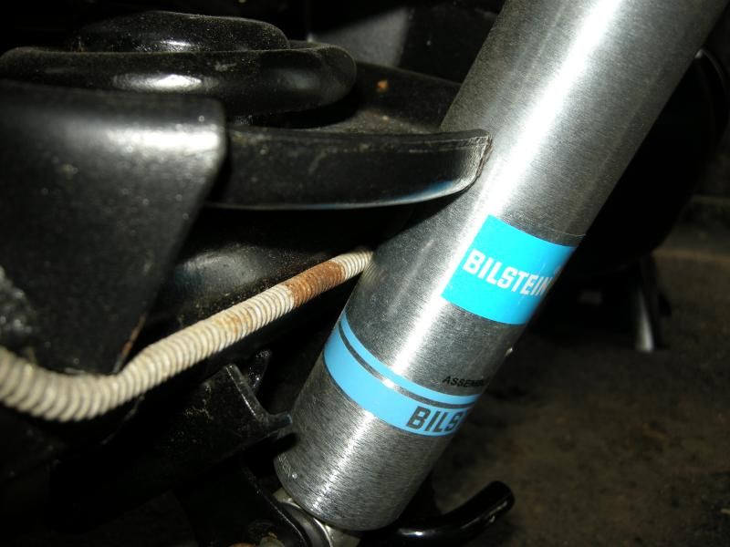

Not yet. I hope it works though. It's hard to see in the 3rd picture, but the shock is touching the hard line and the hard line is back as far it will go against the axle tube. So if I need more clearance I'll most likely have to reroute the hard line.
