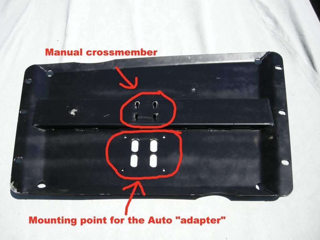

Messed with the skid some more, and the only way it's fitting is if I use the forward set of holes. So, I'm going to go ahead and send an email to UCF with some pictures and see what they think.
Build Thread
AndyE is offline
post #500 of 732 Old 06-20-2013, 07:07 PM Thread Starter
AndyE
Location: Groton
Posts: 631
Alright, I'm a dumba**. Got a reply from UCF on my "issue". I need to transfer the adapter from my old skid to the forward holes on the new skid. Honestly I didn't realize there was an adapter on the old skid due to all the gunk. So tomorrow I'll knock that out. God I feel stupid.

Is this said adapter specific to the automatics? I have a manual and there is no adapter.
Bob's boring build:
X2 I have no idea what adapter you speak of

I'll get some pics tomorrow...er, today. But the best I can piece together is at least in the early TJs the auto is a couple inches shorter than the manual. So using the new skid for reference:
The auto uses a removable "adapter" that mounts forward of the crossmember that the manual mounts to to make up for the difference in length. Kind of ingenious since you only have to make one skid.
Build Thread

Posts: 1,150
The auto uses a removable "adapter" that mounts forward of the crossmember that the manual mounts to to make up for the difference in length. Kind of ingenious since you only have to make one skid. I think that makes sense.
I always wondered why there was a second set of unused holes in my skid.
I didn't even notice the second set of holes in the stock skid, and I thought the second set of holes on the UCF skid was for a low pro mount or something.

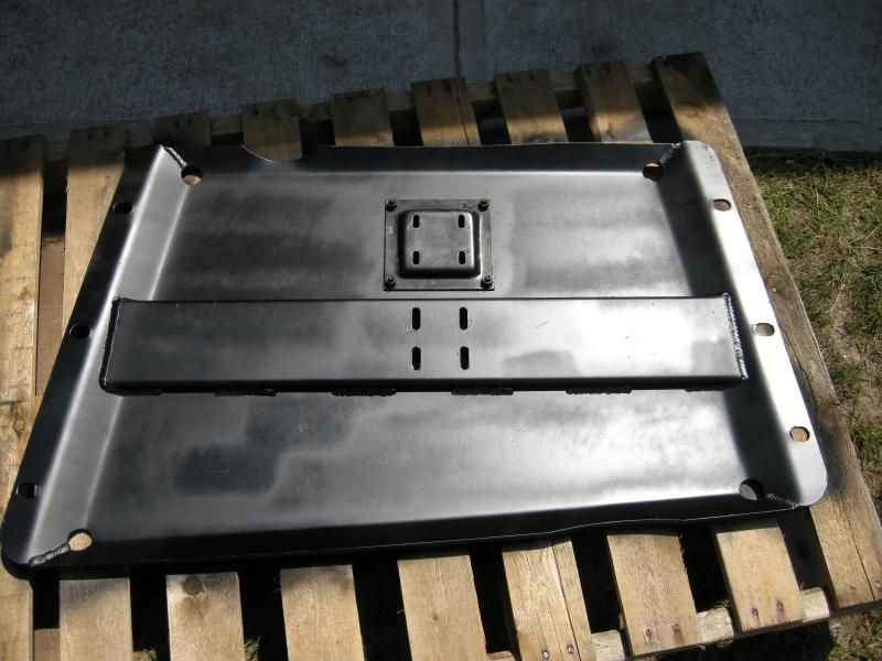

Alright, as promised the pictures of the "Adapter".
Here we see see it(barely) at home on the stock skid.
Here we see it exposed.
Removed and de-greased.
At it's new home.
And here we see the skid installed. This one made me smile, the fat girl got skinny!
