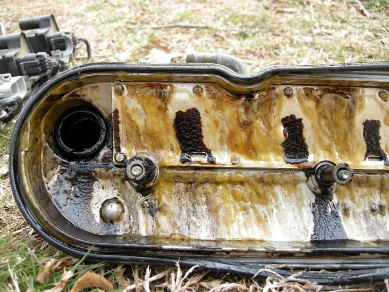

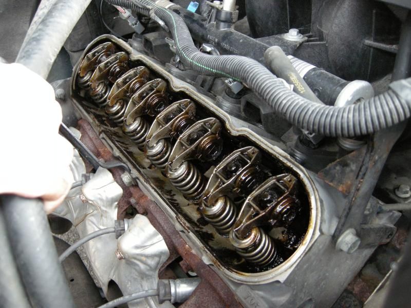

Not Jeep tech, but I'll post as it's good automotive tech.
This is what your valve covers will look like if you have a cracked head.
Still need to check the passenger side, but it looks like its time to hit up ebay for some remands.
Build Thread

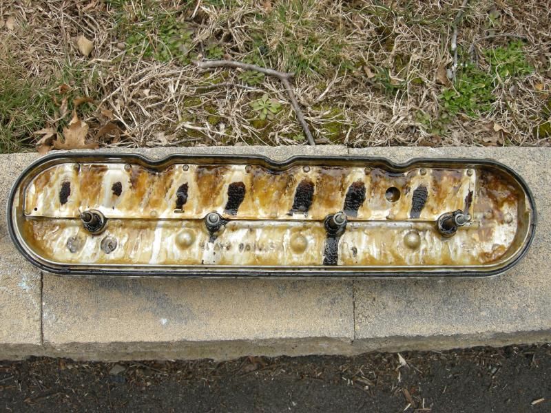

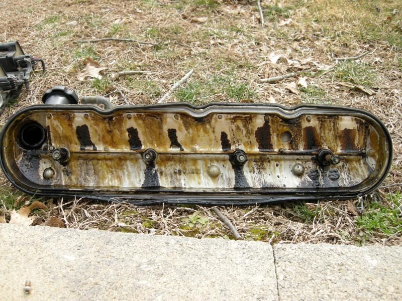

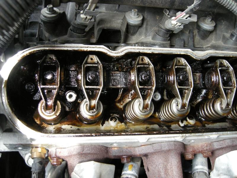

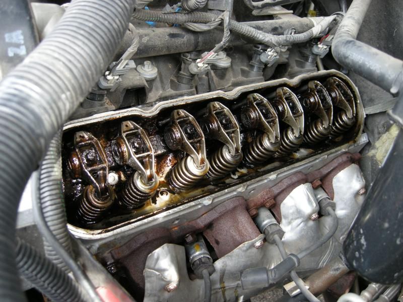

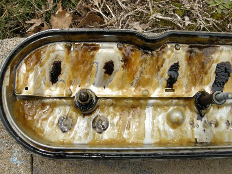

post #177 of 732 Old 03-31-2013, 01:08 PM Thread Starter

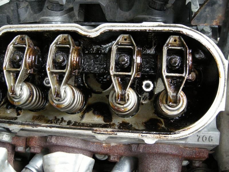

AndyE
Location: Groton
Posts: 631
Here's a few more
Build Thread

Haha, I'm so familiar with that site it's sickening, keep an open mind though, all it means is that somehow coolant is getting into the oil. Until you pull the heads and have them checked for cracks you really don't know much. Your TSB certainly is pointing you in that direction, but it COULD be something cheaper and more simple.
gst95dsm is offline
post #179 of 732 Old 03-31-2013, 03:16 PM
gst95dsm
Chop, Wheel and Rebuild..
gst95dsm's Avatar
Location: Fresno CA
Posts: 4,366
Drain your oil though and throw some cheap fresh stuff in there for the time being..... you don't want all that coolant mixed oil sitting in the crankcase while you sort it out.
I did some more reading and found where the heads like to crack, so after dinner I'll head back out and take a look in the suspect places.
Good idea. Tomorrow I'll have to run out and get some.
